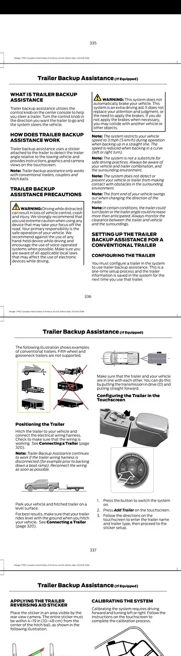

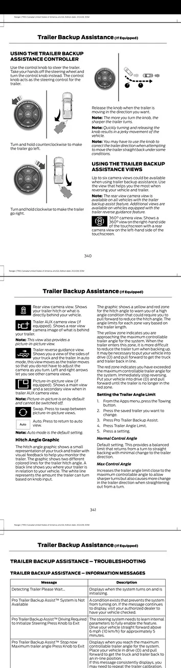

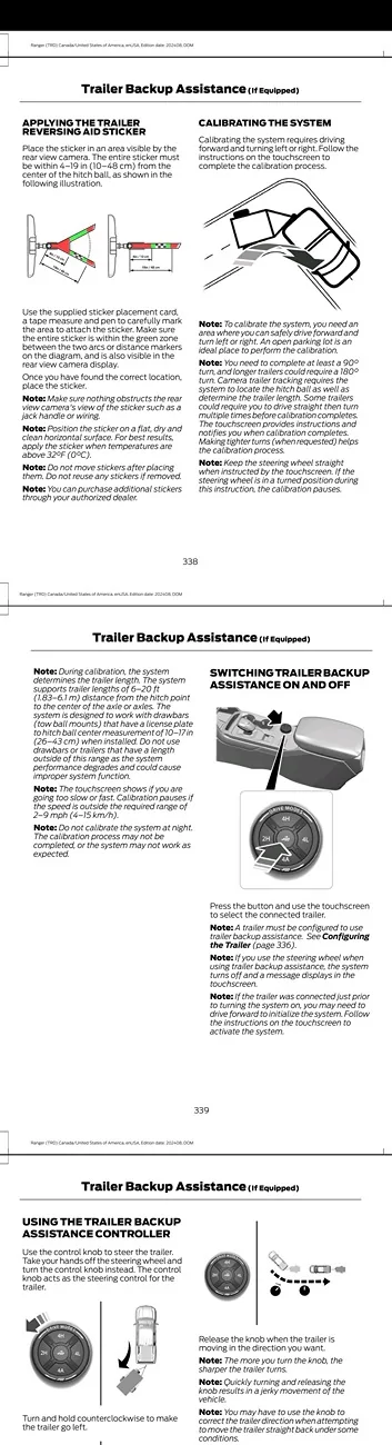

all in the owners manual. if you dont have the full manual. www.motorcraftservice.com and you can download the full 650 or 700 or so page.
