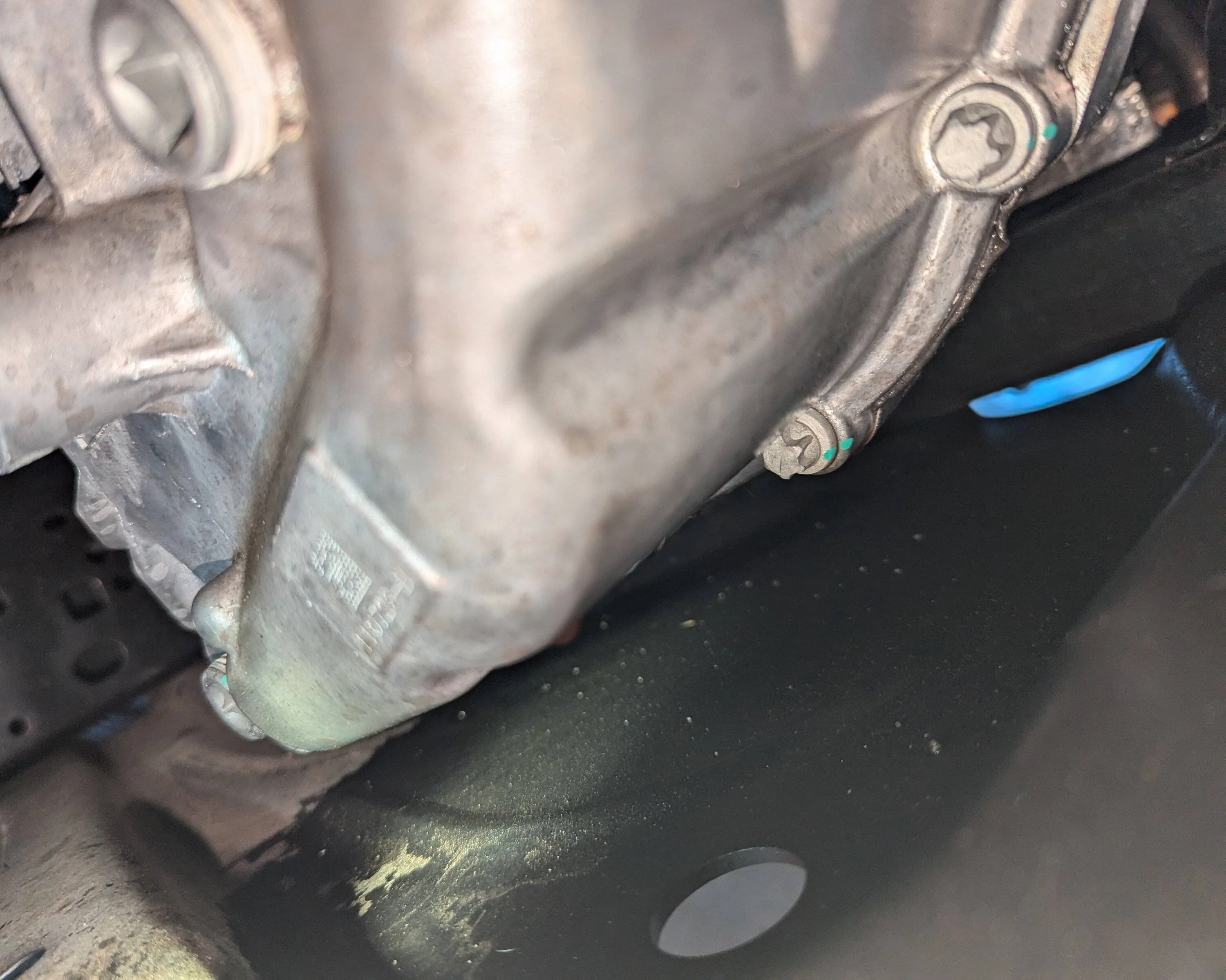

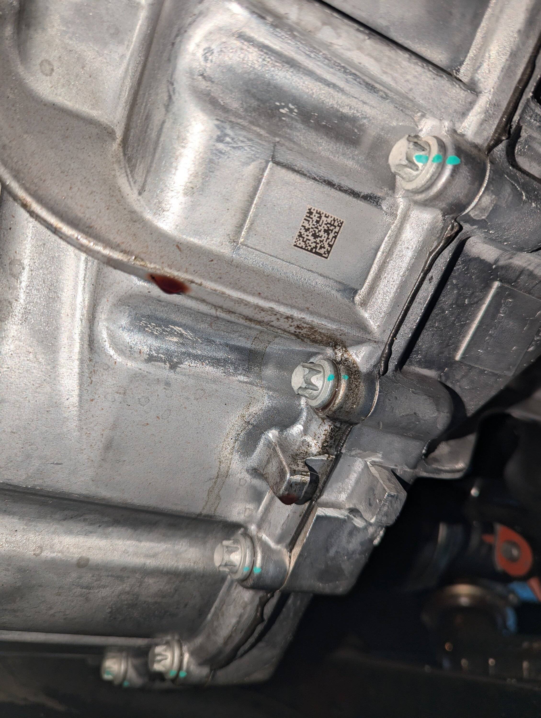

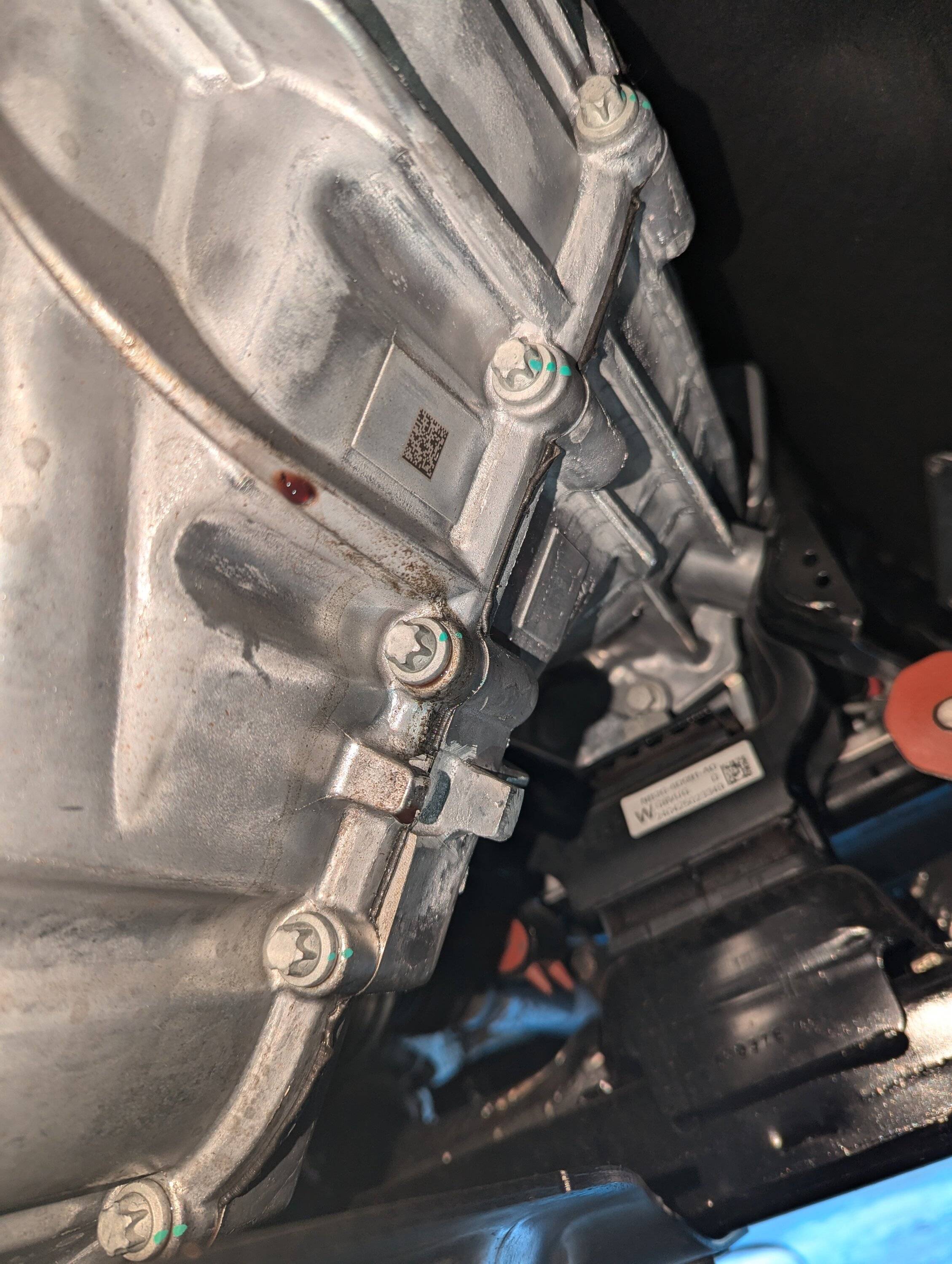

Just discovered my transfer case is leaking ATF at the driveshaft and probably has been since it was built based on the drips onto the tray/skid below. I bought my Ranger Raptor roughly 5/28, and it just turned over 1,900 miles this week. I am going to schedule an appointment to get it looked at under warranty but not thrilled. Assuming (and hoping) our transfer cases are filled with ATF rather than gear oil and this is a simple output/driveshaft seal replacement that will fix it.

Took awhile, but a local dealer service center finally had a loaner available and took care of it the other week. The service tech initially said there was no leak and it was just "assembly lube" until I provided pictures showing the drips and the soaked skid under the transfer case. They put it back on the lift and found it then. Not quite sure how it could be missed, but they replaced the output shaft/driveshaft seals and topped off the transfer case. Fingers crossed that's the last service visit for awhile since it didn't give me tons of confidence in the techs.
