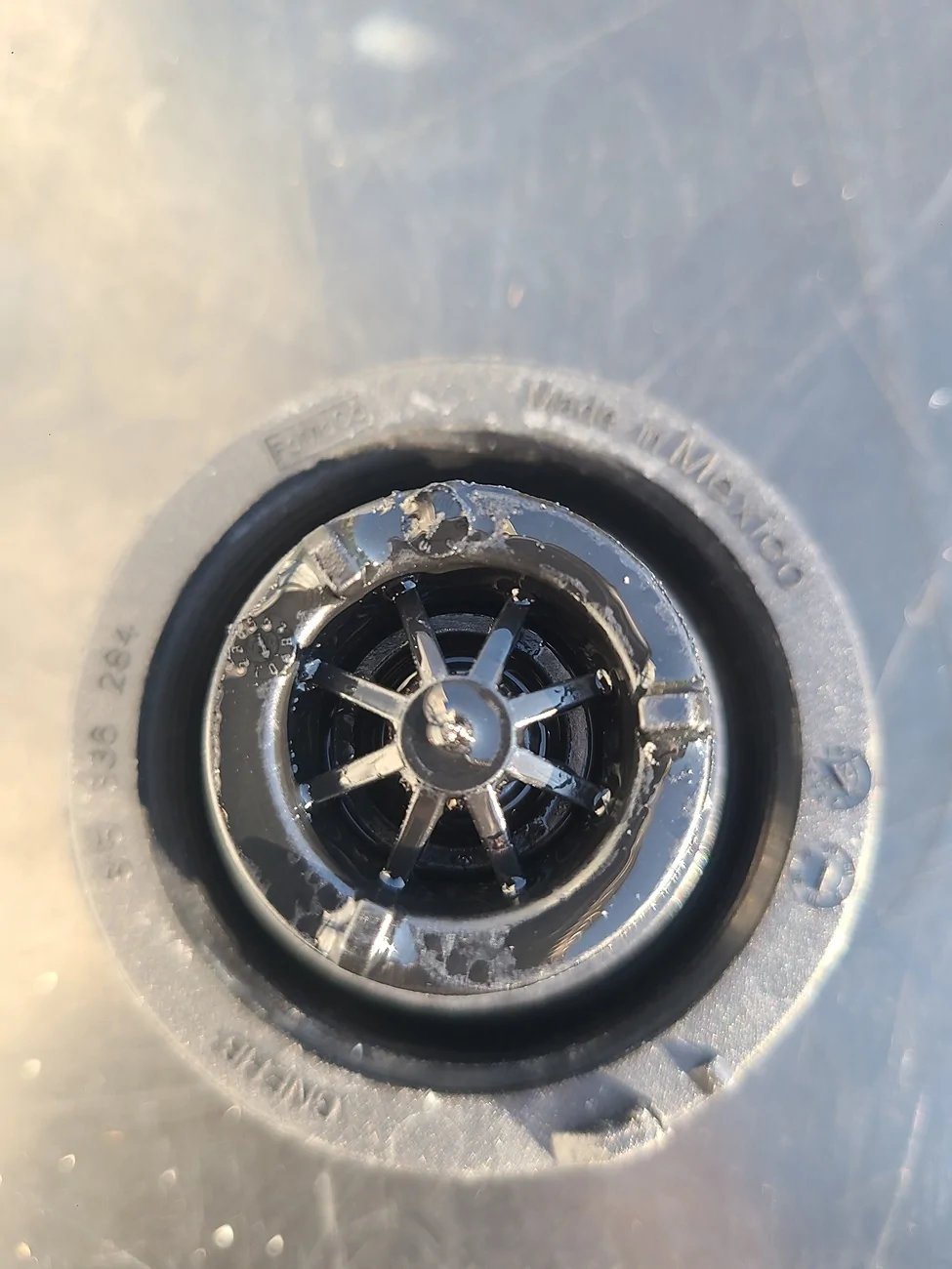

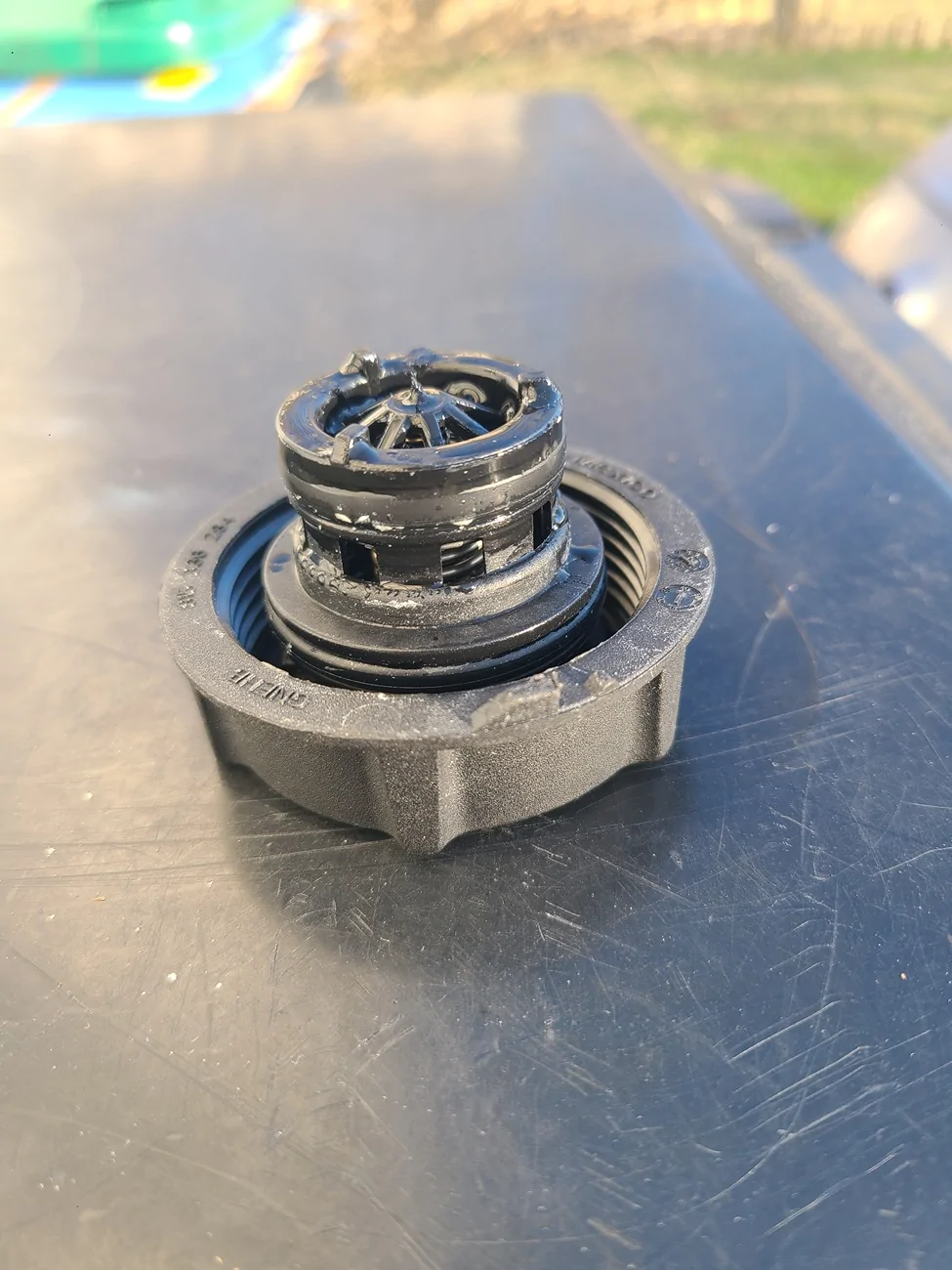

Just snapped a couple pics of mine. Did yours look anything like this?

It looked exactly like that. That first rubber seal on the new cap was rounded and not flat.
