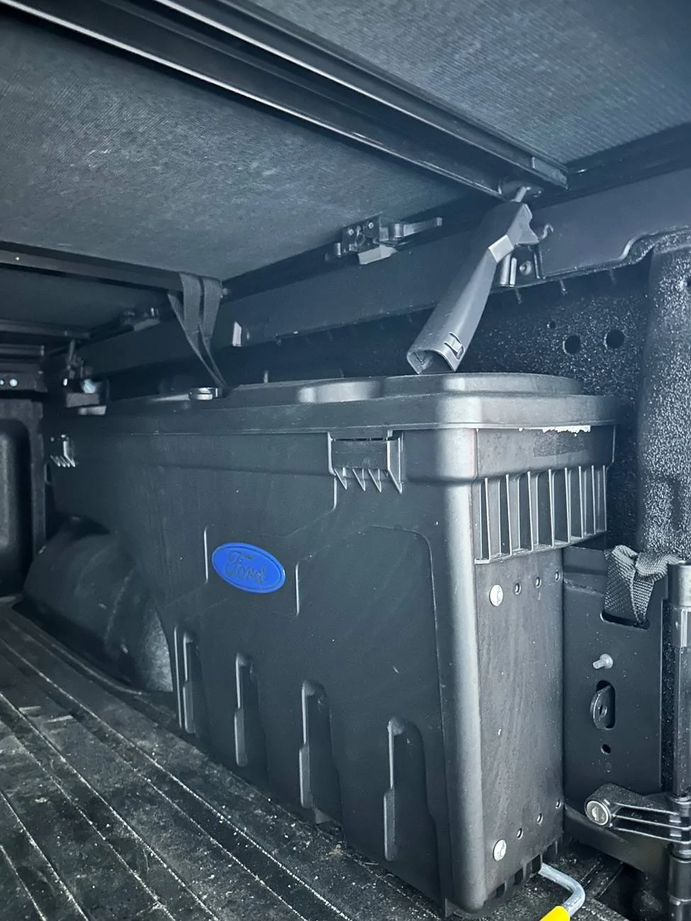

UnderCover Pivot Storage Box in my 2025 Lariat. Install was annoying.

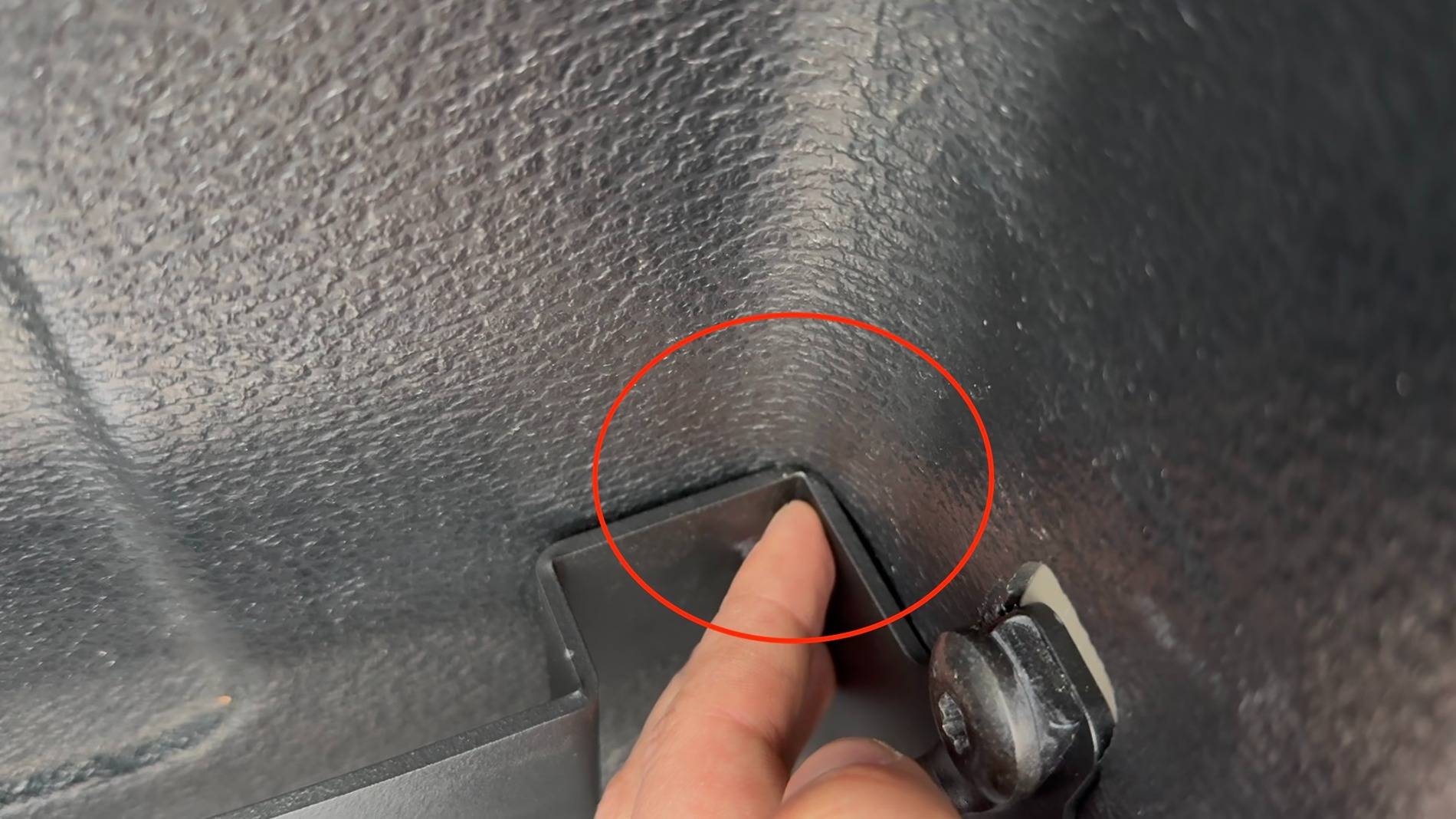

Thanks. How do I know where to trim the bed liner to match the holes?
If I remember correctly, it was a tedious process. I did this:
1. Put the bolt in the hole and cover the head of the bolt with silver sharpie.
2. Push the bed liner onto the head of the bolt so the silver sharpie transfers to the bed liner.
3. Flex the bed liner away and drill a small pilot hole in the middle of the silver sharpie circle.
4. Put the bed liner back into position and put a drill bit into the pilot hole. Stick it through to ensure your pilot hole lines up with the bolt hole.
5. Flex bed liner away and widen the hole with a larger drill bit so the bolt can now go through and you don't mess up the bolt hole.

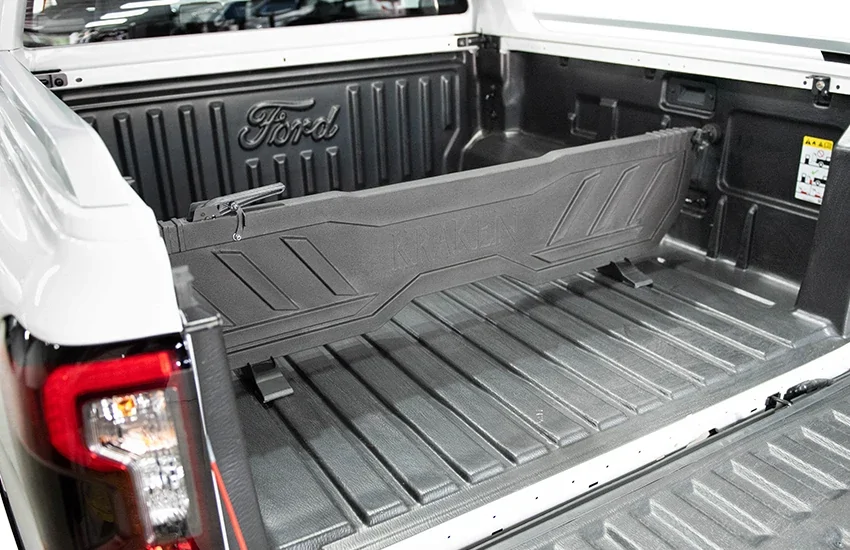

I installed a similar case in my Limited+, the one I installed was brand KRAKEN. It took me 2 hours because I was a little hard to properly align it.. The only thing to complain about now that I have the case installed, is that I used to use a bed divider (not sure if that i the correct name). to avoid bags, etc to move or to go to the end of the bed when I brake.. and now, with the box, I can use it anymore. Did anyone do something to avoid that issue?
this is the bed divisor I mentioned and the box.

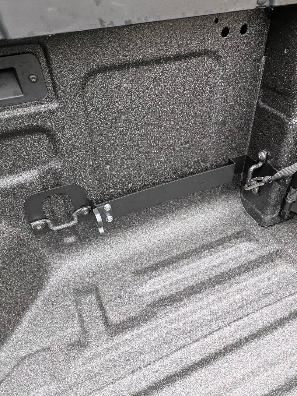

My install issue was removing the tie down bracket bolts. One head broke off leaving the bolt in the hole. Still trying to figure out how to get that out.

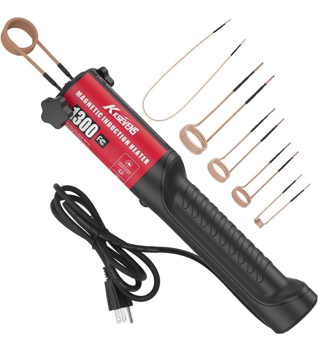

An FYI to this post: The Ranger Factory tie down bolts are installed from the Factory with RED Loctite!
Red Loctite is as PERMINATE as you can get without welding! Nowhere is this mentioned in anyone's (Ford or Real Truck) directions! The only way to remove a fastener set with Red Loctite is with heat.
That being said: I stripped the heads off all 4 bolts in my first attempt to remove them. Before I attempted my second attempt, I ordered a set of bolts through the Ford Pass App on my phone. When they arrived is when I saw the factory applied Red Loctite.
It took a propane torch 2 bottles of propane along with a good pair of Vice Grips to remove the damn bolts. Basically 4 hours of labor. :mad:
I used this. Got the bolts out easy
