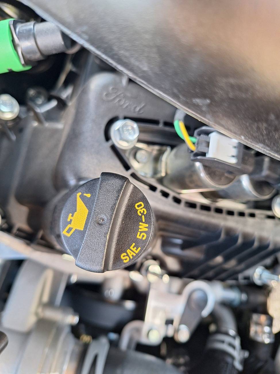

Ford Ranger URGENT: First oil change in Spain at Ford dealership 20240920_123221

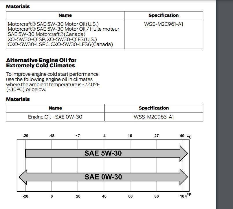

Owners manual shows 0w-30 can be used as well, though it notes "extremely cold climates", ie not Spain. Also, it's 7qts for 3.0L. Others have reported dealer putting in 6Q, which is what 2.3L/2.7L is specc'd.

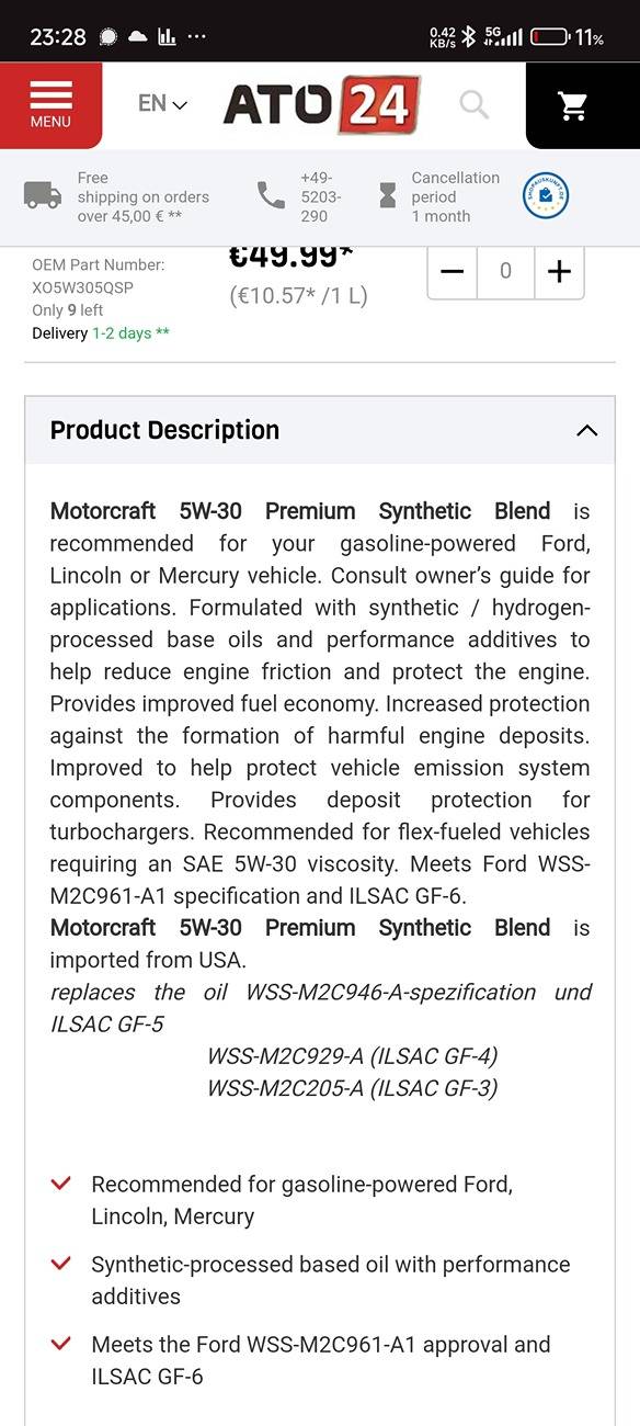

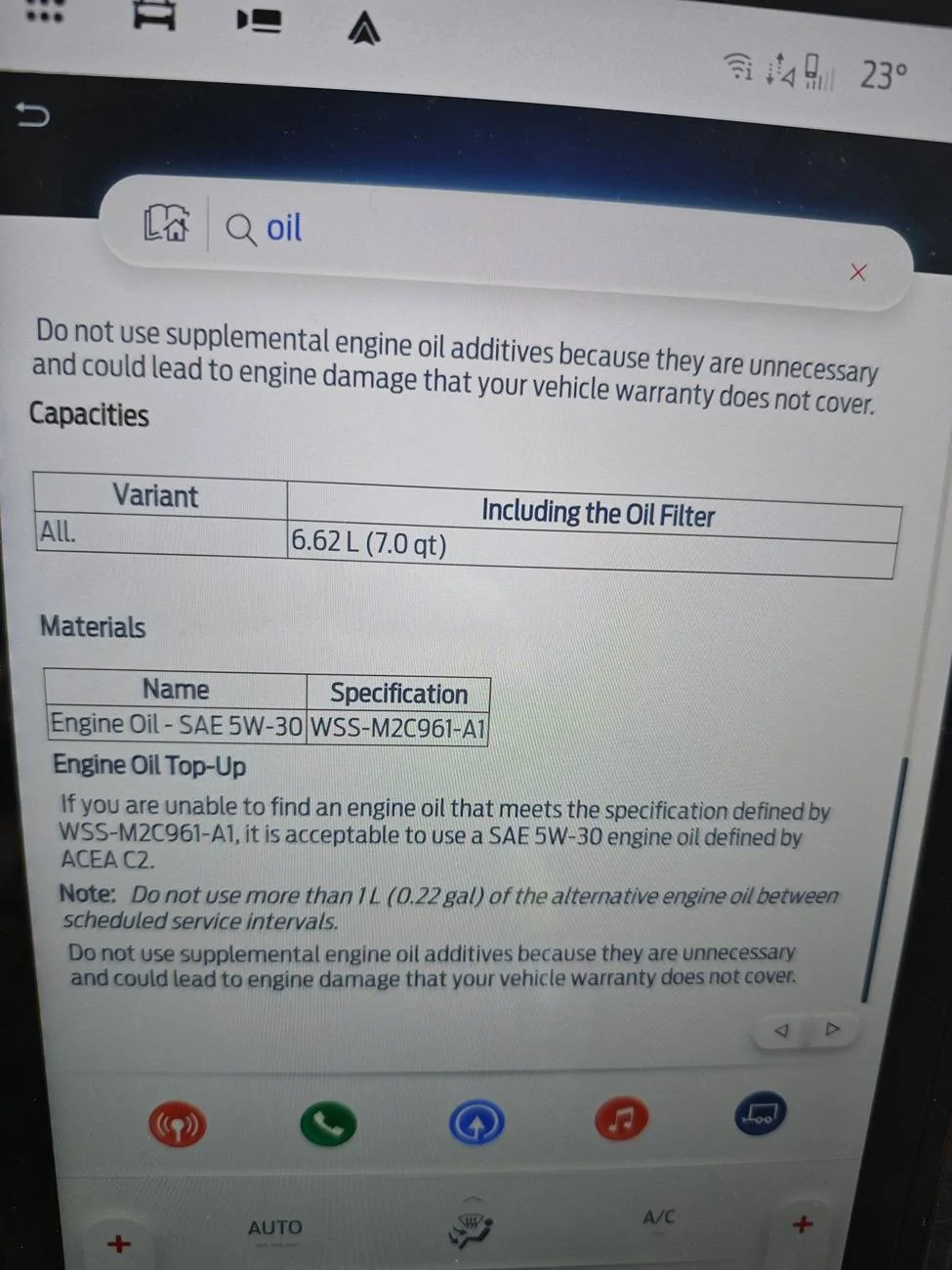

These are my options for matching the WSS-M2C961-A1 spec (according to the digital user manual in the truck) here in Europe.
https://ato24.de/en/motorcraft-5w-30-synthetic-blend.html
https://www.ravenol.de/en/properties/empfehlung/ford-wss-m2c961-a1
The motorcraft is imported and about $220 for 5 gallons / 20 quarts
The ravenol is German and I guess it meets the spec but as an "approval".. Also more expensive
