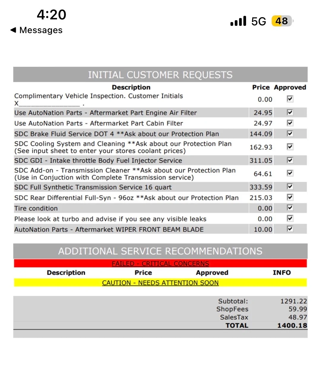

Here’s what I’m getting done for the 30k service
Ouch, I just did my 30k service myself which included all you listed plus front differential and transfer. Total was 265.00. Transmission pan drop was a pain but save big $$.
I would check diff levels when they finish. My rear diff was 1 qrt low

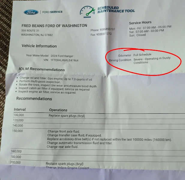

Took my RR in today to get the seat recall done and see what they'd recommend for the 30K service. I was a little surprised after they did the oil and filter and rotated tires and checked a bunch of stuff (including the engine air filter and cabin filters that they correctly identified as not needing replacement as I had done them both a few weeks ago) that they didn't recommend anything else yet. Then the advisor printed the page below, using their "scheduled maintenance tool" and even set it to "severe driving conditions."
Ford Ranger 30K mile service, dealership stories wanted 1780704330964-pr
I've always found the dealer recommendations to be very pessimistic; that is, recommended things seemingly way before they should be done; or more often than most would need or want. This one is so far the other direction, I find it nearly useless. I know that technology of the mechanical bits and the lubricants is a far cry better now than it was in the late 90s, early 2000s, but 150,000 miles for driveline fluids?
Anyway, I think I am going to wait until between 40-45K to service the 4WD stuff and probably even have them do spark plugs at that point as I have had bad experiences with waiting on the "long life" plugs and then they don't want to come out of the head. Figure if I do it this way,, I'll have some breathing room before I have the shocks "serviced" at 50K.
