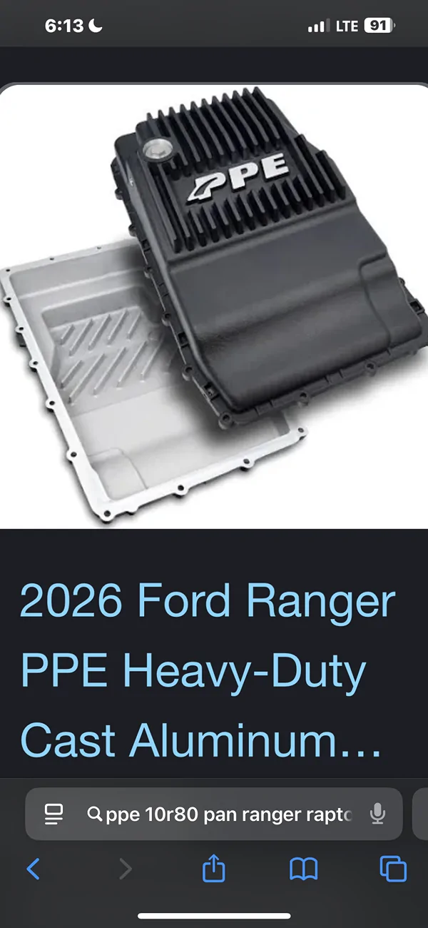

30K all day! Get ahead of the game. Don’t let anybody tell you otherwise. It’s YOUR truck! YOUR investment!
Think that sounds crazy….I’m planning on doing mine at 10K. But I like to change out the trans pan ASAP to the aluminum PPE model that holds 2 extra quarts & adds a drain plug for serviceability for the next time(s). Figure get that break-in filter out of there early and start fresh again. And why not add a more robust pan with extra capacity, cooling fins, and that ever so useful drain plug.
It’s the same setup I ran on my previous ‘19 F-150 w/the 10R80 and I did the same thing at 10K & changed it every 20K. Trans never gave me an ounce of trouble during ownership. But that pan was a pain with the crossover pipe on those 3.5 Eco’s coming across the back of the pan. Not sure if you’ve been under your RR, but this trans pan is an absolute breeze to access! None of the bolts are horribly blocked or hidden and there looks to be zero interference to drop the pan. Couldn’t ask for an easier driveway/DIY trans service on a newer truck.
Just something to think about but maybe look into those PPE (or others) 10R80 pans if you’re going to go through the process. Or re-use the stock pan. Either way I think 30K is the perfect sweet spot!

i was just looking at those yesterday. i think those are a very useful upgrade
