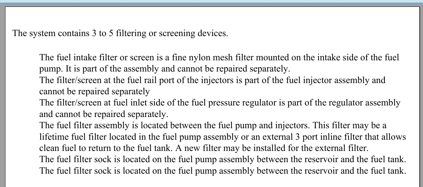

2024 2.3L. I see where 2 fuel lines leave gas tank, go up over the 4x4 transfer case, up behind engine. I don't see a canister fuel filter along the frame rail.
I'm guessing it inside gas tank and we don't replace every 15-30k. Correct?
thx!
Service Manual Info. No serviceable fuel filter.
