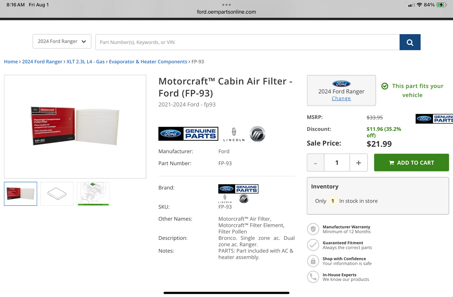

Afsigma21
Mar 10, 2025
69
103
OH
2024 FX4 Lariat v6
Air Force
Visually I could hardly tell the difference.... I say 90% or better of OEM Quality. TOTALLY an opinion

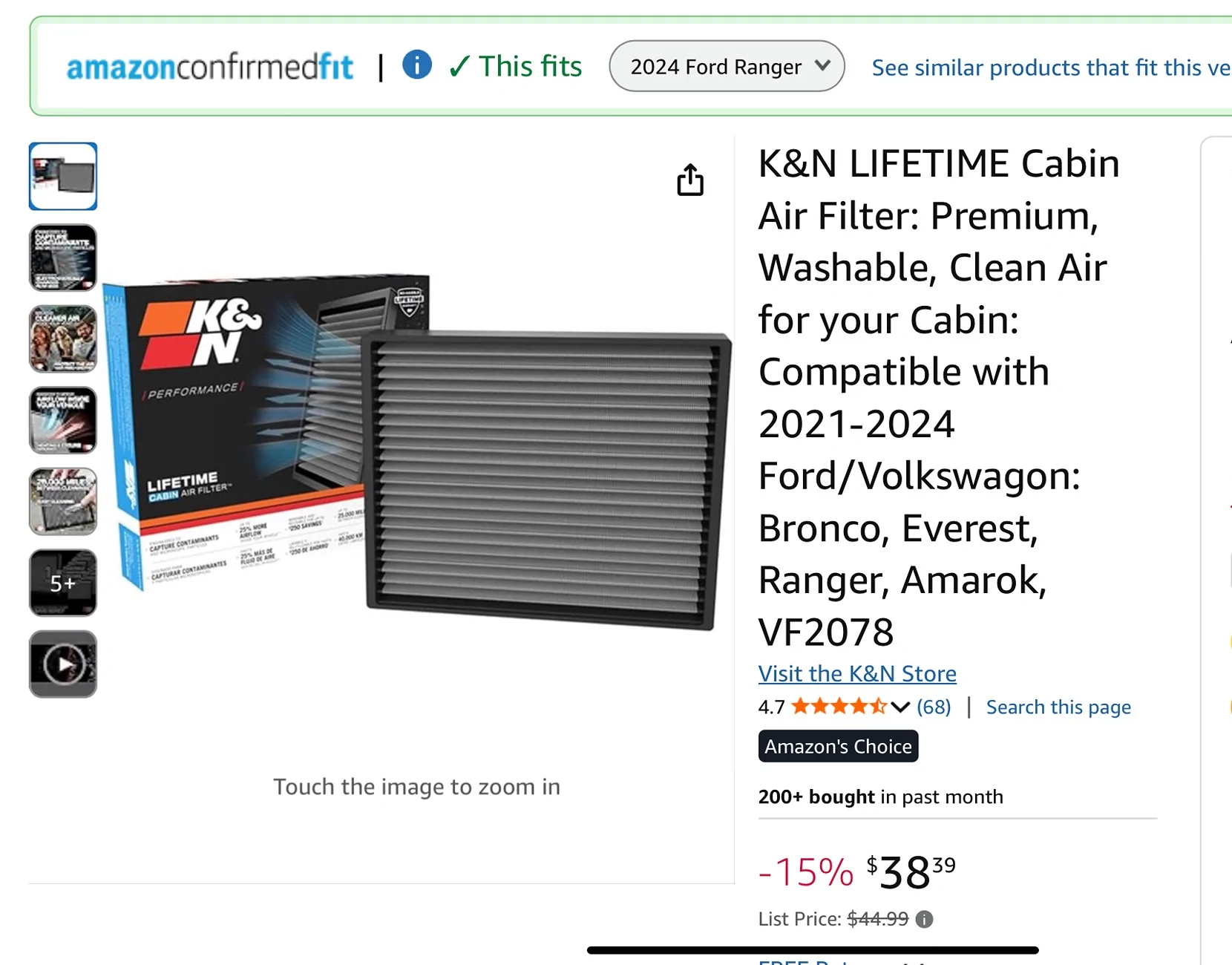

Are you guys talking about K&N CABIN filters? The main website says Out of Stock, the Amazon page for the VF2078 looks good, but one buyer said that it absolutely did not fit a 2024 Ranger.
https://www.amazon.com/Cabin-Air-Fi...09YZ6H48X/ref=cm_cr_arp_d_product_top?ie=UTF8
Can somebody confirm the correct part number?

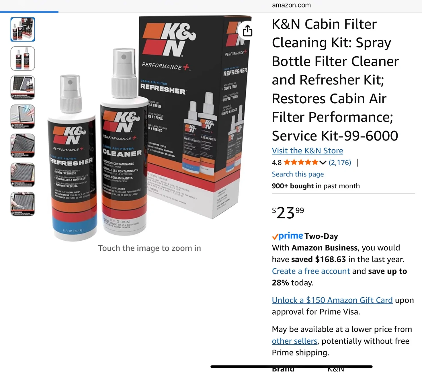

Do you use the special cleaning solutions or a substitute? How long does it take to dry after? The “Refresher kit” is tiny and $$$, how much solution is needed to clean and refresh the filter (how many uses per kit)? That will determine the actual long term operating expense of a special filter! You have to use the special “potion” to restore the electrostatic ability of the material….
How to clean filter

The Bronco filter was a direct fit. I haven't cleaned the cabin filter yet. I normally clean KN air filters letting them dry over night and oil/reinstall the next morning.
ItemsQty
High-Flow Original Lifetime Engine Air Filter - FORD BRONCO 2.3/2.7L F/I
SKU: E-0634
Cabin Filter Cleaning Care Kit
SKU: 99-6000
K&N Lifetime Washable CABIN AIR FILTER
SKU: VF2078

Thanks! I ordered the same from Amazon yesterday and it arrives today. Glad to hear confirmation it fits.

I would still like to know how many cleanings you can get with the K&N kit. If you only get two, that means it costs $12 per cleaning, which is the cost of a new Amazon paper filter. There will not be any money savings unless you can get four or more cleanings and static treatments out of one kit. Unless there are cheaper solutions?
Plus you need to factor in the time needed to service the K&N filter, it isn’t trivial. A paper one OTH goes straight to the trash when dirty…
2. APPLY CLEANER: Spray a generous amount of K&N’s specially formulated cabin air filter cleaner P/N 99-0650 onto both sides of the filter, with a majority of it applied to the dirty side. Allow the cleaner to soak in for 10 minutes. Do not allow the cleaner to dry on the cabin air filter.
3. RINSE FILTER: Rinse off the filter element with cool or warm (not hot) water from the clean side out in order to flush the dirt out of the filter. It may be necessary to use your fingers on the hose, to apply light water pressure. Repeat steps 2 and 3, until the water flowing through the media is completely clear of any dirt and debris.
To me that sounds like a regular PITA, so why bother?
K&N Cabin Air Filter Service Video
FYI if you decide to skip the refresher step, you risk starting a thriving bacteria or fungas colony in your entire HVAC system. Not at all good….
