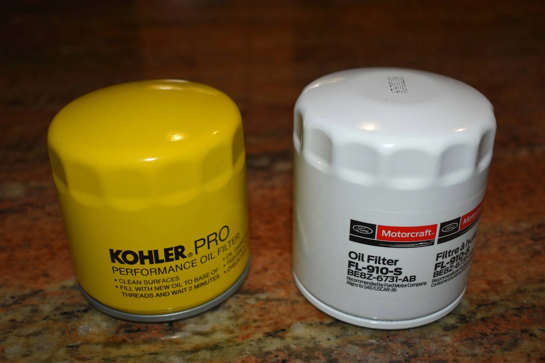

I just bought oil and filter for my first oil change for my recently purchased Lariat 4X2. I am somewhat appalled at the small size of the Motorcraft oil filter. It is only slightly larger than the filter on my lawn tractor's 725cc engine. I have to assume Ford engineers know what is needed. I have yet to crawl under the truck to see if a larger filter would fit. Has anyone installed a larger filter?

A Motorcraft FL-400S is about 1/3 larger and will fit. Equivalent to a FRAM PH3600.
Thing about larger filters is that in the rare event you have a filter failure that cascades into engine damage from it, is grounds by the filter maker to not cover it if not cataloged for the application it was installed in.
You are not solving any problems going oversize unless it is just for the feelz.
I have stopped using the Motorcraft FL-910S after finding torn media on one I removed from my wife's Bronco Sport.

My '19 Ranger takes the exact same filter as two of my ride-on mowers. A mid 90's John Deere and a new Cub Cadet zero turn. Makes life easier when filter shopping.
I'll have to remember this. The Walmart derived FL-910 is much cheaper than a Kohler for my Husqvarna mower.
