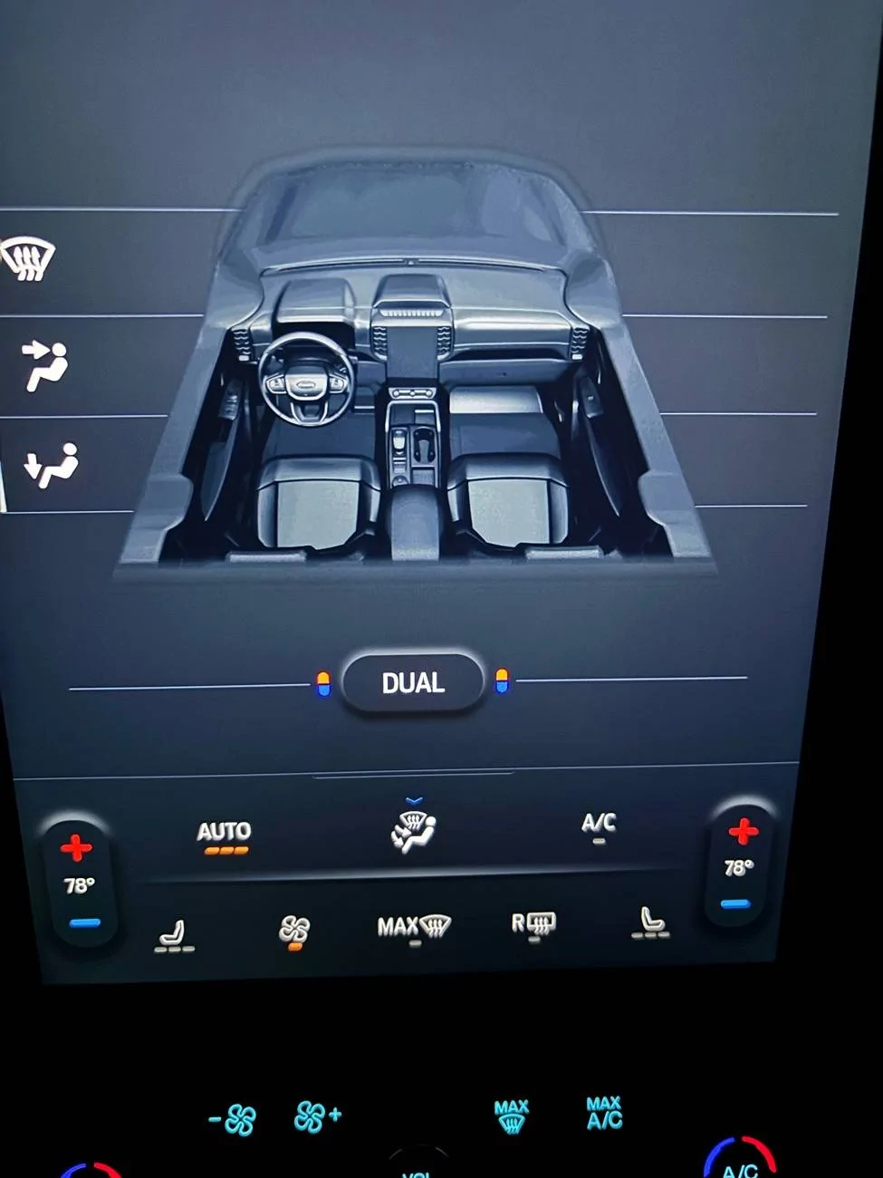

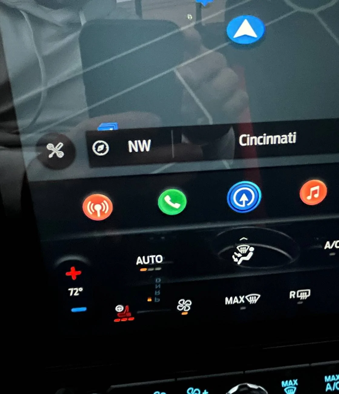

Hopefully someone here can answer this question. I’ve had this raptor for two days and I’m trying to figure out what the auto button does in the HVAC area. If you touch auto, there’s three levels of auto, like a low, medium, high.
I’ve hit the button and the fan doesn’t go on anymore than the previous level?. Also, can anyone else figure out if there is a sync function in the dual HVAC? Thank you.

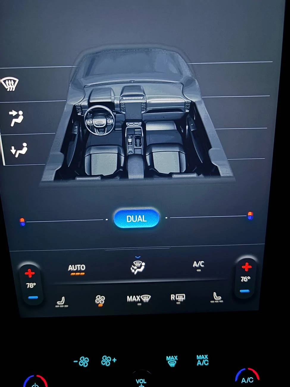

I'm also curious about the 3 bars under the auto setting. As far as syncing goes...
Synced:
Ford Ranger What does this do? IMG_5712
Not Synced:
Ford Ranger What does this do? IMG_5714

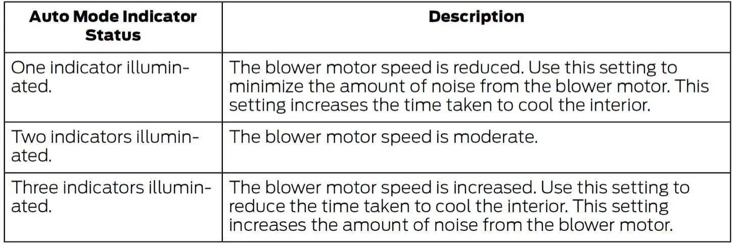

Auto also controls function (AC, def, heat etc.) and also temp based on your temp setting. Fan cuts higher and lower as needed. The 1-2-3 is a fan bias setting (for higher to lower fan speed bias).

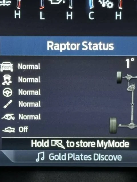

While we're asking what things do...
Does anyone know what this icon means at the bottom of the Raptor Status page? I can't figure it out.

Trail control
