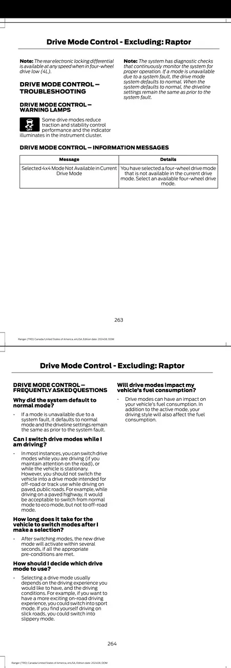

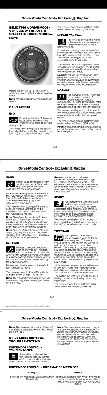

Slippery mode changes how the truck responds to the road.
It reduces throttle response so the truck does not spin the tires as easy. It also changes how traction control and stability control work. The truck will try to keep wheel slip low.
Slippery mode can work in 2H or 4H, depending on the truck settings.
4H sends power to all four wheels all the time. It helps with traction but does not change throttle or shift behavior.
Use Slippery mode for snow covered roads. Use 4H when you need extra traction at low speeds.
