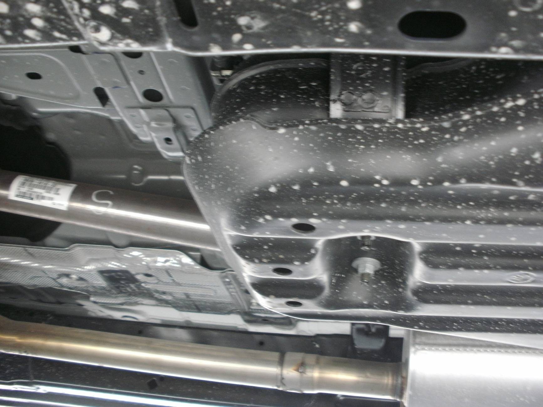

Probably not a issue anymore but a lot of the early ones had rust underneath-driveshaft mainly.
Mine was all good.
Ford Ranger What Ranger XLT issues should I look for at delivery? Underneath
