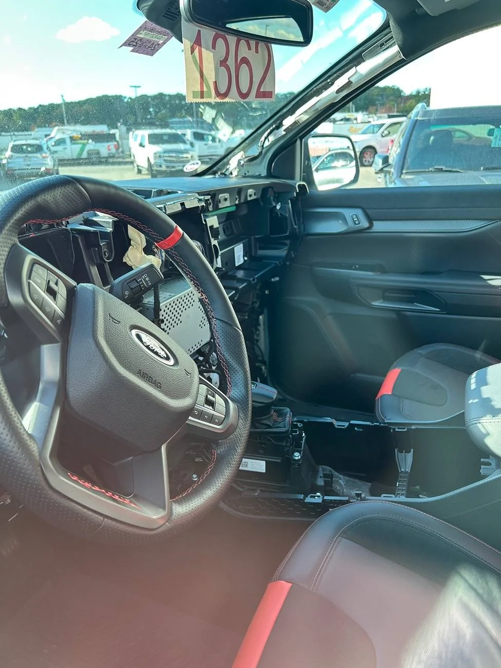

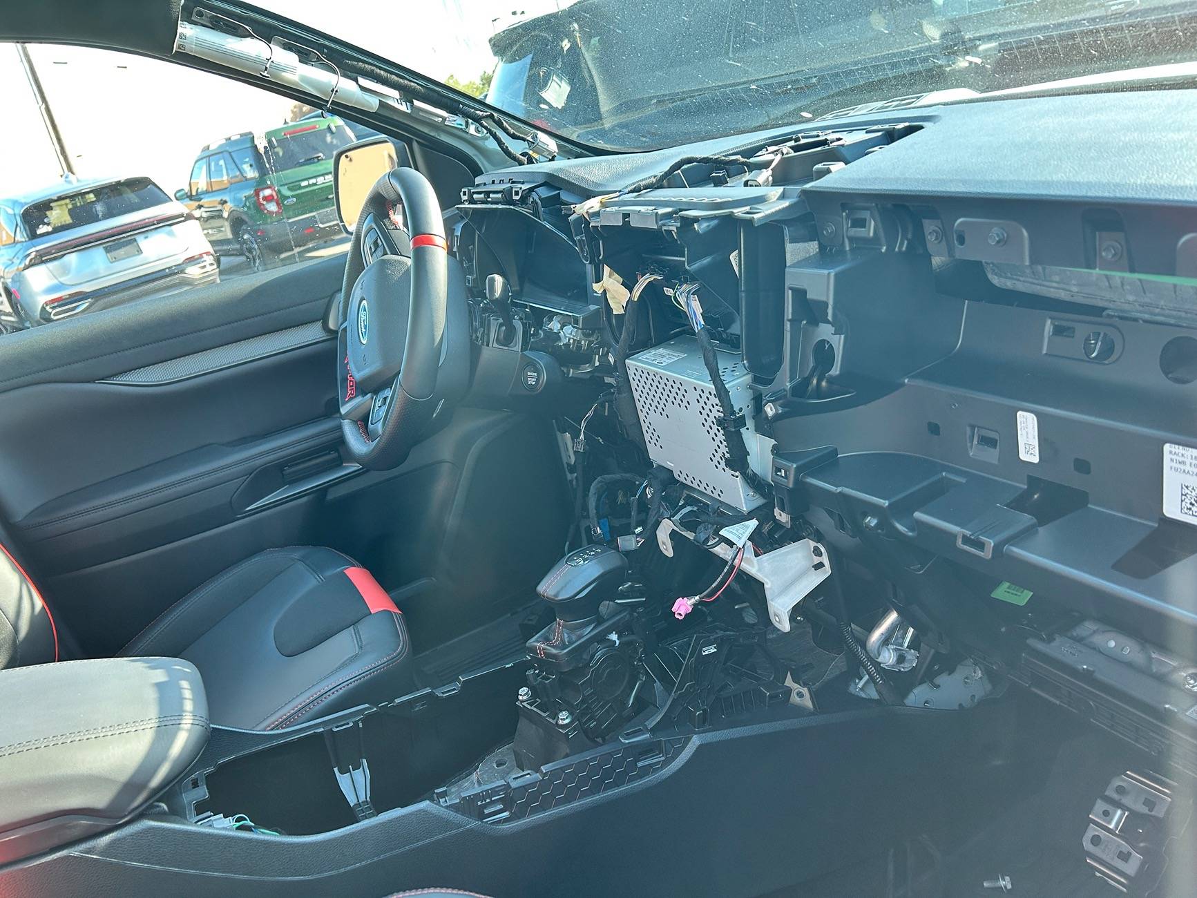

figured I’d update this for anyone experiencing the same noise. Buzzy rattle sound behind the dash over bumps? Well, it was getting worse. Brought it in for my first oil change and asked them to fix it. That was 3 weeks ago. Here’s what it looks like now…I’ve got a rattle that’s going to bother me until it’s fixed. I hear it over good sized bumps like potholes and manhole covers. sort of a buzzy rattle noise that comes from the passenger side of the dashboard. Anyone else?
Waiting for an upper dash assembly. What they found was a plastic weld that had separated. Dealer has been great. @Ford does not seem to care about customer satisfaction. Tech support the dealer was using made them wait days for each next step of the dio. Once they figured it out I’m told 10+ days for the part. Longest I’ve ever had any car in for service.
