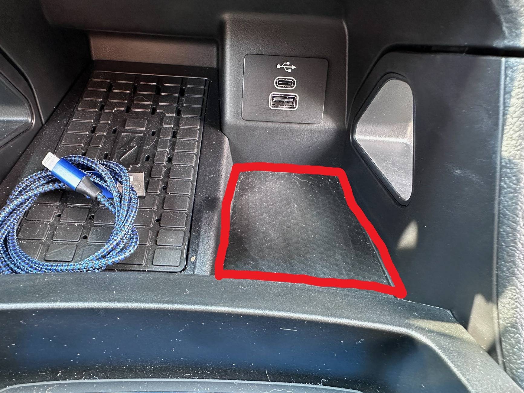

I'm about to install an auxbeam switch panel in my 24 XLT. I'm using a Ram mount out of the cubby in front of the USB ports. I was wondering if anyone knows what is under the plastic. The truck is loaded and I'm finding modules and wiring in every possible place. Plan B is VHB tape. Thanks.

I took this all apart to put in THIS dash mount.
Here are the instructions. https://www.industrialevolution.com.au/wp-content/uploads/Ford-Everest-2022-Indash-Install.pdf
It all comes apart. There's space under it for sure, but there is also a wire loom bundle right under it, so any modifications should be done with it removed so you don't drill into your loom.
100% possible to take out with a wrench and trim tools.
For reference
https://www.ranger6g.com/forum/threads/dash-mount-solution-final.10596/post-196828
