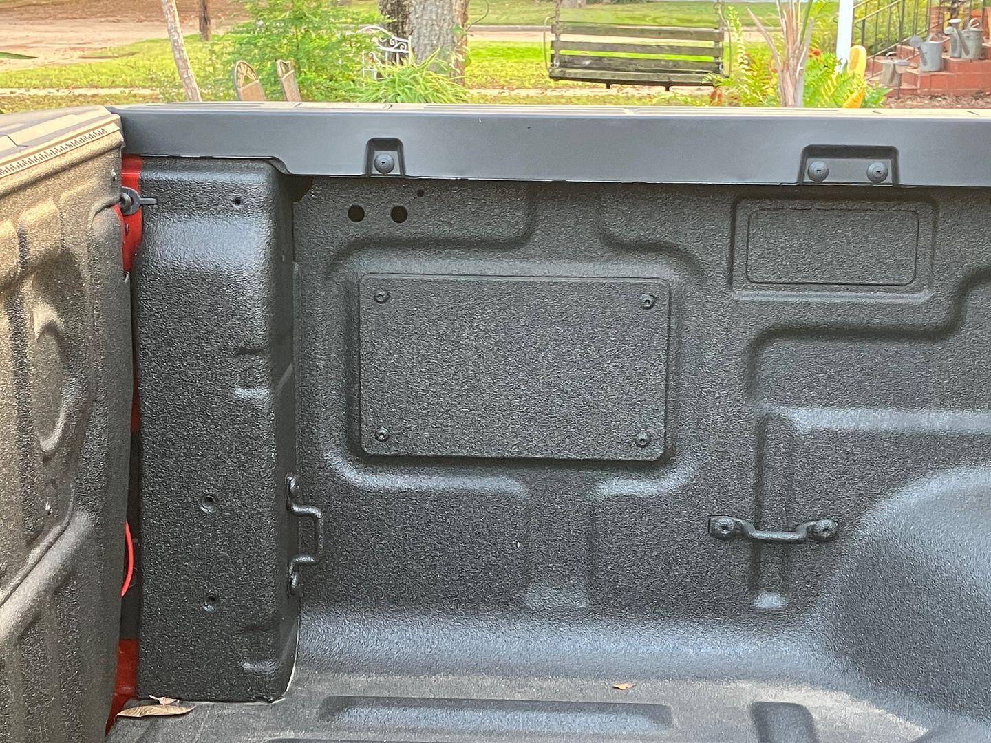

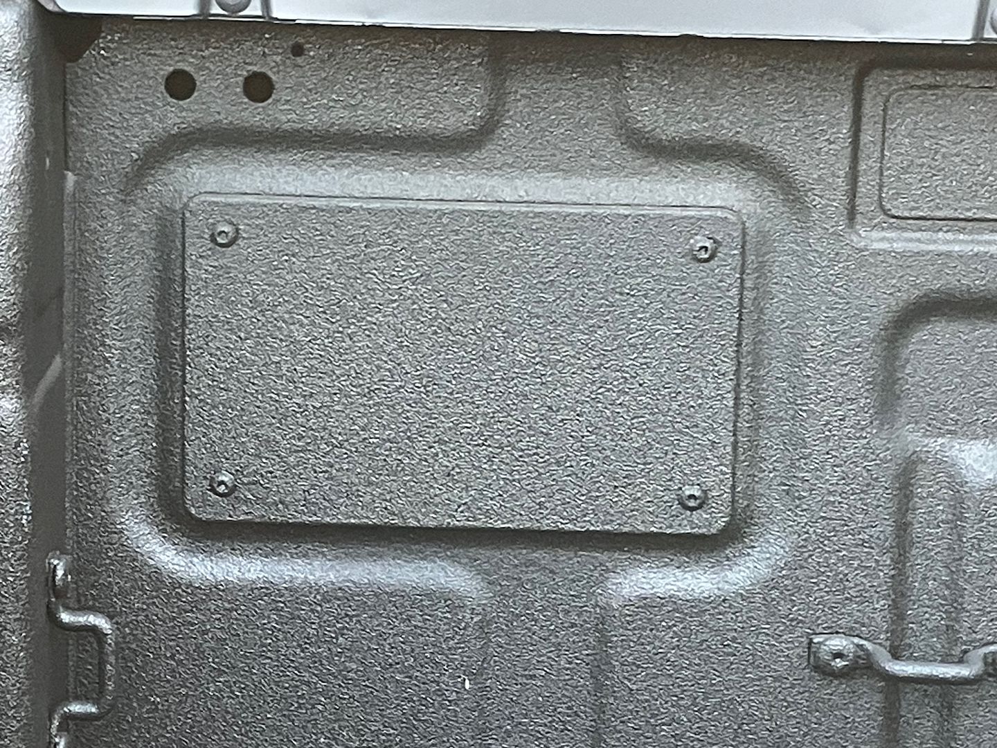

Can someone tell me what's behind this panel on the driver's side of the bed in my 2024 STX Ranger?

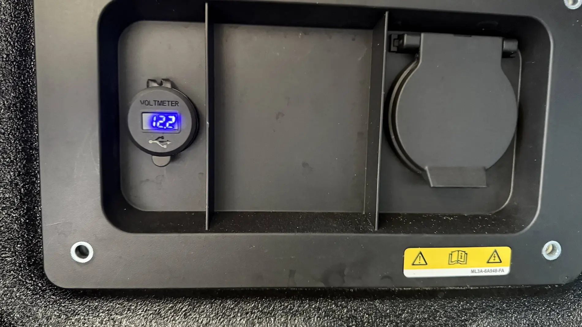

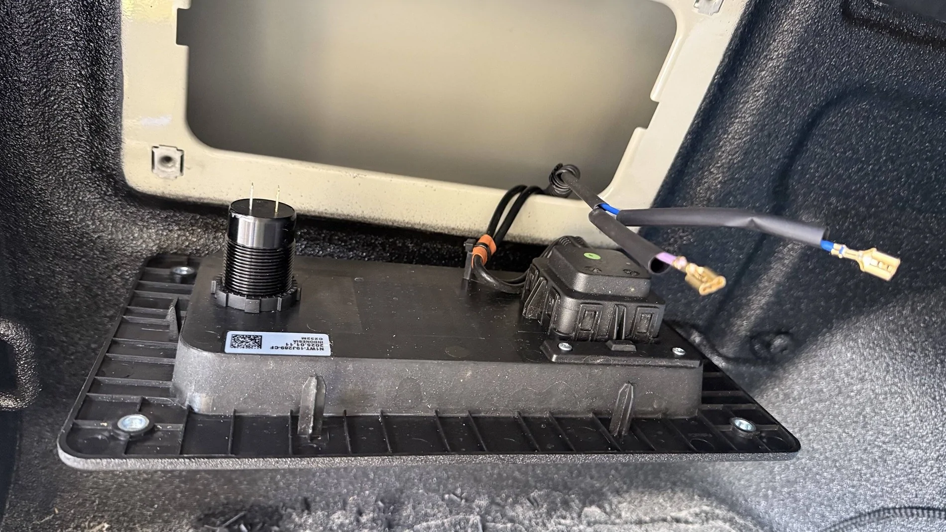

I believe that's where the in bed power would be located, but I don't think it was available on the STX trim.
I'm not sure if the wiring would be behind there though, you could always open it and take a look.

Yep, here in Australia that's our power accessory plugins. There's also wiring blanks for the overhead toggle switches in the cab.

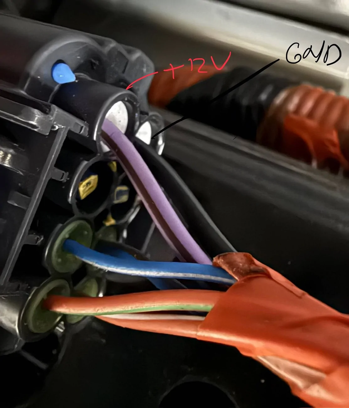

The 12v-to-120v inverter is located below the drivers seat. The orange cables might come from that position.
There might be other cables for the switch of the factory electric folding tonneau, available on many markets. Mine have it. Wildtrak made in south africa for Mexico and south american markets.
