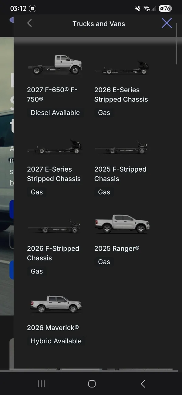

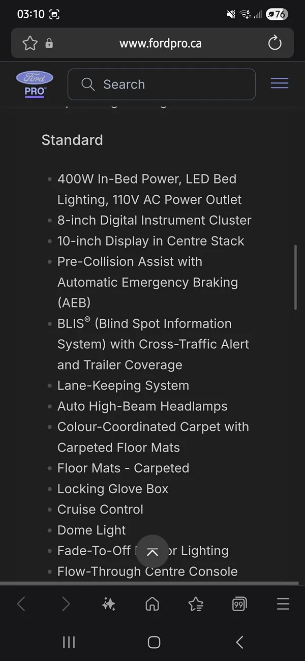

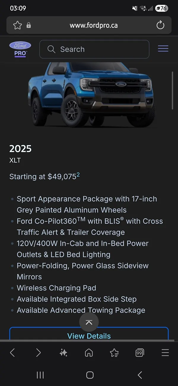

I never paid for it either. the xlt's in canada. came standard with it. its not on my window sticker, but when I looked at the build sheet in the ford software you csn buy access for to look at the factory service manual and stuff, it shows as there. and on fordpro canada it stated all canadian 2025 xlt's it came as standard. I do see on ford canada, its now an option. i havent seen if ford pro has updated their site or not yet, but a few weeks ago it wasnt for the ranger. We also cant buy a 4x2. 4x4 is the only option for driveline.
edit. nope still no 2026 ranger on the ford pro canada site.
