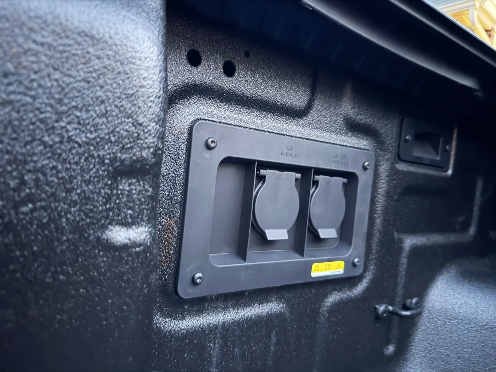

Thanks for the discovery and guidance on this one. I ordered the OEM replacement part for my ‘25 and it should be here Friday. I’ll report back, install looks to be straight forward.
DrIanMalcolm
Anthony
Jul 28, 2025
60
Pennsylvania
For me, the hardest part was realizing that I could access the connector from under the truck. Thanks again @PMK - this is easy, cheap, and very useful.

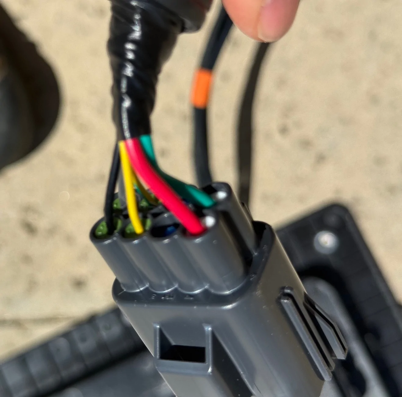

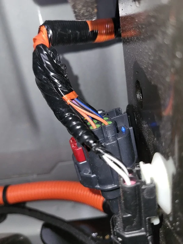

If you have the bed ac outlet, then yes, this has been a plug and play update for the 25
I don’t know if anyone has done a 26 yet. To verify that 12 volts is still wired to the connector underneath.
you could snap a picture and verify 6 wires are running to it.
it Is the red and green on this connector that carry’s the 12 v so hopefully your plug underneath has corresponding wiring.
it should have purple and black as shown.

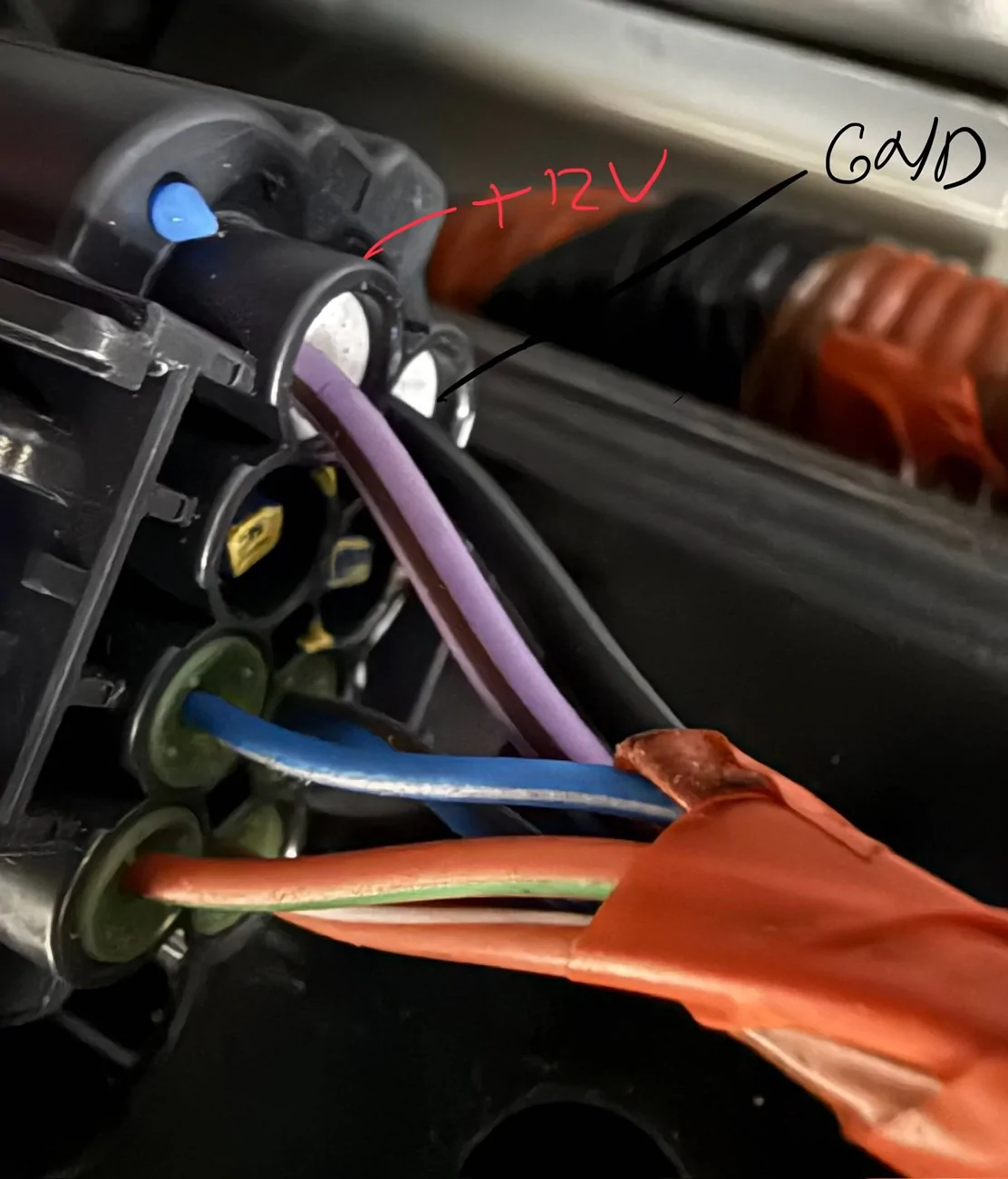

A pic of my 2026 appears to show black and purple wires.
So should be good to go or need better pic?
The wires you need for the 12v are the ones at the top of the connector in your picture (with the white seals). The blanks on these connectors are blue plugs

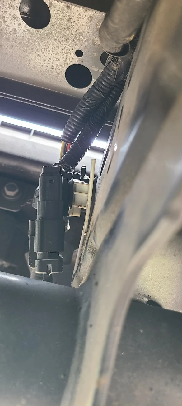

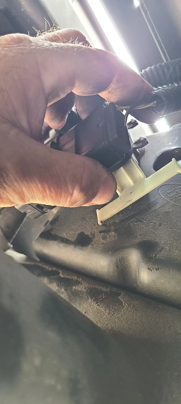

My 2024 stx doesnt have a blank plug with a cover in it. The one i think it goes to has a plug into it with two wires coming out the cover side.
Ford Ranger 2025 Ranger - Bed 12 Volt Outlet - Final Update 20260508_112620
Ford Ranger 2025 Ranger - Bed 12 Volt Outlet - Final Update 20260508_112638
Is this the plug? What do those tiny wires do?
