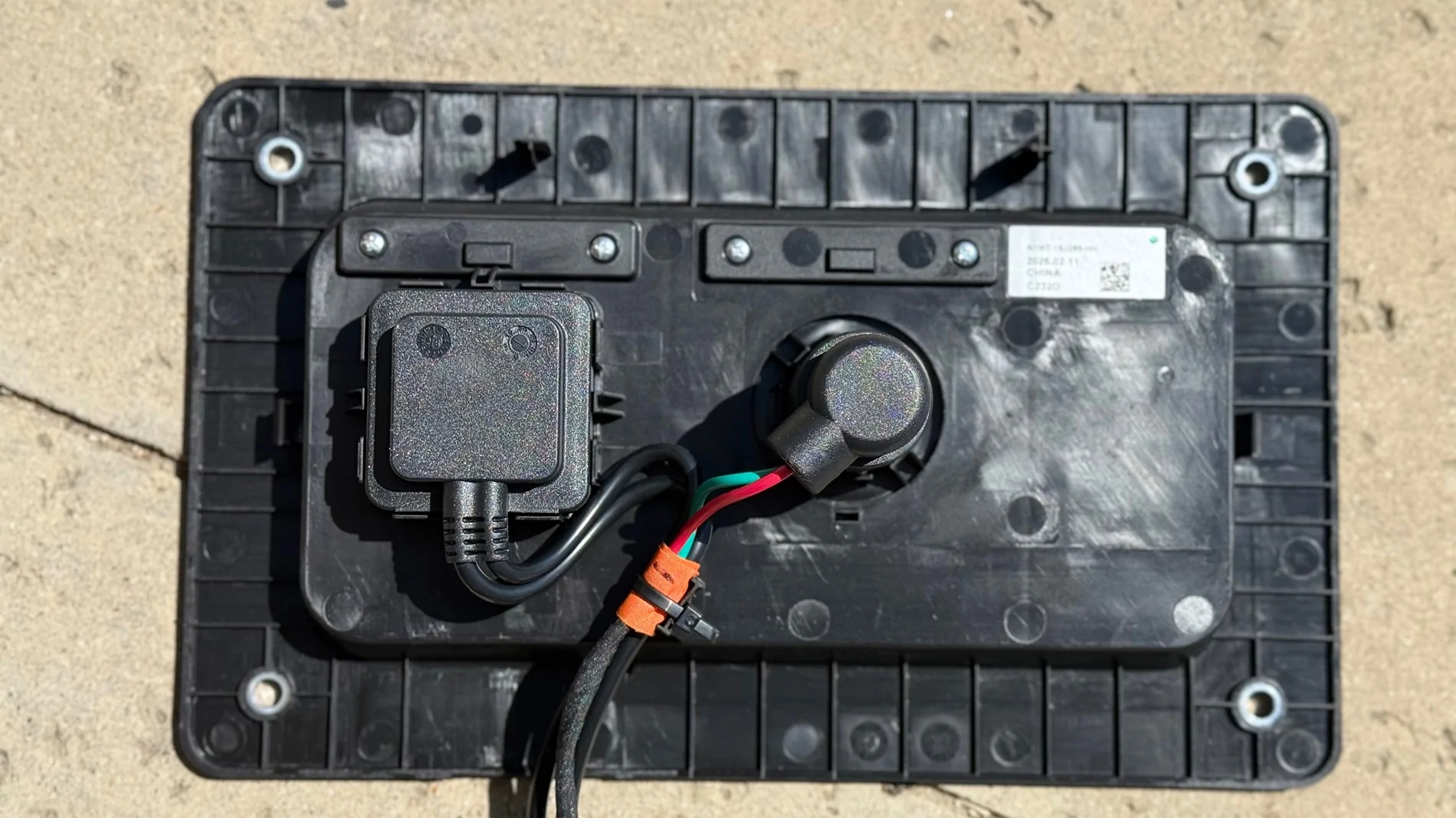

I am still trying to figure out if the panel you all are ordering will work on my OCT 25 Ranger XLT.
Here is the back of my current AC only panel. The connecting pin assembly is not immediately behind the panel as shown in Dino Jockey's post #41. My connector is down near the driver side area of the bed. See posts # 95. I must be missing something. If the replacement panel arrives with a pin connector assembly close to the back of the panel, I don't think it would reach to where my current pin connector assembly is. And, there is no pin connector assembly in the space between the bed wall and the driver side rear fender.
Am I just overlooking something?

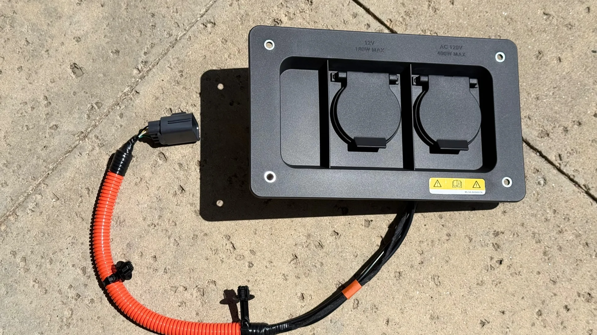

‘the panel comes with a new cable as shown. You need to verify the plug underneath that this goes into has a purple and black wire to match with the red green wires

Thanks much @Luth33 and @purdyd. I do have the two wires mentioned in purdy's post and ordered the panel today. Hopefully, the install will be as easy for me as others on this thread. Will report back after it arrives.

So I finally got my brand new 2025 Ranger XLT. After examining several threads and finally seeing the harness on the truck, there IS no change to the wiring harness to the bed power outlets.
I purchased a 2024 panel - the part number superseded to N1WZ-19A464-CC. It was about $100.
I unplugged the old one, pulled out the two christmas tree supports off the old one, put the new one in, I have 120VAC and 12VDC in my bed. No FORSCAN, no wiring, nothing. Push, pull, click, click.

I just now did the same, and it is truly plug-n-play. I timed myself just for the heck of it, and, once set up, it was almost exactly 5 minutes from start to finish (giving myself a 1 minute grace period to get my old self up off the ground).
