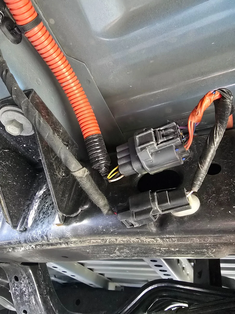

mine was built February 2025, the connector is on the frame under truck. only 110V plug. but frame connector has 12v on truck side. 6 wires going into the plug, and only 4 coming out

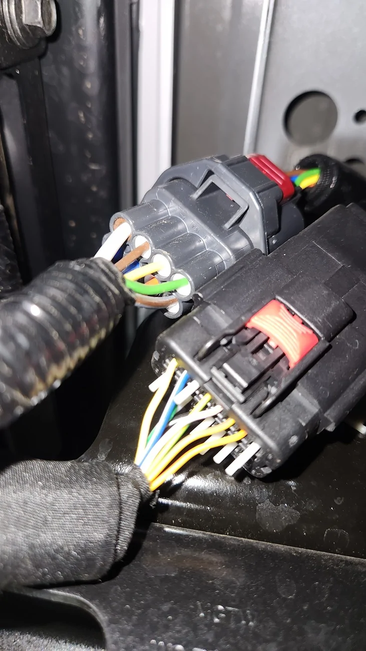

Mine is set up the same but I do have six wires behind the wheel. I neglected to count the wires behind the panel before I screwed it back into place. 🙄

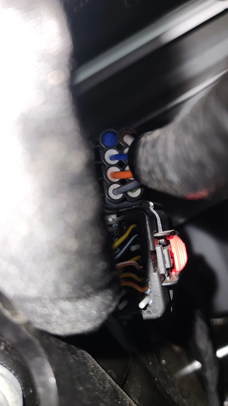

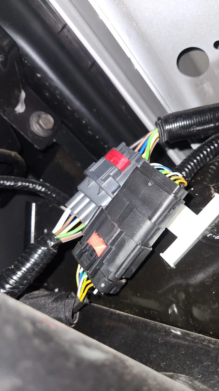

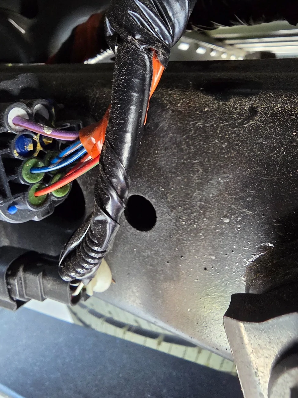

Ok, took some photos under. March'26 build. I do have a orange wrapped loom coming down the frame rail. The orange tape stops before it branches off to the other pictured connectors that I think are the subject of y'all's posts. Seven wires in that one connector and one blank. ---shrugs--- 😁

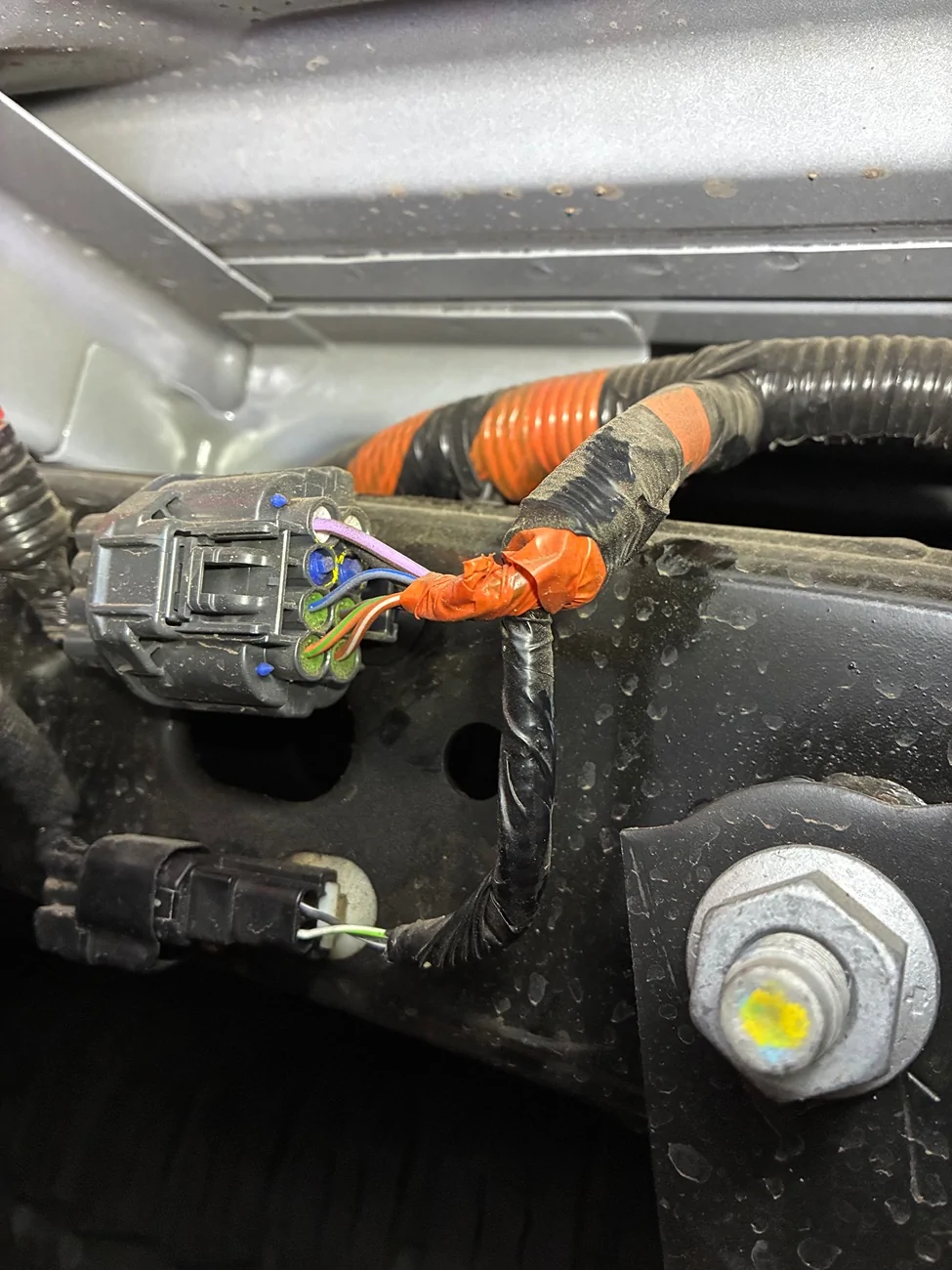

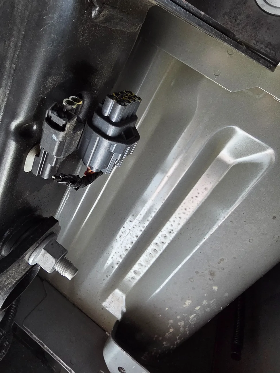

A couple quick questions before I buy the part. This is a pic of the underside of my 2025 XL 2wd with trailer tow. They come from the front in an orange and black wrapped harness. I do not have an inverter under the driver's seat. So, if I buy the ford part ( N1WZ-19A464-CC ) I know I won't have power to the 120v, but I should to the 12v right? And second do I just need to connect to both plugs (large and small) or just into the small one. New to all this, thanks!

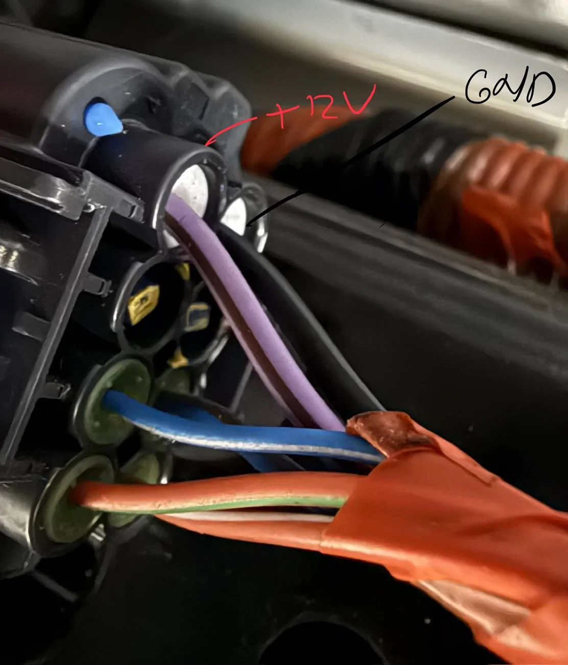

the part will come with a single 8 pin connector.
you need to verify that there are six wires running into the 8 pin connector and the purple black wires carry the 12v and ground.
it you have that it as simple as plugging in the connector.

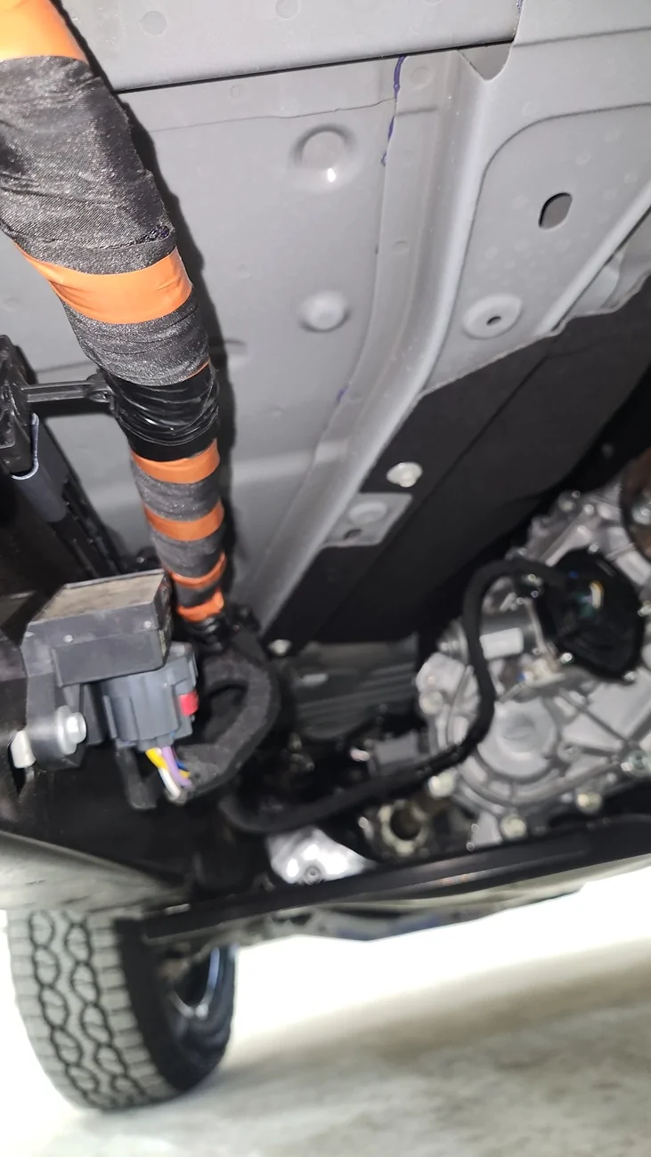

Thank you! Out of curiosity what is the smaller connector in my pic for then? The two side bed lights maybe (that I don't have lol)
Edit: I think the smaller plug is for the 120v if I had the inverter.

And it does look like it'll work! I see purple and black :)
small connector is bed lights.
you have the wires for 120vac, just no inverter for it.
