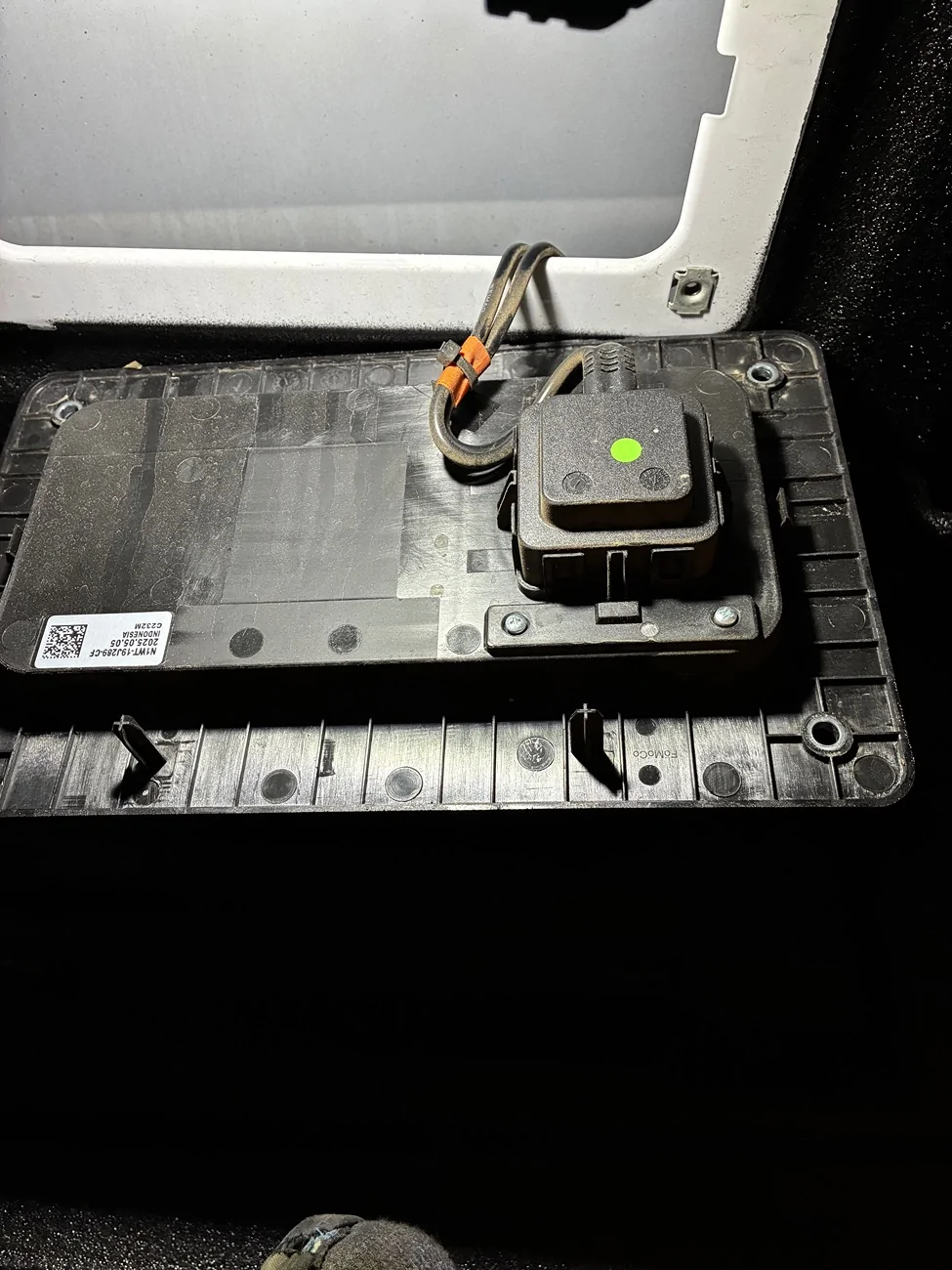

I am still trying to figure out if the panel you all are ordering will work on my OCT 25 Ranger XLT.
Here is the back of my current AC only panel. The connecting pin assembly is not immediately behind the panel as shown in Dino Jockey's post #41. My connector is down near the driver side area of the bed. See posts # 95. I must be missing something. If the replacement panel arrives with a pin connector assembly close to the back of the panel, I don't think it would reach to where my current pin connector assembly is. And, there is no pin connector assembly in the space between the bed wall and the driver side rear fender.
Am I just overlooking something?

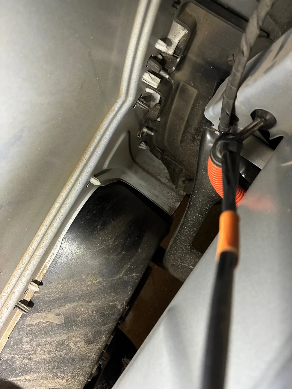

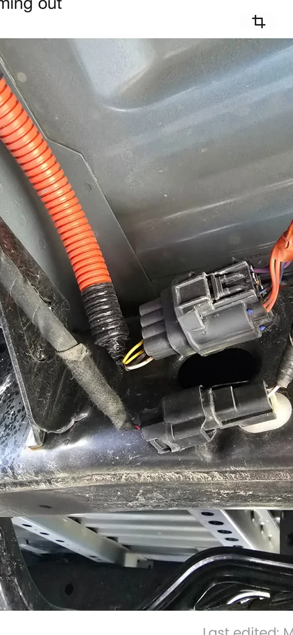

When you buy the new panel it will have a foot long or so connection that is designed to drop down behind the new panel and feed between the body of the truck and the frame. It then connects to the connector next to the frame. If you follow the wires down from your current panel, you should find a place where you’re able to unplug it from the connection. It should plug into the same connection.

It’s only the top connector in the picture I sent. Not the bottom connector. The one with the orange wires is from the back of the new panel that connects to the plug on the frame.
