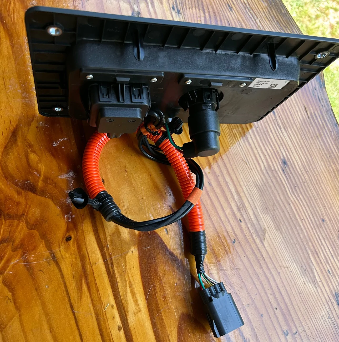

Also, where do the harness mount brackets clip in under the truck? I cannot find empty holes to push them into.
And the truck harness doesnt reach the plug for the power assy. I will have to do some adjusting to its mounts. I think the issue i have is the tow package harness on the bumper has everything mounted towards it so the harness is clipped that way

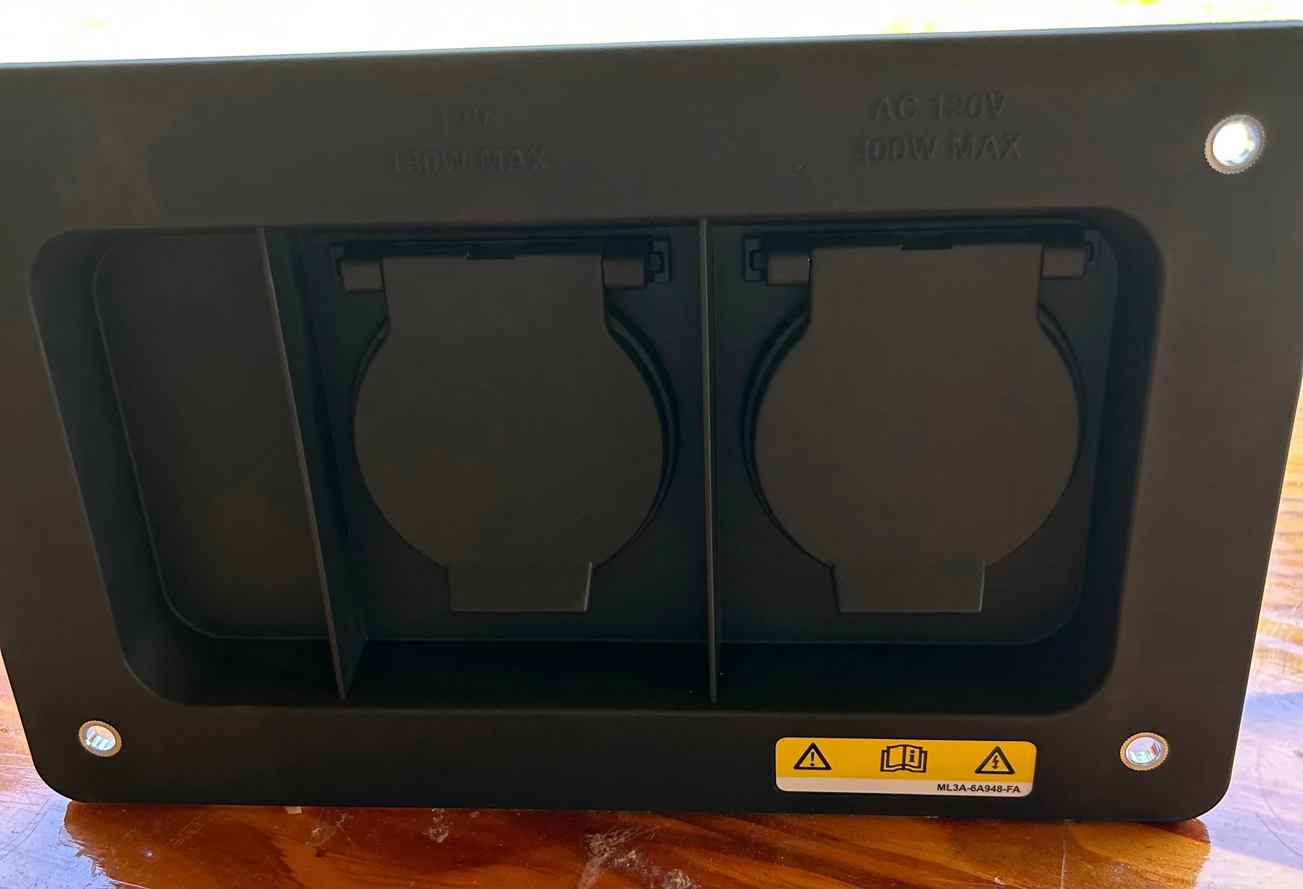

Update… rcvd my power panel. @PMK was correct…. Complete assembly arrived as expected.
Edit… less than 5 minute install..

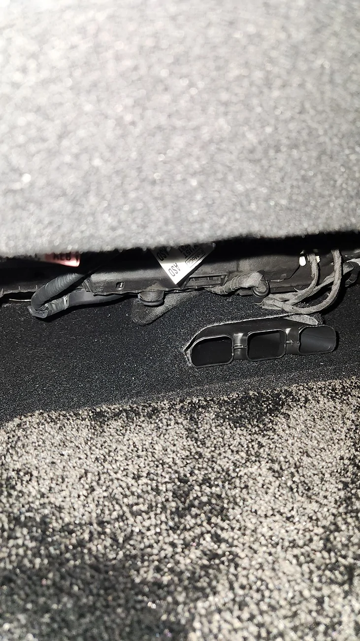

Do you have a harness under the driver rear of your truck that looks like the one in Post #70 ?
If you have that orange-jacketed harness then yes. But I would wonder if a truck without the 120v even has the harness? Can't tell you, but it is easy enough to take a look

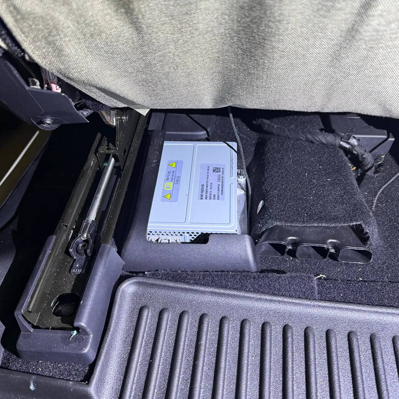

I’m guessing you don’t have the inverter under the driver seat. It would be interesting to know if you have the wiring in the cable or as stated any cable at all.

OK, now I understand why someone was posting about having an A/C plug....that was confusing me since I thought the whole thing was about adding an A/C plug lol....
I only have carpet to the left of my floor vents, no inverter. I just showered, my shop is filthy, and it's still hot out there. I'll check for the orange harness tomorrow but it's not looking good!

I have a 25 XLT FX4. I have the advanced tow package and the 120 volt AC outlet on the driver side of the bed. I also have the bed lights on either side which run when I press the button to the left of the steering wheel. When I took a peek behind my AC panel, I expected to find the wiring harness somewhere close to it. Instead the power cord snakes down and connects to a harness that is essentially behind the driver side rear wheel well. Yet, when I look at the images some have posted of the 2024 panel (e.g., post number 59), the power cord in the orange tubing does not appear long enough to snake down from the panel to the driver side rear wheel area. Is this just a perspective thing? Does the 2024 panel with the 120 and 12 volt sockets have a power cord long enough to meet the connector near the wheel?

Mine has no inverter so i geuss i have to run a wire from the battery to the panel for power.
