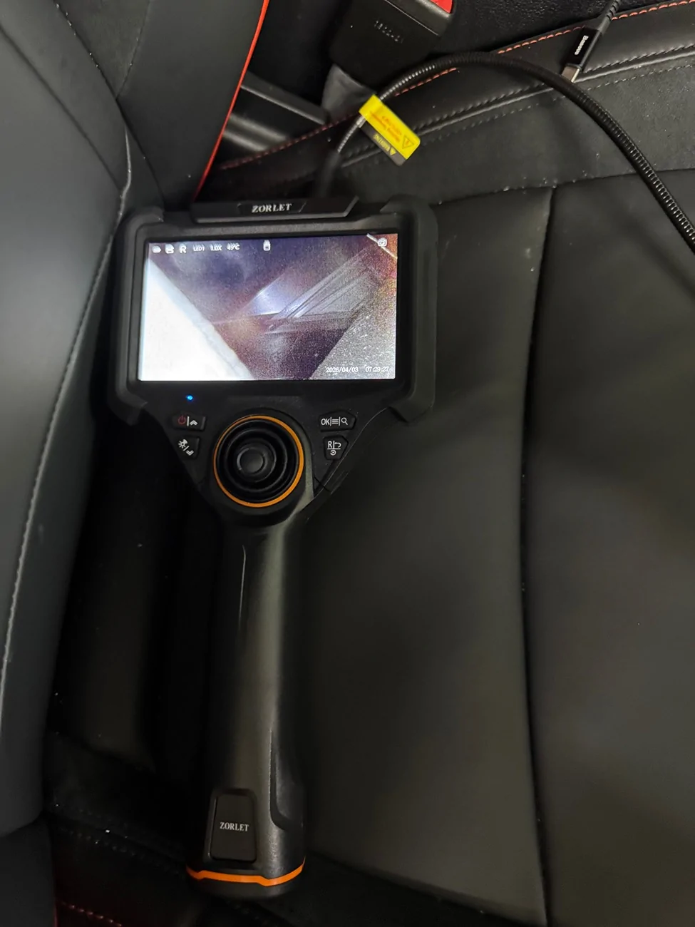

I think I finally found that loose screw or fastener, rattle I have been chasing.
After scoping every vent and pretty much every inch of behind the dash with my new toy, went back to trying the old fashion tapping and banging on stuff method. Lol 😂
Ford Ranger What's that noise??? IMG_5542
Finally think I found it or pretty sure this is it.
Likely a side effect of having the roof sound deadened a few months ago.
‘Something came loose or didn’t get put back where it goes. lol 😝
