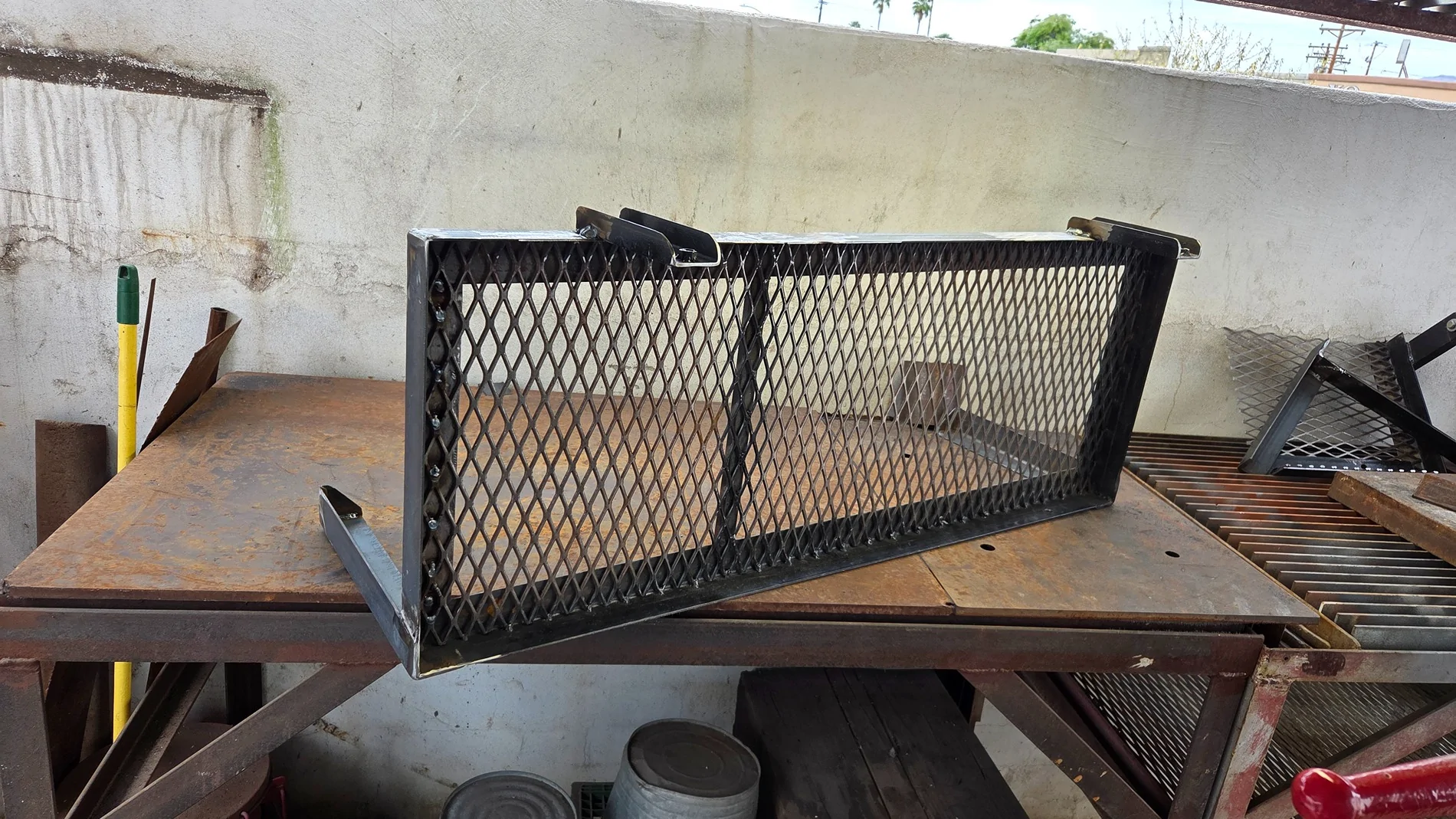

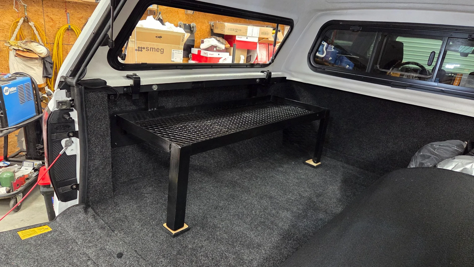

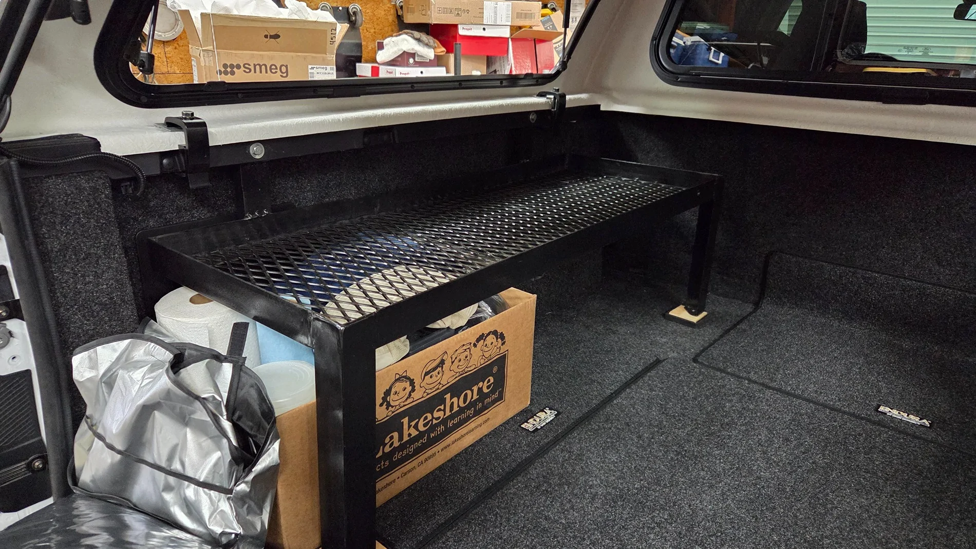

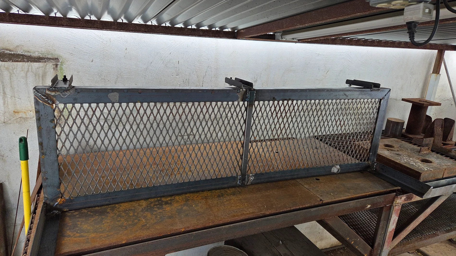

I made one of these for my Superduty and kept it after I sold it, decided to shorten it and freshen it up for the Ranger. 2" angle (1/8") and 9 gauge 3/4" expanded metal. (No I did not grind off the center support and re-center it, but I did relocate the two hangers that bolt up to the bed rail edge.).
Bed rail hangers are 2" channel with 3/8" nuts welded to them, they fit up behind the bed rail flange then get bolted thru from the inside.
The 9 gauge 3/4" expanded metal is perfect for bungee cord hooks. The rear leg also gives me something solid to hold onto when pulling myself into the bed.

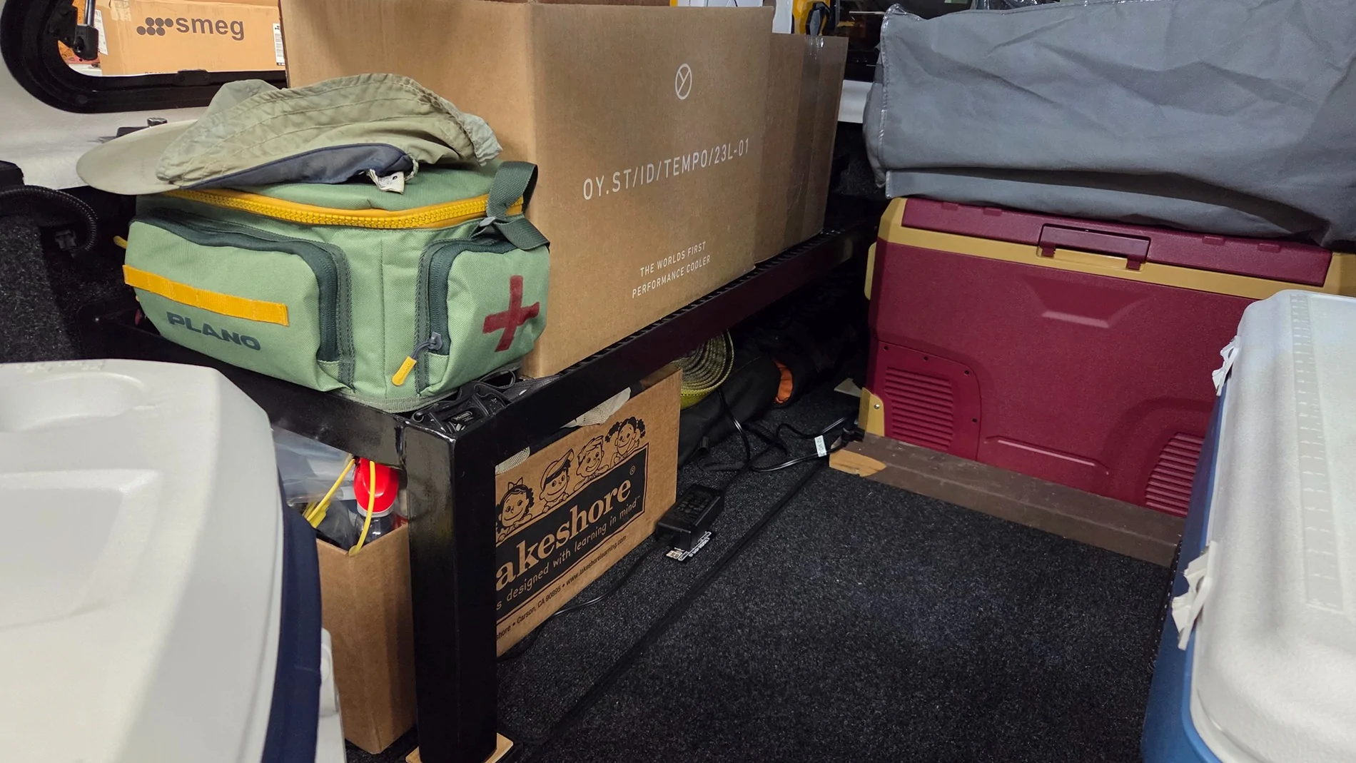

Comes in handy when loading a lot of stuff, really adds to the available space, plus you can access the stuff thru the side windoor without unstacking other stuff. I may do one for the other side. Wish someone would make aluminum ones. Leaving for a fishing trip tomorrow and I'm loaded to the "gills". I would post a pic but at this point you can barely see the shelf.

Looks great. The shelf will definitely help you organize stuff for your trip.

Looks good and is functional too. You have some fab skills for sure. Since you can weld, you could use a pop-rivet gun and make these with 2in aluminum angle from Lowes/Home Depot.
