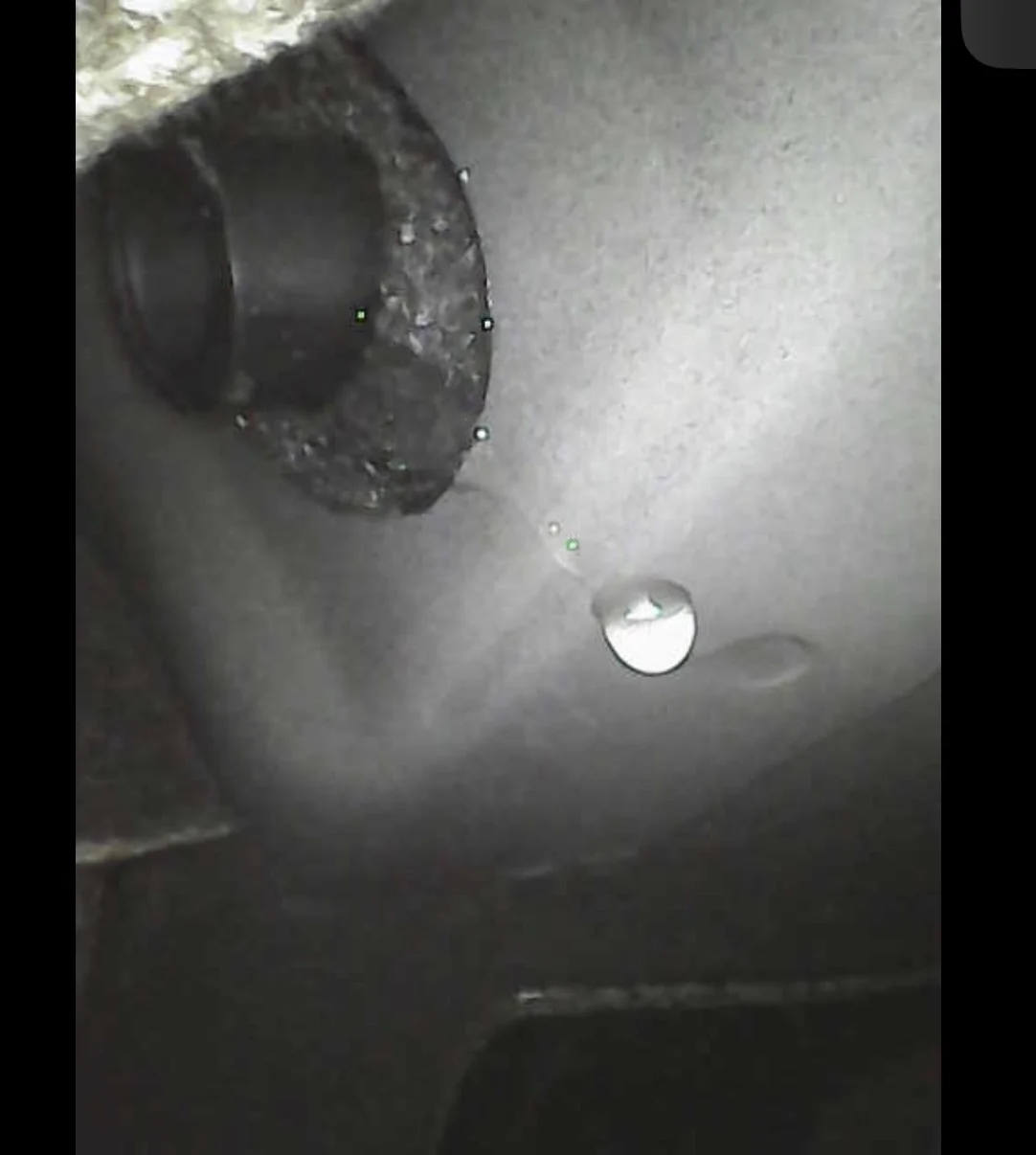

Can someone post a pic of it + road map directions, cause I'm having a tough time! I saw some posts and vids that say pass side firewall. I looked with flashlights, mirror, endoscope as best I could. Nada. Crawled underneath, etc. I would look for water drips, but there aren't any. Hence my worry that it is plugged. AC has musty smell. I've seen vids that push foam into AC drain line, but gotta find it first.
USA 2024 2.3L. It has FX4 skid plates that block view from underside. Do skids have to come off?
At least I found the transmission dip stick.
Thx!

I think it will be in the center of the vehicle. Sometime drips on the exhaust so you never see it hit the ground.

It dumps on top of the transmission.

Since your not the only one that has asked and wondered where it's hiding . I made a post with pictures on where it is, enjoy! :like:
