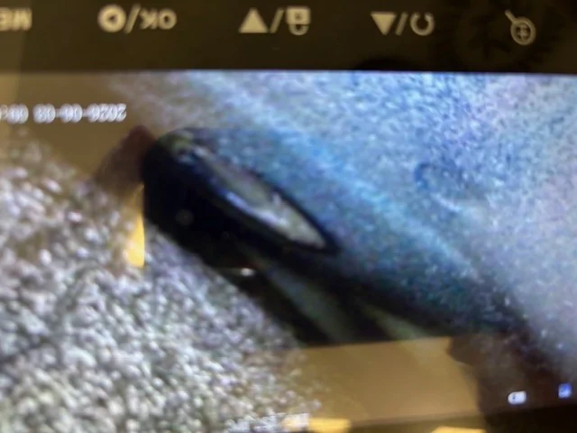

Hi, did you notice whether condensation water from the A/C is actually dripping under your Ranger onto the ground?
I am asking because I have a 2025 Ford Ranger Wildtrak X and I am dealing with a similar smell from the ventilation/A/C system.
The A/C cools properly, but even after longer driving with the air conditioning on, I do not see any condensate dripping under the vehicle.
My authorized Ford service checked the evaporator drain and told me that the drain outlet itself is not blocked.
However, they found that the condensate does not drain freely outside the vehicle, but falls into the area above the transmission.
In my case it seems to land on the transmission cover, which has a porous felt-like material.
Because this cover is closed/flush along the sides, the water may stay trapped there instead of dripping freely down.
My concern is that repeated moisture, together with heat from the engine/transmission area, could create a good environment for bacteria, mould, bad smell and possibly corrosion.
This may explain why disinfection of the A/C only helps temporarily, but does not remove the real cause.
Could you please check or confirm whether your Ranger actually leaves A/C condensate on the ground, or whether the water disappears somewhere above the transmission area?
