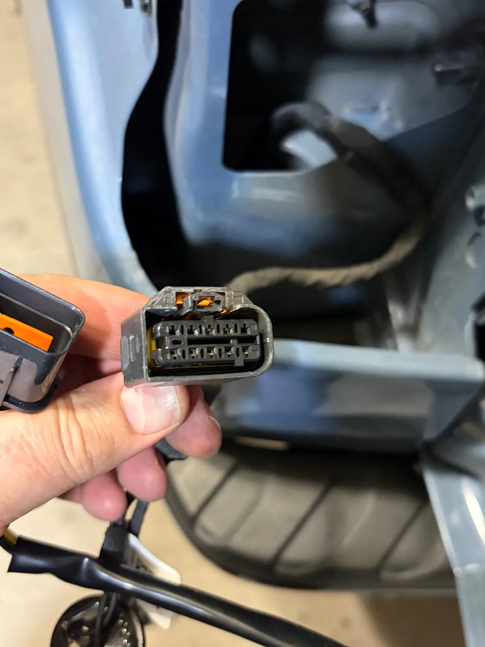

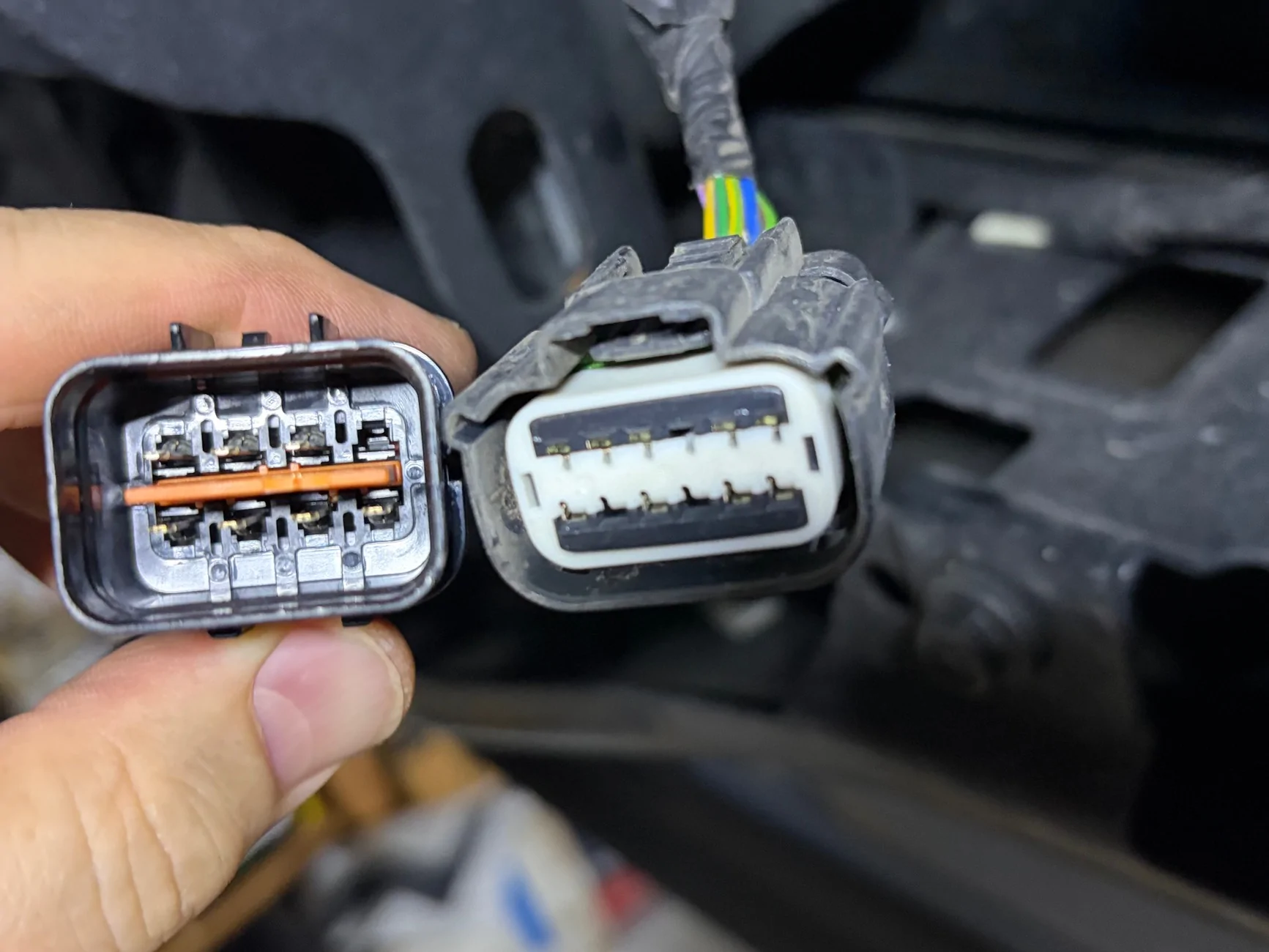

UPDATE:
received the taillights and went install them. found that the wiring harnesses they provided do not work with the OEM harness either at the taillights or by the bumper. Not even close. None of the plugs match up. so basically they wont work. put in to return them and the seller was quick to accept the return so I wont be out any $$$. too bad, looked like quality equipment but doesn't do me any good if they don't connect....

Ford Ranger Will these taillights work on 2025 Ranger XLT? IMG_0578
Ford Ranger Will these taillights work on 2025 Ranger XLT? IMG_0573
