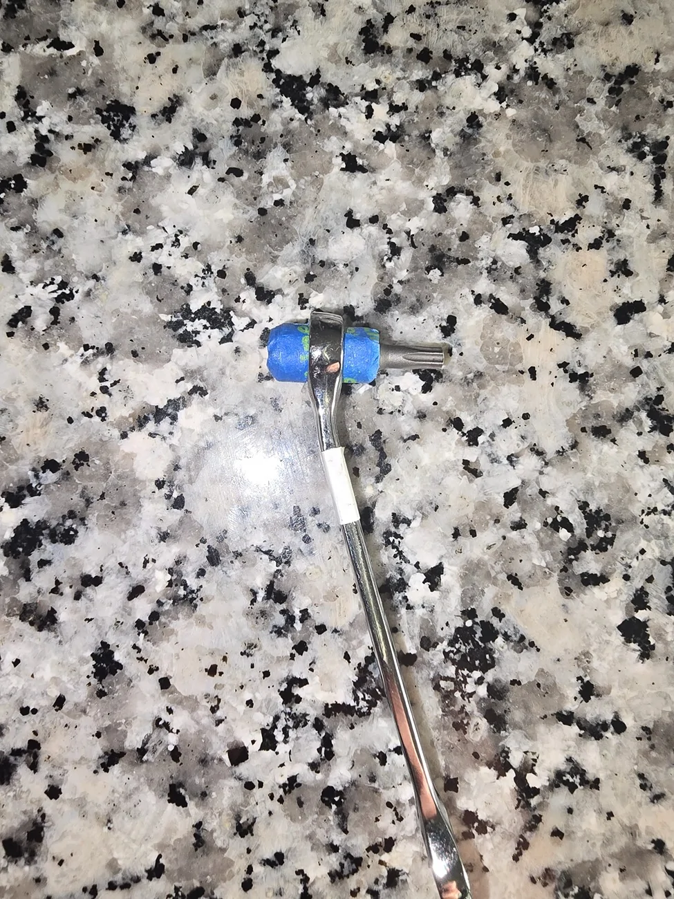

Yeah, that would work. This is how I rigged up my wrench which is similar to what you are describing. I did a quick wrap around this to bind the tape to itself.
