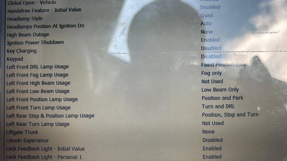

Also i messed around yesterday with Forscan changing the amber signal's to be enabled with the white /DRL's to see what it looked like and with that setup i had no signals, that was using a dual function amber led bulb i installed that has a brighter lumen output than the amber bulbs that came stock.
I changed the Forscan setting back i didn't care for the amber white mixed look but left the led's installed as signals.

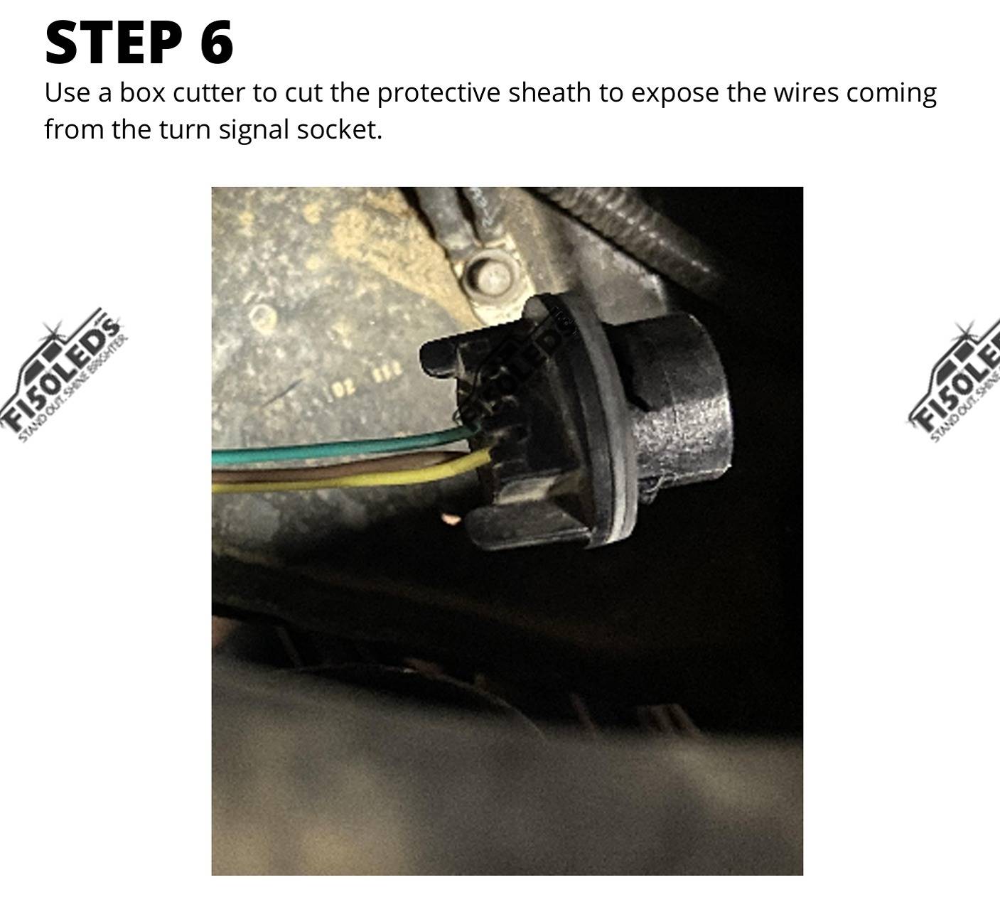

Yea maybe so, i know there's only two signal wires at that plug, maybe a third would be necessary for the park to be made 'live' and that would also require a different socket.
North american version socket is different from the other markets in the world, and as far as i know, it does have 3 wires instead of 2, i saw that in a install guide from a led bulb manufacturer (picture attached)
So, here in south america PY21W/BAU15S is the bulb socket for front turn, and for north america i'm not 100% sure about it but i believe it is 7443/T20
Ford Ranger Turn signals as DRL lights Captura de tela_27-3-2025_15044_cdn.shopify.com
