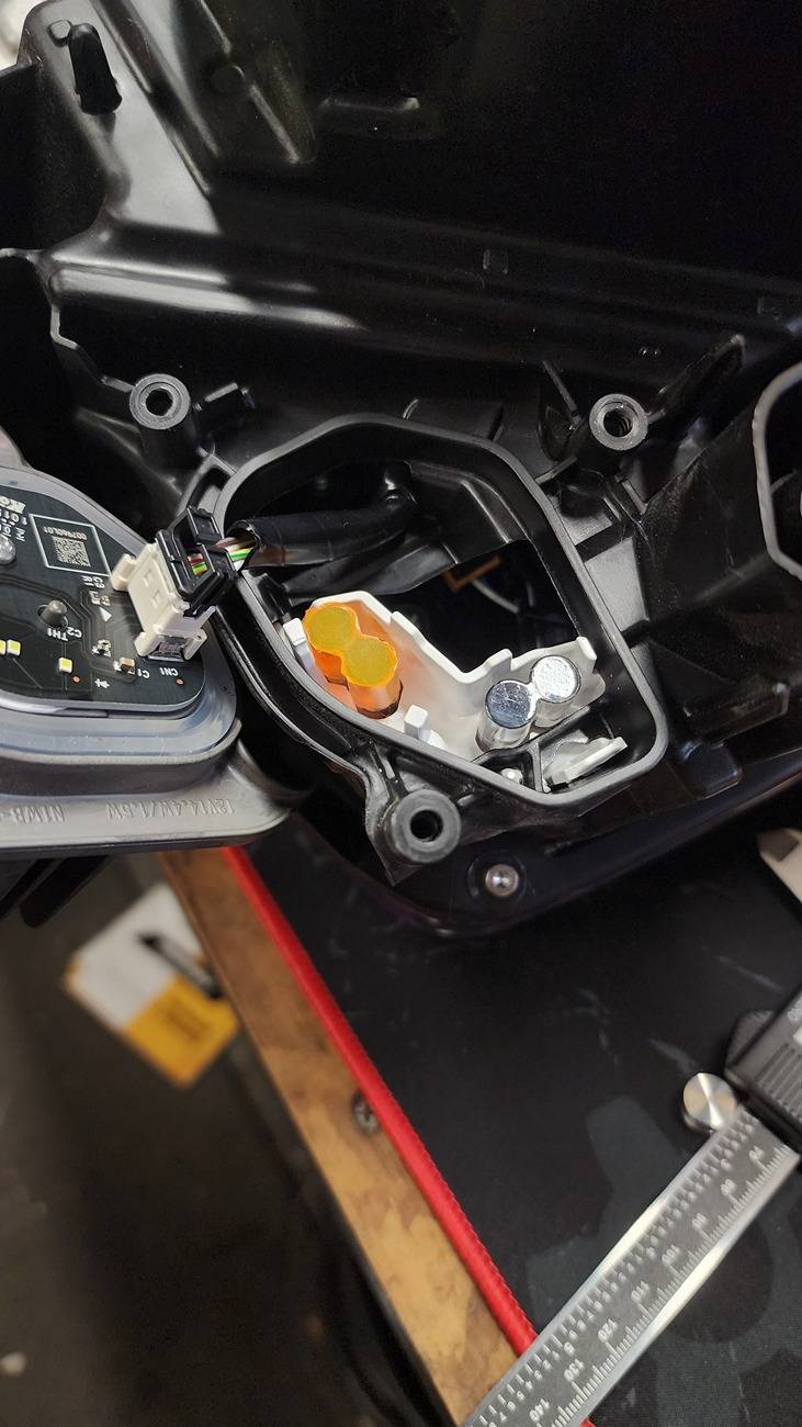

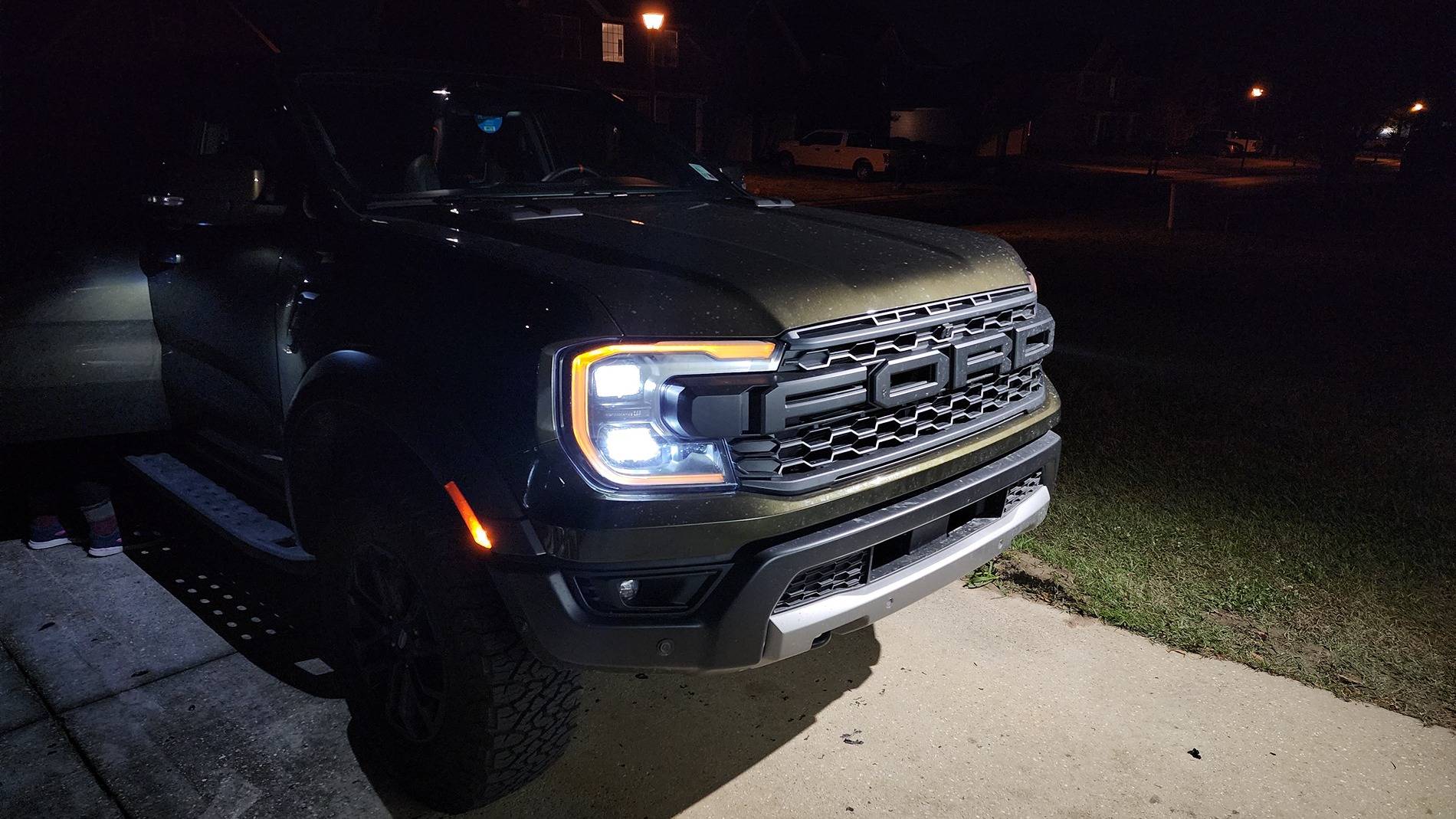

The truck is back together and I'm really digging it. I found that Oracal 8300 Transparent Orange only needed one layer and was a very close match to the rest of the Raptor line up. I did lose a little brightness compared to stock, but it's bearable until a new LED replacement option is available.
Ford Ranger Amber DRL Conversion Options 20250111_190120

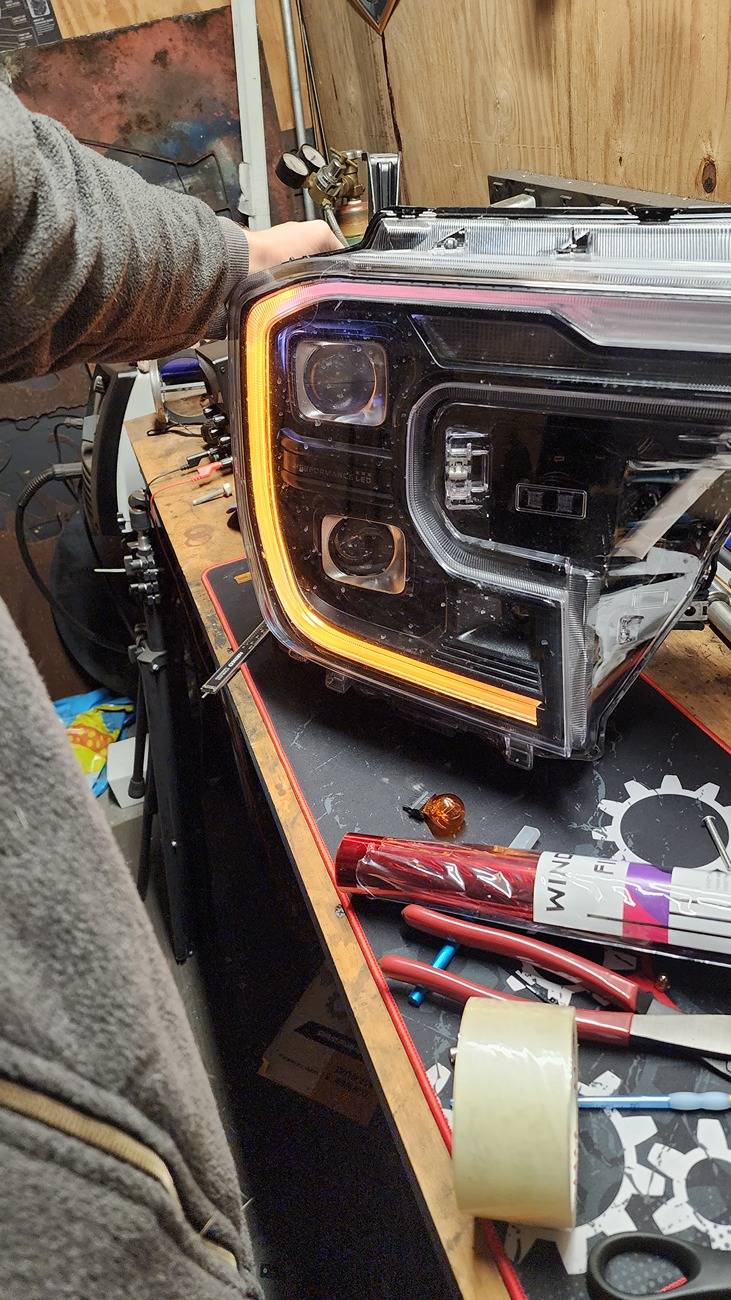

Basically what I did was cut small strips of the vinyl and apply to the sides of the light pipes using a small Allen wrench, then put the vinyl on the top of the tower and trimmed to fit
Ford Ranger Amber DRL Conversion Options 20250111_095249
My biggest gripe is that in my excitement to find a good match, I forgot to purge the headlight with dry air. Now that the temps have dropped outside, I've got a bit of condensation in the lights. I'm not looking forward to pulling these lights again just to dry them and fill with argon, but it's worth it for the pursuit of perfection! :crazy:

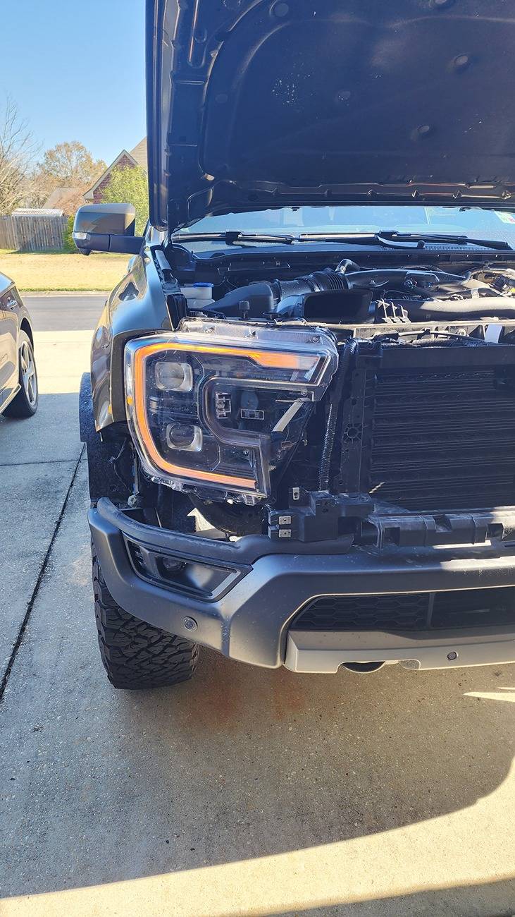

If you do pull them once again, can you post some pics of the removal/reassembly process? From the previous pics looks like grille and some trim/facia pieces have to be removed.
JustNick
JustNick
Nick
May 28, 2024
179
203
BatonRouge
Shelter Green Ranger Raptor
SOLA Motorsports
It's funny, I started taking pics the first time but got distracted by my buddy that came to help. I'll at a minimum take some pics and mark them up showing what needs to come off. It's generally in this order: the radiator cover, the grille, the inner fender liner, the fender flares, the lower painted fascia, loosen the front two bolts of the fenders, theres a trim piece below the headlights, and then finally the headlights come out. You can take that list of things off using just a trim removal tool, 7mm, 8mm, 10mm sockets and a Phillips screwdriver
