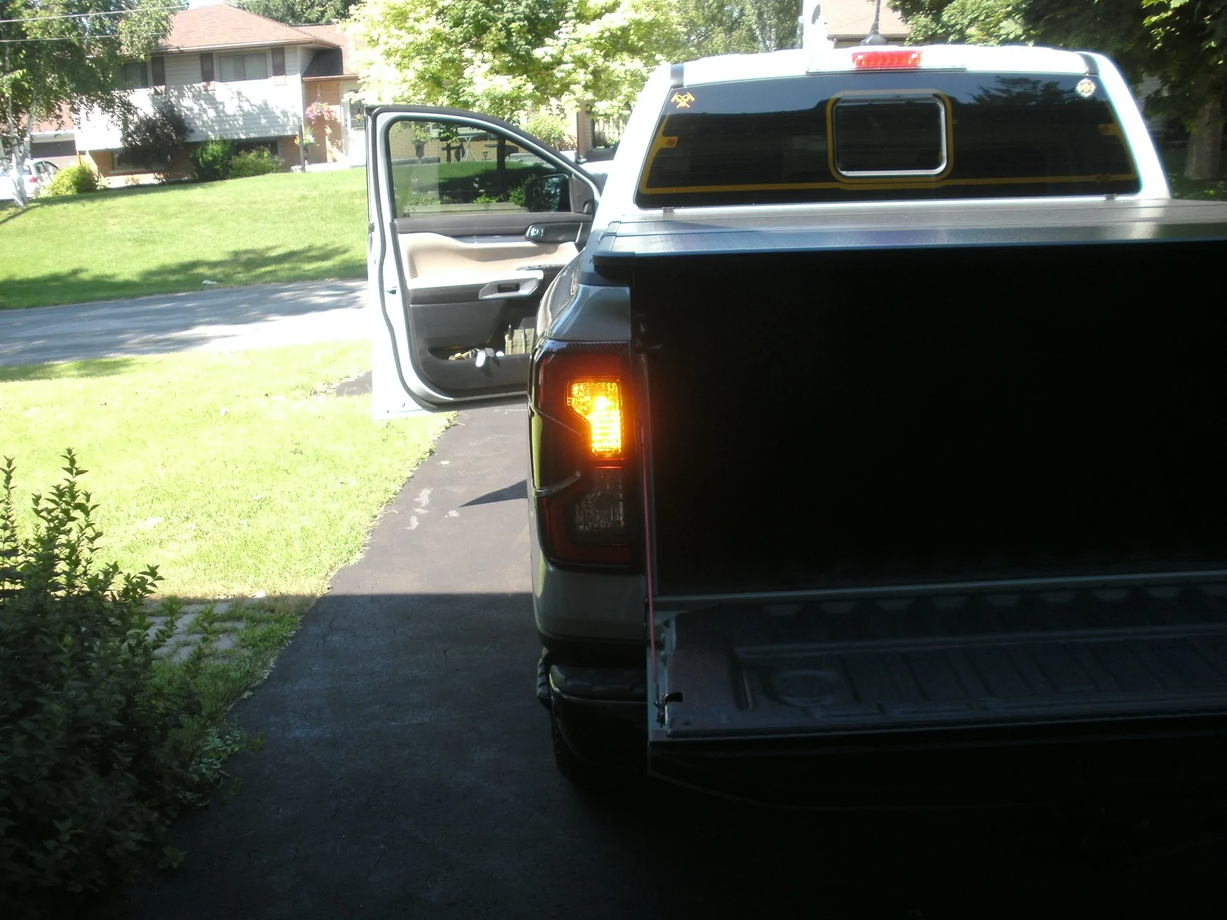

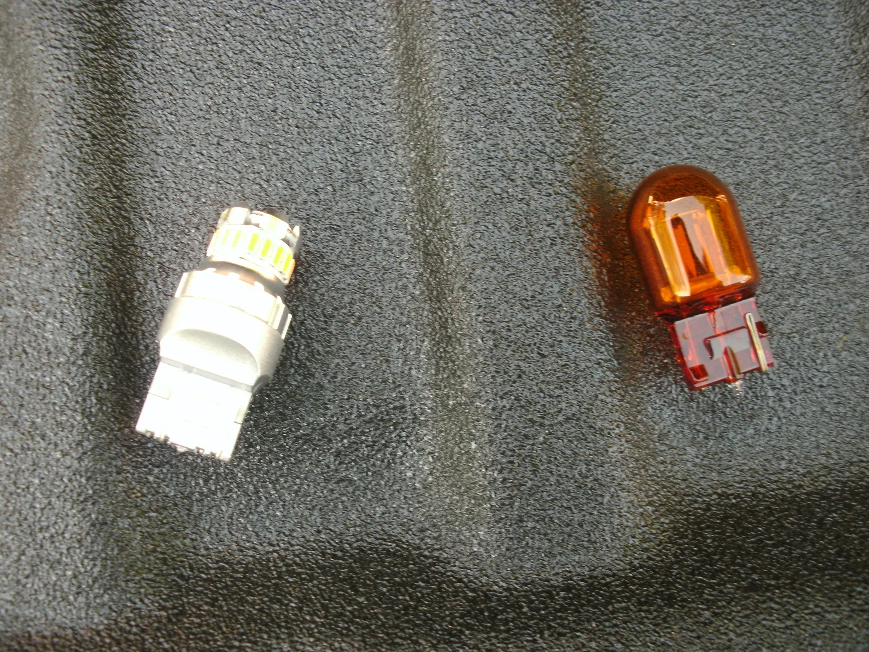

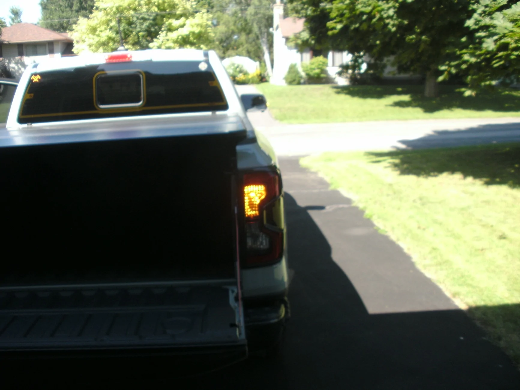

Only halogen in the Lariat are turn and reverse lights everything else in LED. I just replaced the turn signal as I am happy with reverse lights as they are only on a bit anyways.
LED on driver's side vs halogen on passengers side.

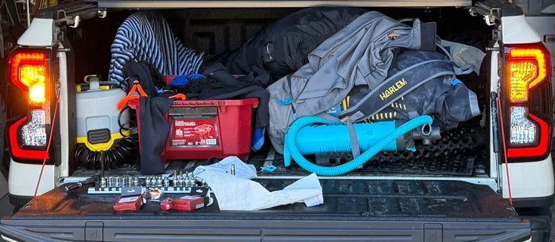

I did both. i didnt figure out how to photograph the back up lights until i had already changed them….

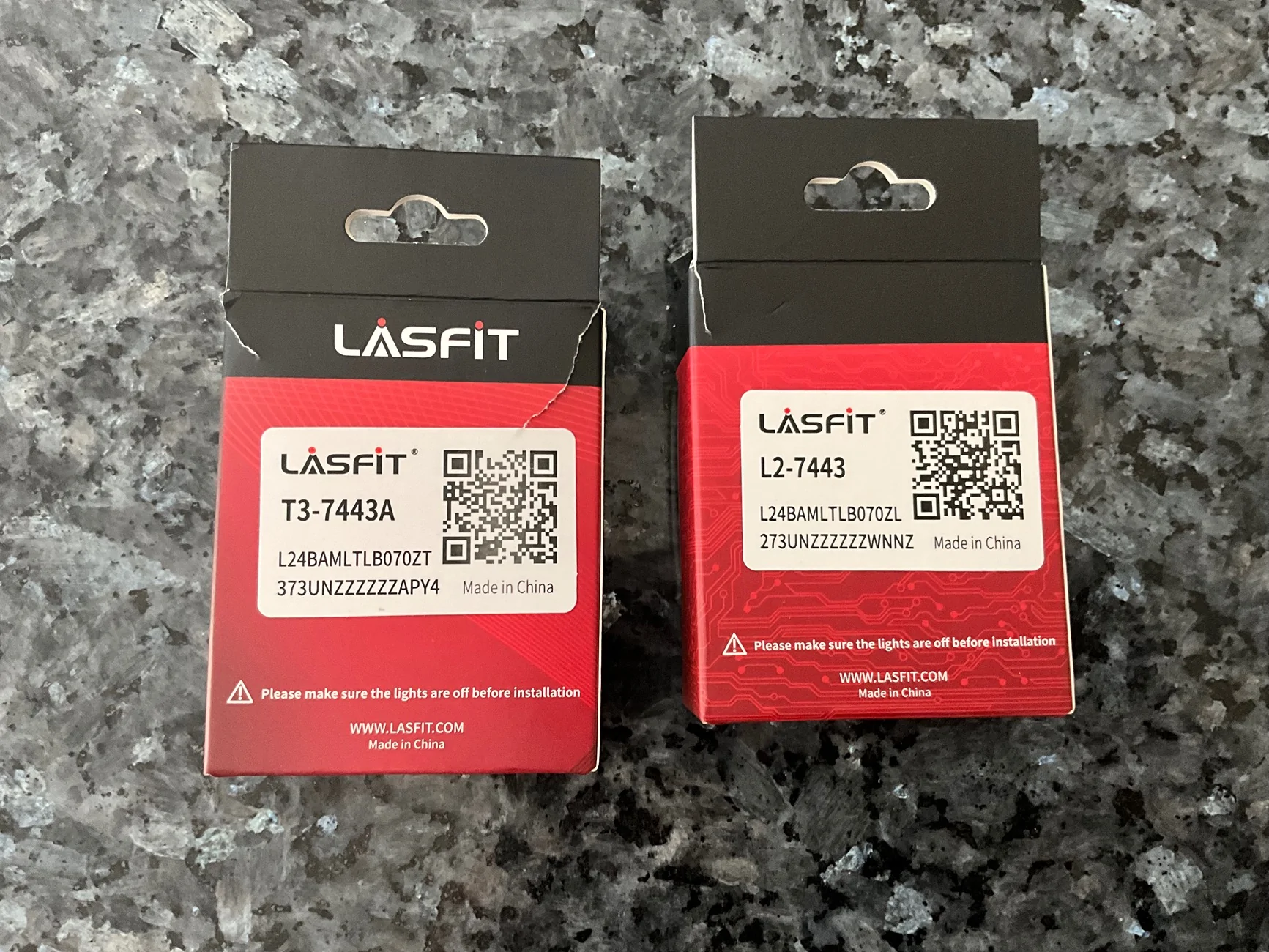

I went with the Lasfit for the Amber Canbus on the turn signals and the Auxito for the backup bulbs with the 7443 base.
