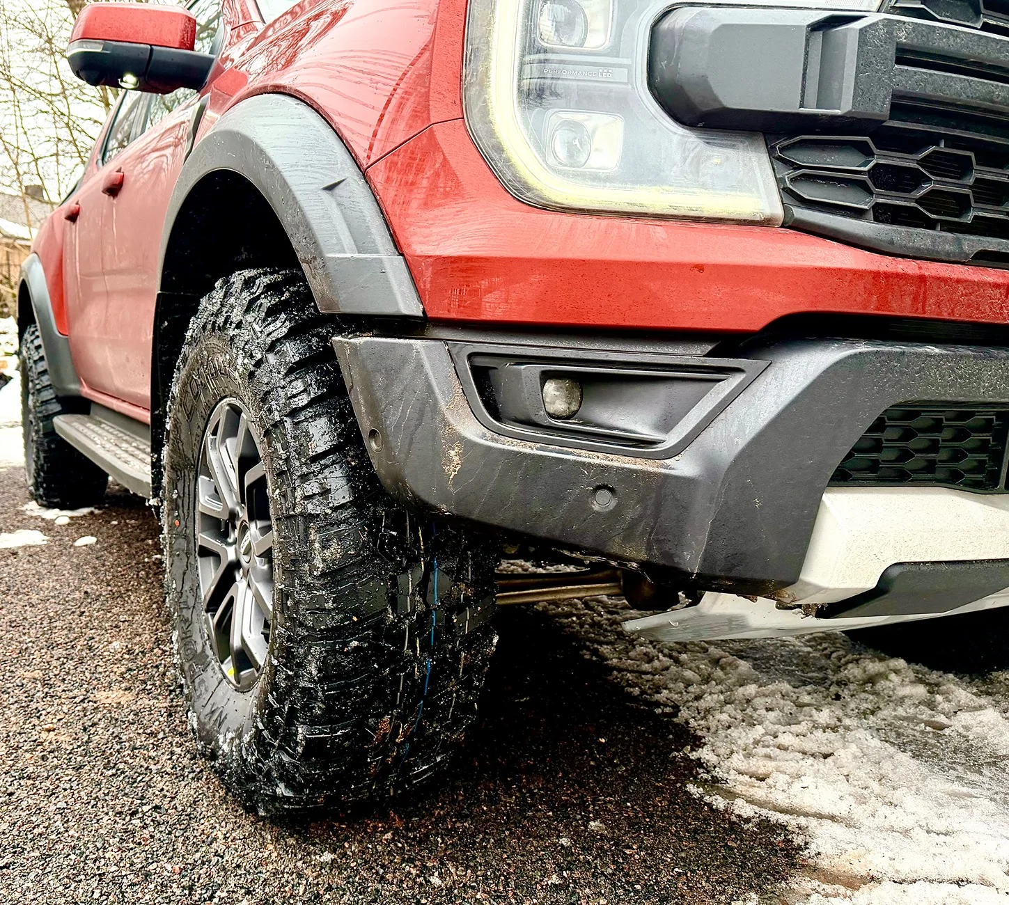

Yes, fits perfectly. I havew 315/70-17 with OEM wheels and lo lift. In US model, you may need to remove crash bar.

Pics if possible please!

So I guess in that case a 305 should fit well? I would really like to see a picture/comment of someone who did it.

Look through some of the wheel/tire threads. There are people who have or are running a 305 among a bunch of other sizes as well.
