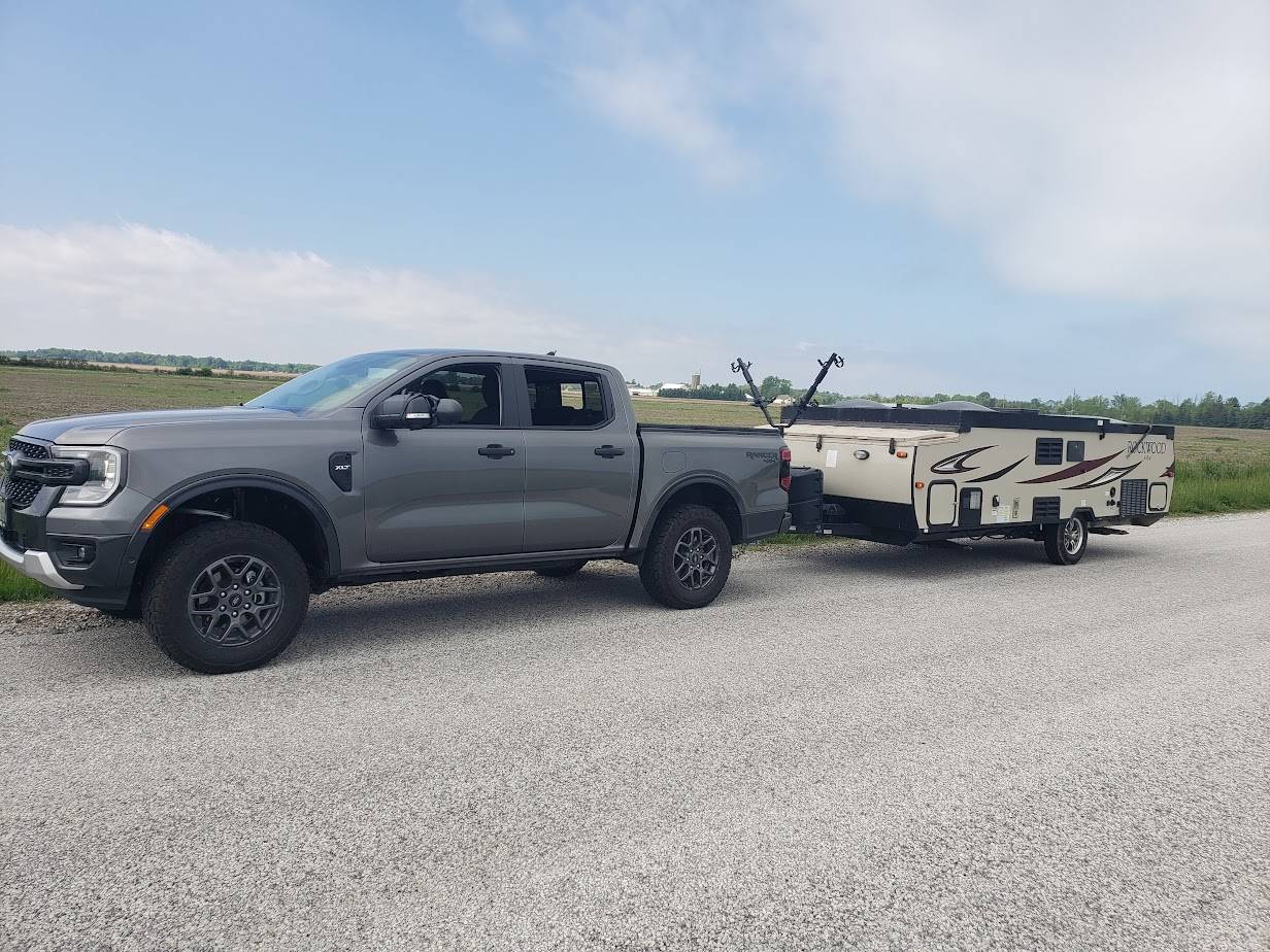

Well, I finally got out for a test tow before next weekends camping and Id say thats about the right amount of lift for me, she sits pretty much even with the A-frame in tow. Looks like a bit of squat in the pic, but shes pretty much bang on, tongue weight +/- 400lbs

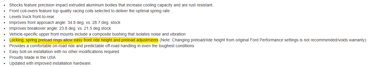

I have installed the Ford Fox Performance “Leveling kit” on my ‘24 XLT FX4. All parts and pieces fit perfectly. I netted 0” of lift/level. All suspension manufacturers I have viewed on the web are saying’19 to ‘24 except Raptor are same. I installed this kit on July 4 and am still waiting for a response from Ford. I have been in contact with a Ford performance technical assistant. He has not been very helpful, blaming engineers for not getting back to him. So much for upgrading from a puck to a system. Very disappointed with Ford Performance customer service at this point.

Aren't those adjustable? Did you change the preload for increased height?
It's confusing as the install instructions to tell how to adjust, and the description says adjustable, but then says adjustment not recommended and void warranty.
