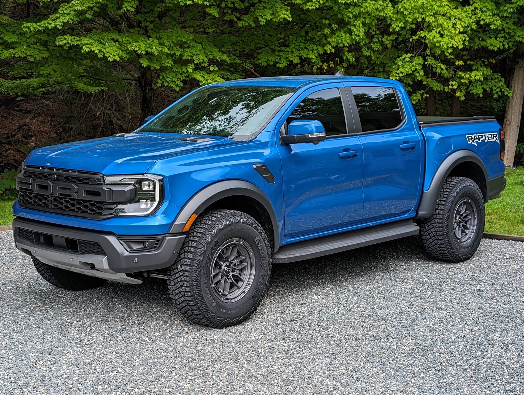

Tossed on a new set of wheels and tires today. RTR Evo 6 Satin Charcoal Wheels (17x9 +30) and Goodyear Territory MT 315/70-17 Tires.
The total setup ended up being substantially lighter than the factory wheels and tires. The wheels averaged out to 22.3 lbs, tires 53.5 lbs. Mounted and balanced weight was 76.6lbs compared to the stock non beadlocks at 85.2lbs.

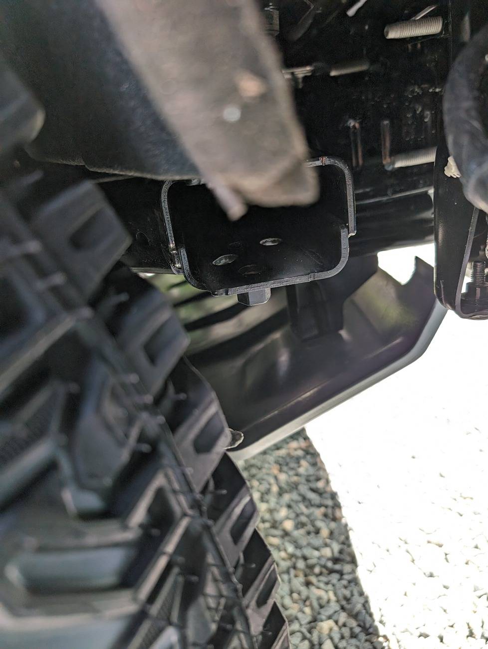

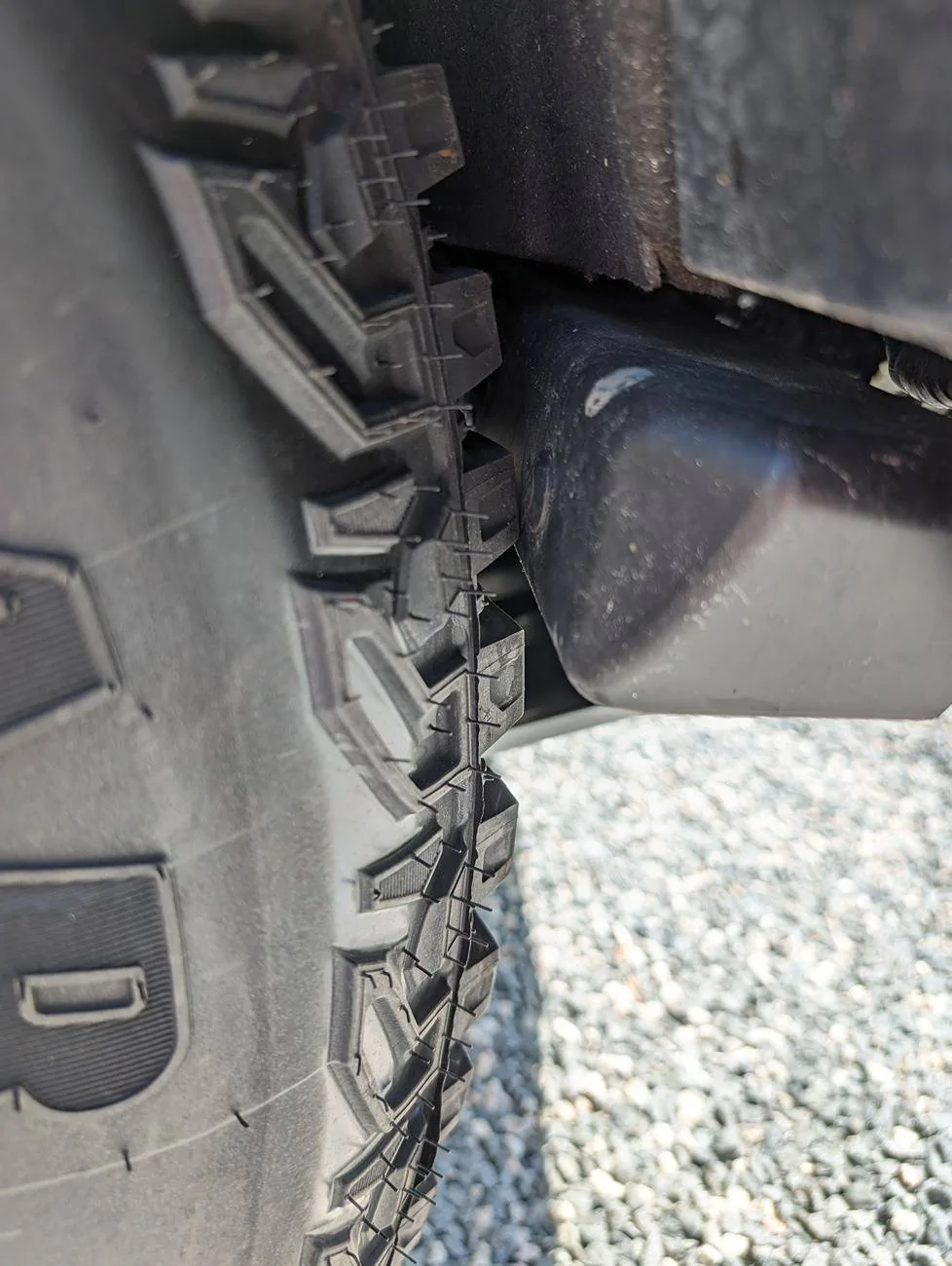

I ended up needing to remove the front crash bars for not to get them to fit, would rub on them on a level surface. I would not recommend running something this large without a lift in the front, I have a Foutz 2.5" collar on the way, but it will work for a few days of on road driving.

This is really interesting, thanks for posting. I'm curious to see the fitment once you get the 2.5" collars

Looks great!
Nice to see more +30 options.
‘I need to remove my front crash bars at some point.
‘Did you have any trouble getting them off?

The front crash bars weren't too bad to remove. The 2x plastic pins screw out to remove the plastic trim piece on crash bar itself. Then there are 2x 15mm bolts that thread in from the top (the nuts are welded on the bottom) a ratcheting wrench was able to fit between the bar and the fender liner to remove them. A little additional clearance was needed to slide them out so I removed the plastic trim from the inside corner of the bumper that's held on by 2x T30 and 1x 10mm bolts. Not sure it was needed but I also removed the large IP40 bolt holding the bumper to its mount to allow a little flexibility to pull the bumper up and forward while pulling the crash bar rearward and down.
I looked at removing the rear bars but that seems impossible without either cutting the bar or removing a body panel. There is not enough room to directly slide them out.

So then nothing needs to be cut to remove the front crash bars? They just unbolt and slide out?

Yes, I was able to slide the front's out without cutting anything at all. I plan to reinstall them after I get the perch collars

They ride great, very similar to the KO3's, maybe a little more road noise.
Do they poke at all?
They sit pretty close to even with the top of the flare. Slightest pit of poke maybe, I'll add a few more pictures.

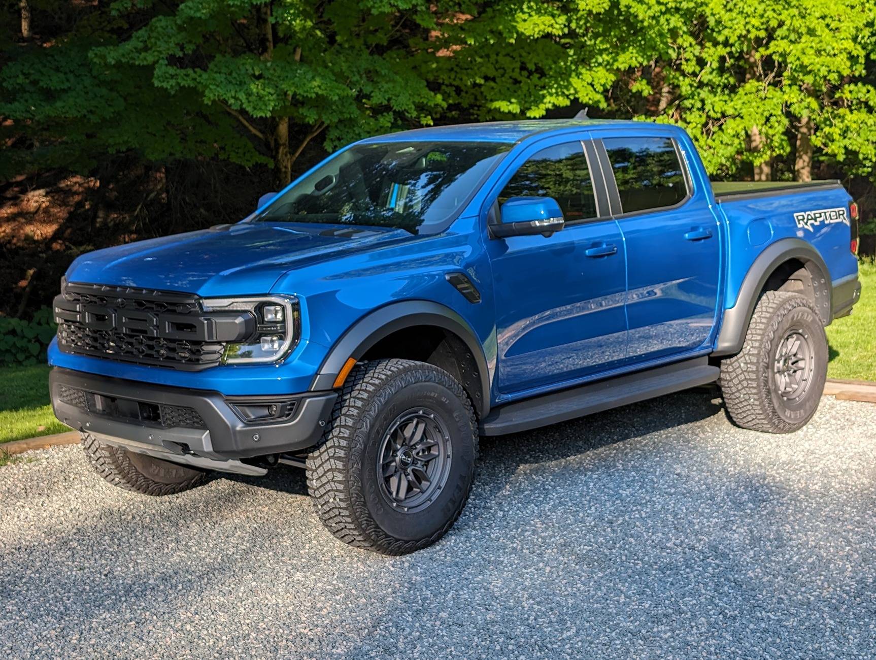

I installed Foutz 2.5" Collars in the front and 2.0" in the rear. I was able to leave the rear crash bars in place so far, I haven't been able to completely flex everything out to confirm full articulation clearance but for regular driving and fast unimproved roads I have not had any contact.
Before the Collars
Ford Ranger New (Lighter) Shoes for the Raptor: RTR Evo 6 Satin Charcoal Wheels (17x9 +30) and Goodyear Territory MT 315/70-17 Tires PXL_20240525_194435596 (1)
After:
Ford Ranger New (Lighter) Shoes for the Raptor: RTR Evo 6 Satin Charcoal Wheels (17x9 +30) and Goodyear Territory MT 315/70-17 Tires PXL_20240615_223347910
Picked up just about 2.5" in the front and just under 2" in the rear.
