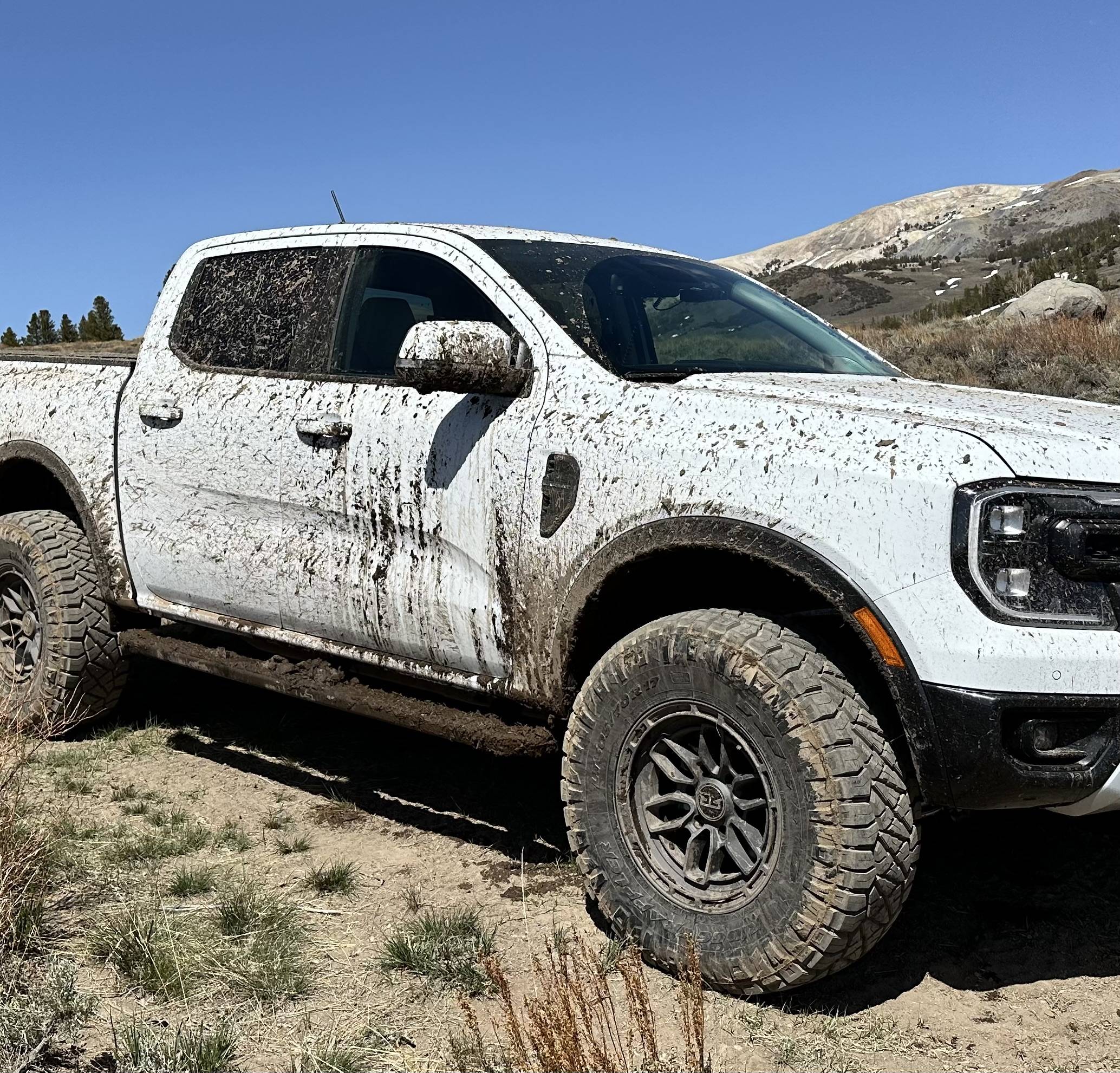

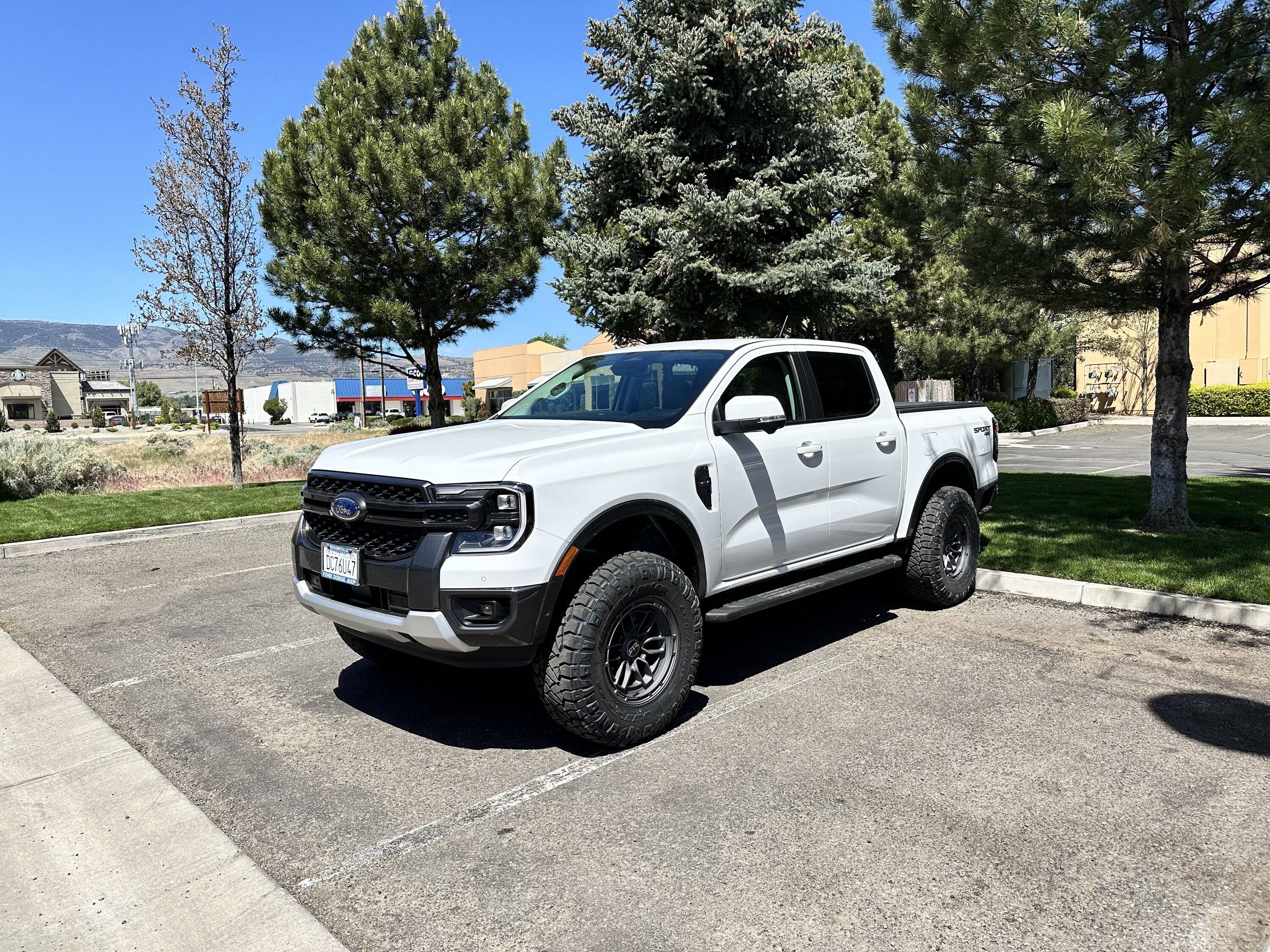

I put on 305/70/17 Nitto Ridge Grapplers on and was 5 MPH off at 60 MPH.
I used forscan, changed the to the correct mm and then did the PCM relearn. It worked perfectly. I read somewhere that it worked on the Raptor, but not sure about the Lariat, Well it worked like a charm and no codes or anything after the relearn.
Ford Ranger 34" Tires and Forscan for tire diameter change works on the 2024 Ranger Lariat! IMG_0912

What suspension mods and trimming did you do to fit them?

Looks awesome. How does the tire size affect the suspension articulation? Does the tire bottom out on the wheel well?

No issue with suspension articulation, the tires don't hit anything up high. I did got with 17x9 RTR wheel with a 0 mm offset.
The lift is a simple spacer lift Superlift 2024 Ranger spacer lift . Can't find any specific real lifts for the Ranger, but apparently the Bilstein 5100s fit, so I am wondering if the 6112 will fit?
All I needed to do was remove the crash bars and cut an inch from the back edge of the fender down low where the fender wrapped around the back of the fender. This is right in front and above the front of each side step.

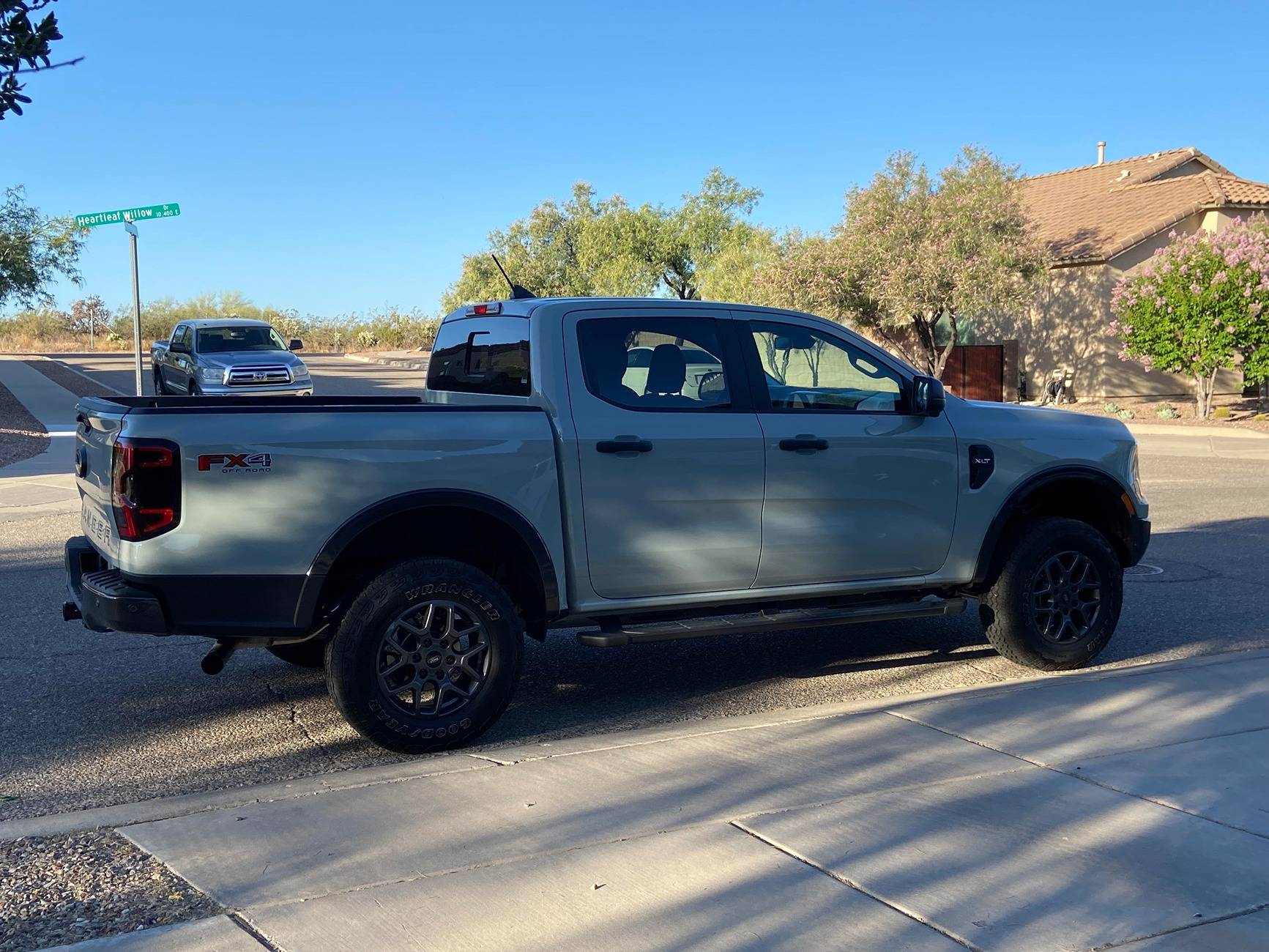

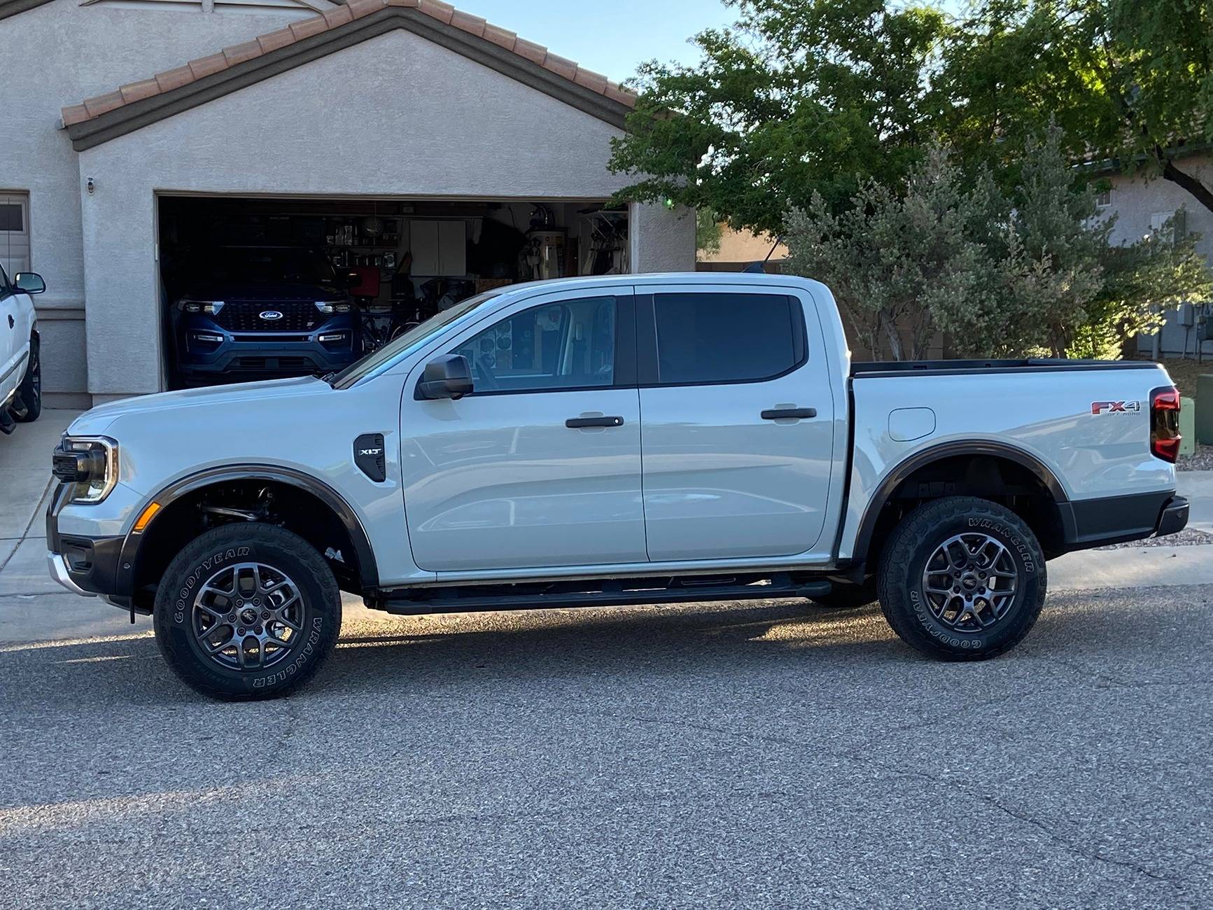

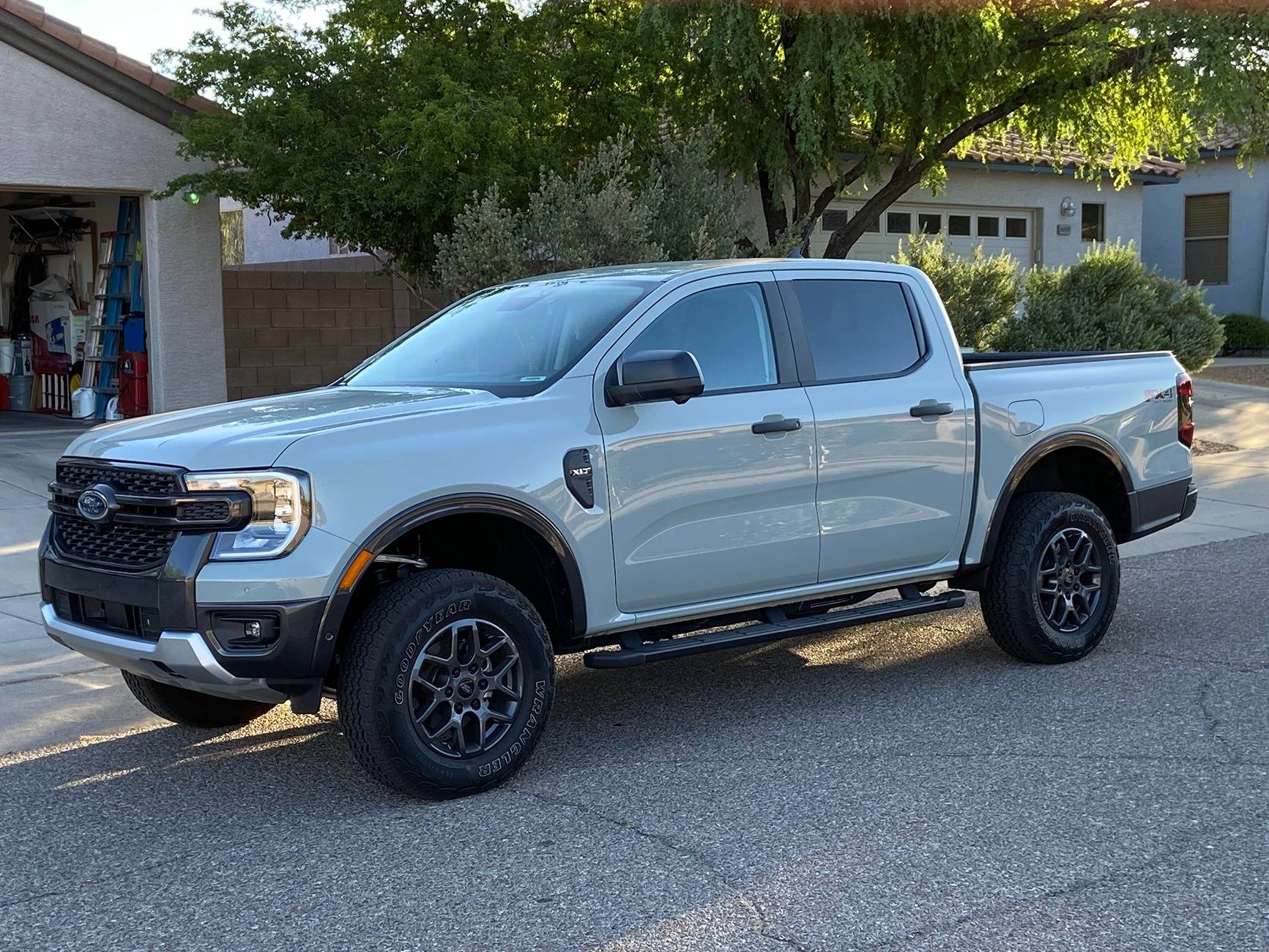

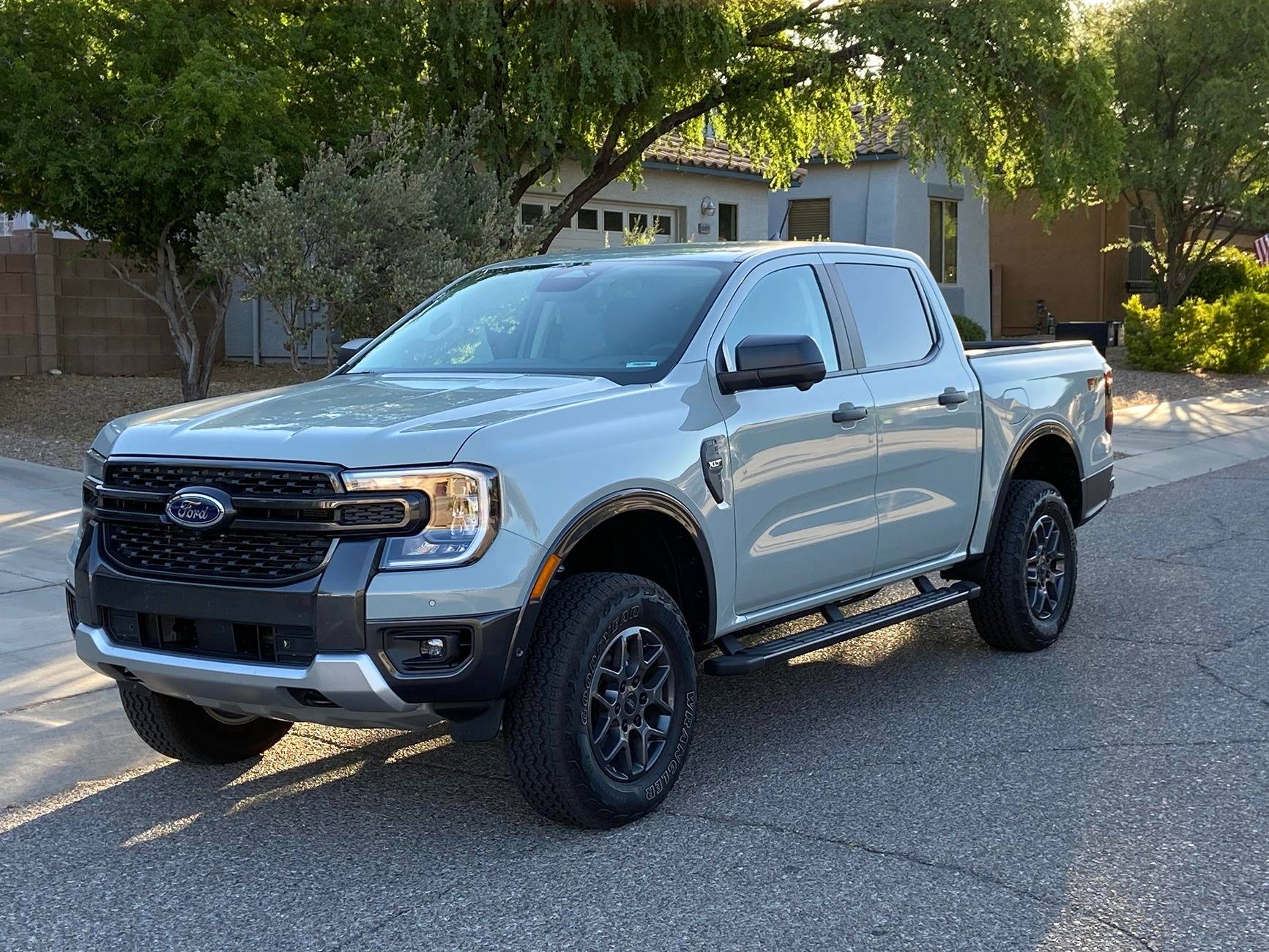

I can confirm Bilstein 5100 front struts/coilovers for the 4 door bronco will work on this truck and give about 2.75" lift. 5G ranger Bilstein 5100 may be too short to give much of a lift since the suspension is a bit different now on the 6G.
Great tip on the Forscan tire size change, I'll need that soon myself!
My truck with the Bilstein 5100 bronco struts:
Ford Ranger 34" Tires and Forscan for tire diameter change works on the 2024 Ranger Lariat! unnamed (3)
Ford Ranger 34" Tires and Forscan for tire diameter change works on the 2024 Ranger Lariat! unnamed (1)
Ford Ranger 34" Tires and Forscan for tire diameter change works on the 2024 Ranger Lariat! unnamed (2)
