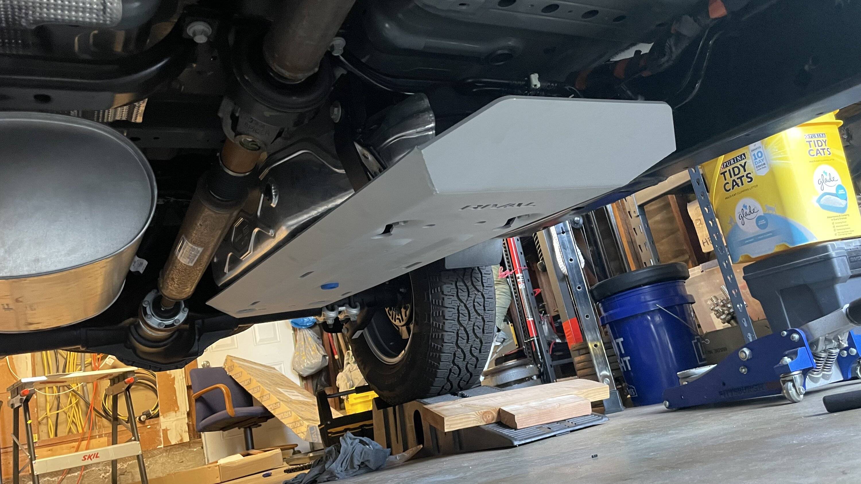

One of my worst fears is that while off roading a branch or jagged rock is gonna punch a hole of tear a gash in my buttersoft fuel tank. The plastic 'Plate' is basically a joke. I think the Bronco has a full steel one available, but that's gotta weight something.
Was looking around and found this @RIVAL 4x4 one. Aluminum and cheap at 300 Bucks. Rival apperently is well known. All i can say is it's a great plate at any price. Happy camper.
Ford Ranger RIVAL 4x4 Fuel Tank Skid Plate Installed IMG_2292
Ford Ranger RIVAL 4x4 Fuel Tank Skid Plate Installed IMG_2293

Nice! Did you have to drop the gas tank to install?
No. It sandwiches with the OE tank brackets/bolts on one side, and has some threaded long inserts for the inner bracket side. About as simple as can be. 12" piece of 2x6 jacks the tank up to take the weight off the tank brackets so you can slide the sistered side onto the OE bolt heads while pushing up the bracket for space. Other side i pushed to spread the Rival bracket a bit to get it to fully bite onto the new bolt, and held it by tightening. Took off the plastic barbie plate first, as per instructions. Took my time on a Saturday afternoon. Rear of the truck on ramps, me on a dolly. Easy peasy. Nearest i could find for torque was 35ft/lb for the stock brackets. not directly sourced. Rival bolts are same.

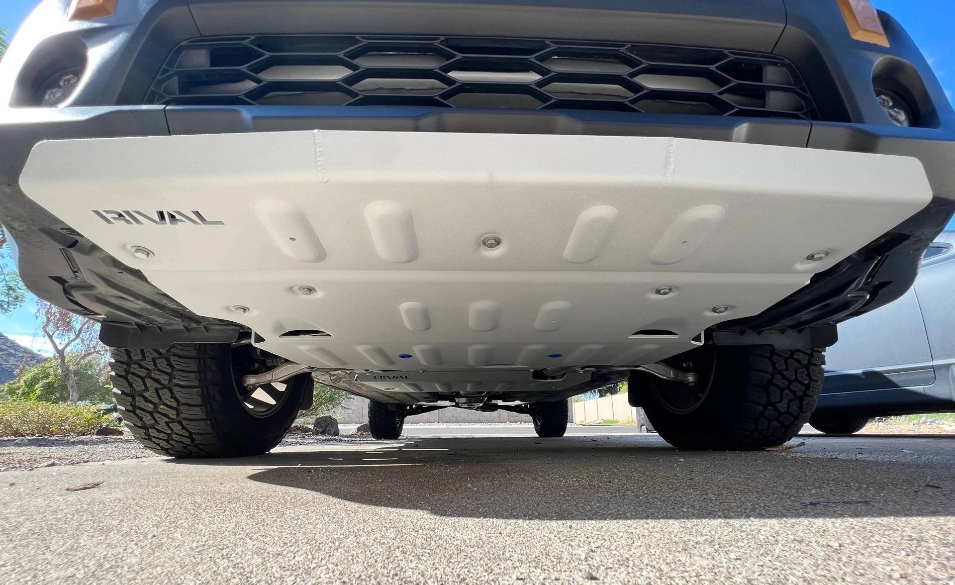

Installed mine today. Not sure what instructions you had but mine didn’t mention removing the stock plastic plate. It just states to remove any other aftermarket skid plates.
Front left, front right, and rear right brackets were smooth sailing. I did need a 12 inch extension to reach the rear right factory bolt but still easy.
Rear left on the other hand was a pain. Step 7 didn’t make it very clear that the M10 nut with wire assembly needs to go into the frame. Better pictures would have helped. Then once Iloosened and removed the factory bolt I couldn’t get the new M10 nut assembly with bolt to fit the cutout on the bracket. What I found worked best was the following:
  1. Place M10 nut with wire into hole
  2. Loosely thread M10 bolt into M10 nut with wire
  3. Bring bracket up and loosely thread OE bolt over bracket
  4. Swear to everything that is holy that the bracket is slightly off or factory hole for M10 nut assembly was not drilled within tolerance.
  5. Wrestle bracket into close enough alignment to place wood block at top of bracket and hit with mallet to force cutout to fall around the new M10 bolt/washer.
  6. Celebrate with a beverage
  7. Torque everything down to 35ft/lb

Quote: 'If equiped, Remove the factory skid plate OR other aftermarket skid plate'
Pic then shows a tank w/o the plastic plate.
I don't understand the problem you had. I had 2 issues, 1. the rear bracket top was not spread far enough apart to fully seat into the Rival bracket cutout for it. Since it was already fully seated on the other side, i just pushed up on the bottom of the bracket to get it to spread and seat on the other bolt. 2. the front threaded insert wanted to turn clockwise while i was tightening it. I just stuck the blade end of a large flat tip between it and the frame to get it to stay true. Oh, and 3. the slider hole in the front plate, the bolts aren't long enough to unthread them enough to get past the contour on the plate, so i just jacked up the whole plate and put the bolts in that way. About an hour i think? Glad you got your installed.
