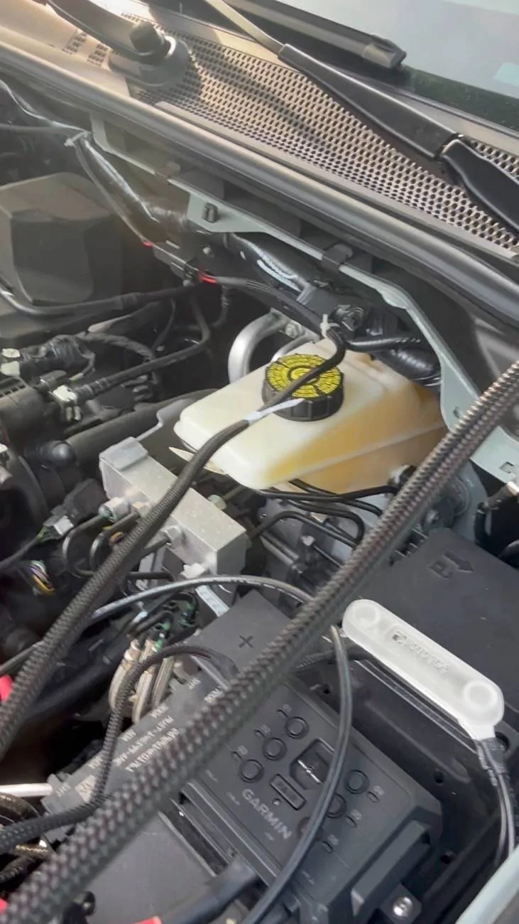

Im running a Garmin PowerSwitch and its pretty slick. I made my own bracket, but I am now going to add an inline fuse block (instead of separate inline fuses for each powered device), so I have a PowerTray on order. I mounted my bracket on top of the engine bay fuse box. Im really just learning by doing and coming at this without experience, but setting up the actual switches is stupid simple. I like that I have the ability to group different switches into a single custom function (this setup is quite a bit more complicated with something like an Auxbeam and would require additional relays).

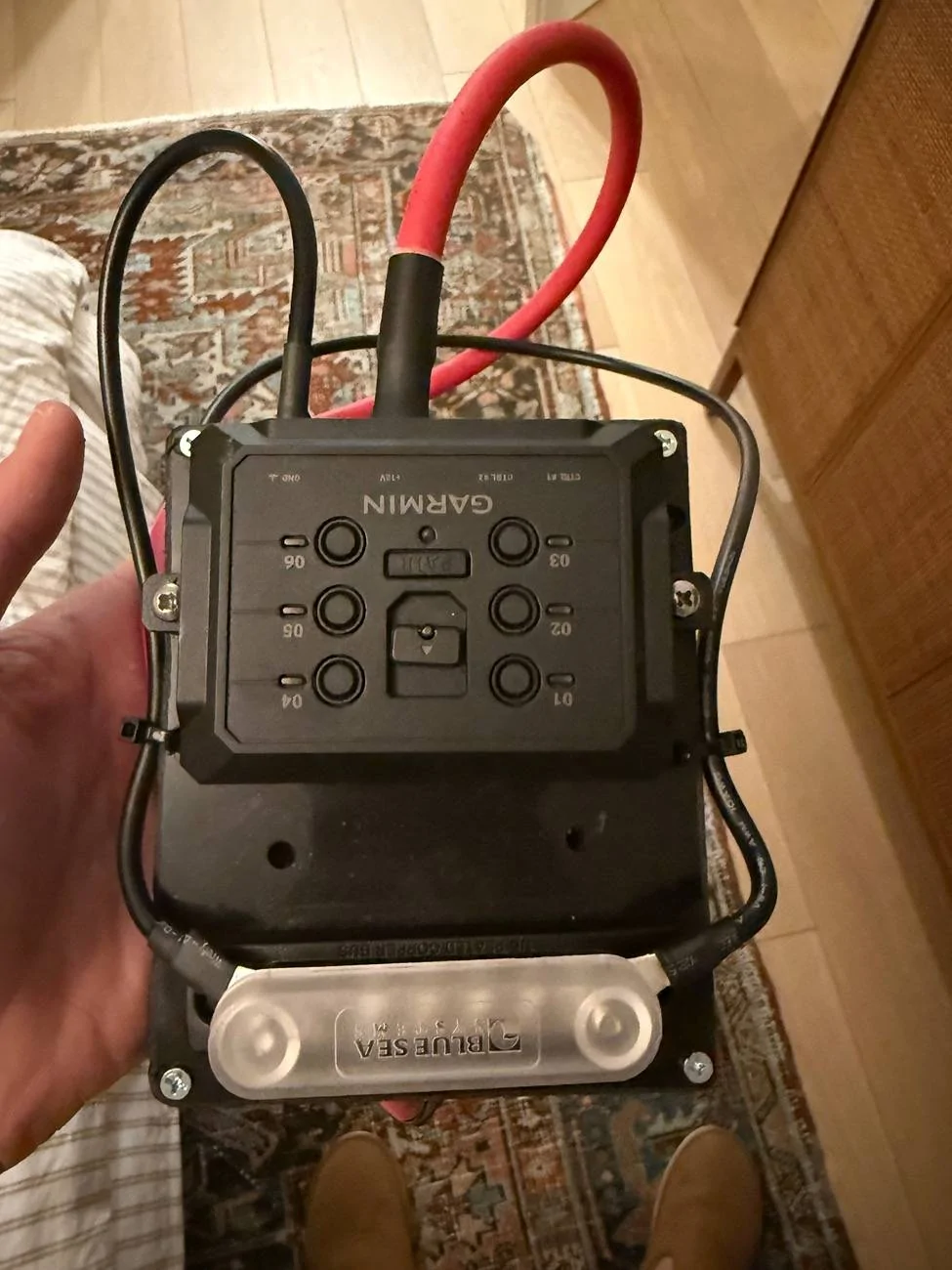

I was thinking about making my own bracket also. Can you send pictures of the bracket and how it mounts on the fuse box?
Sorry had to screen grab from a video but here are some low quality pics. I just used a 1/2” thick piece of plastic. I think the blue sea inline fuse block is going to clean things up a lot when I add it (not in the photos). Highly recommend using one of those (along with a ground bus bar) instead of a bunch of dangling inline fuses.
