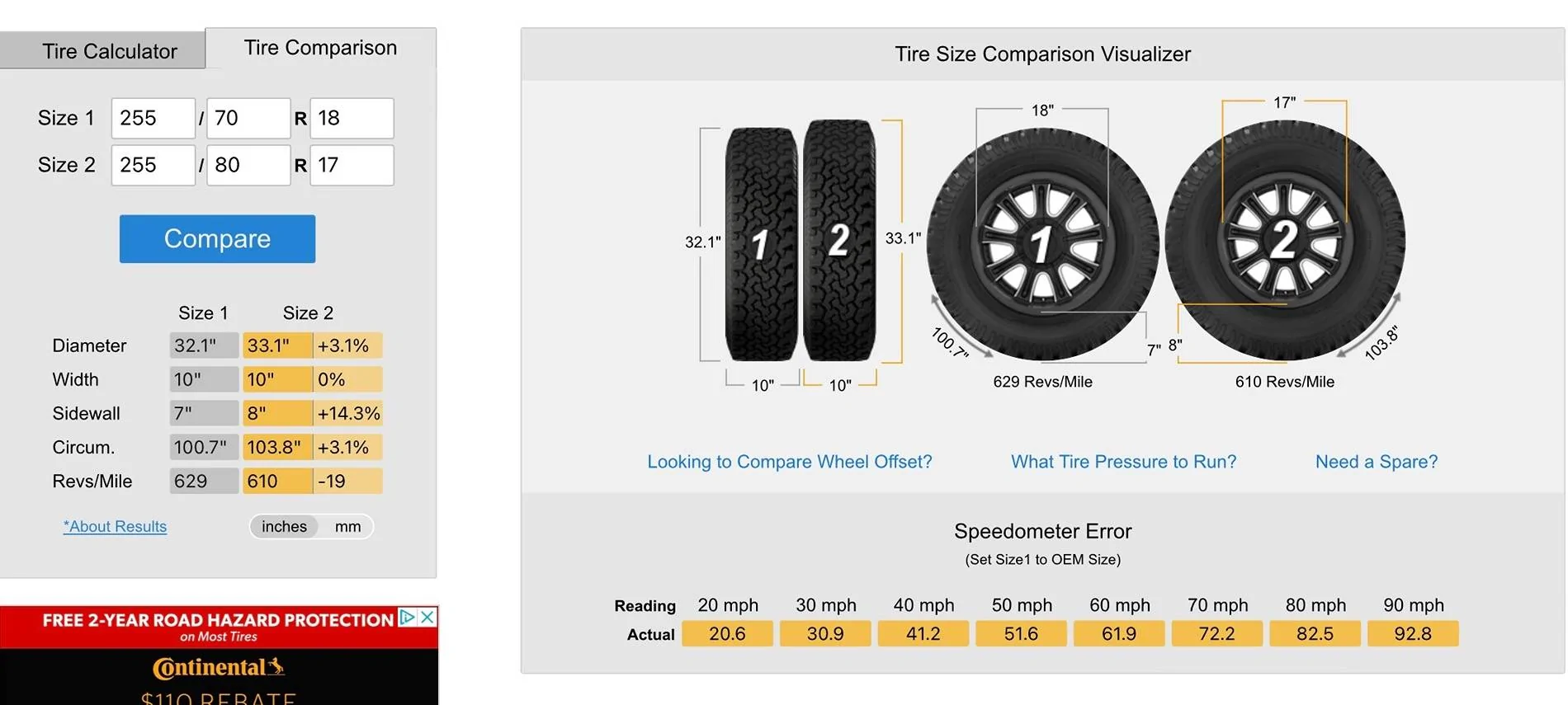

I have a Lariat FX4 with stock wheels and 255/70/r18 wildpeak a/t4w’s and they don’t rub at all. They are the same* diameter as yours (32.1”).
*correction - yours are an inch taller. The 2in lift you are planning should fix that.

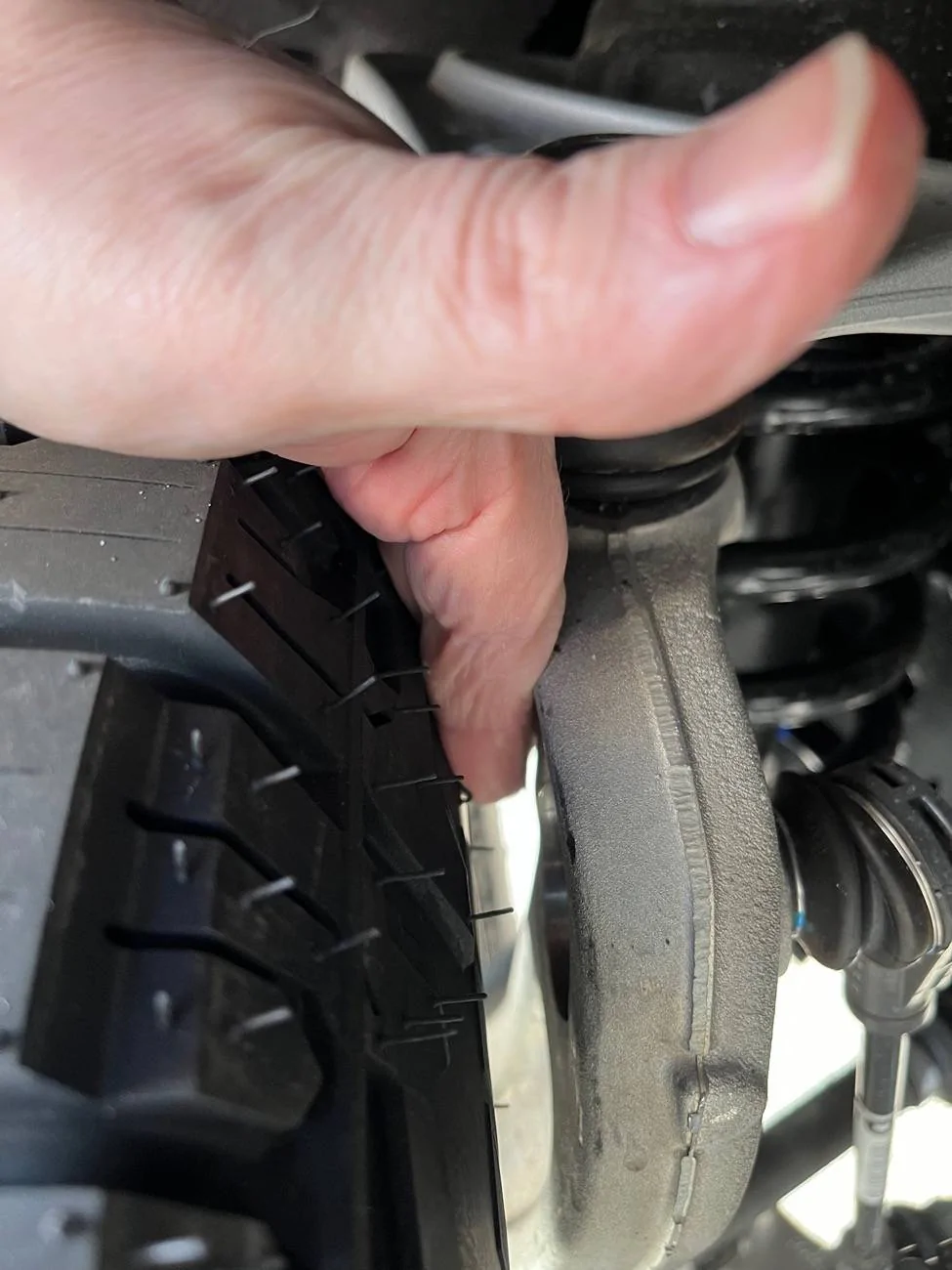

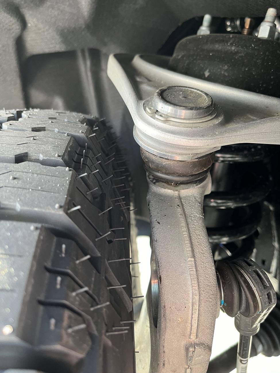

Its because of the offset. To clear large tires you want to get as close to the control arms as possible without rubbing.
Well, it is close… finger space close…
Ford Ranger FX4 Lariat (2” Level) with Falken Wildpeak A/T-4 255/80/R17 on Icon Rebound 17x8.5 +25 IMG_1126
Ford Ranger FX4 Lariat (2” Level) with Falken Wildpeak A/T-4 255/80/R17 on Icon Rebound 17x8.5 +25 IMG_1125

I think his size are a true 33" tire
