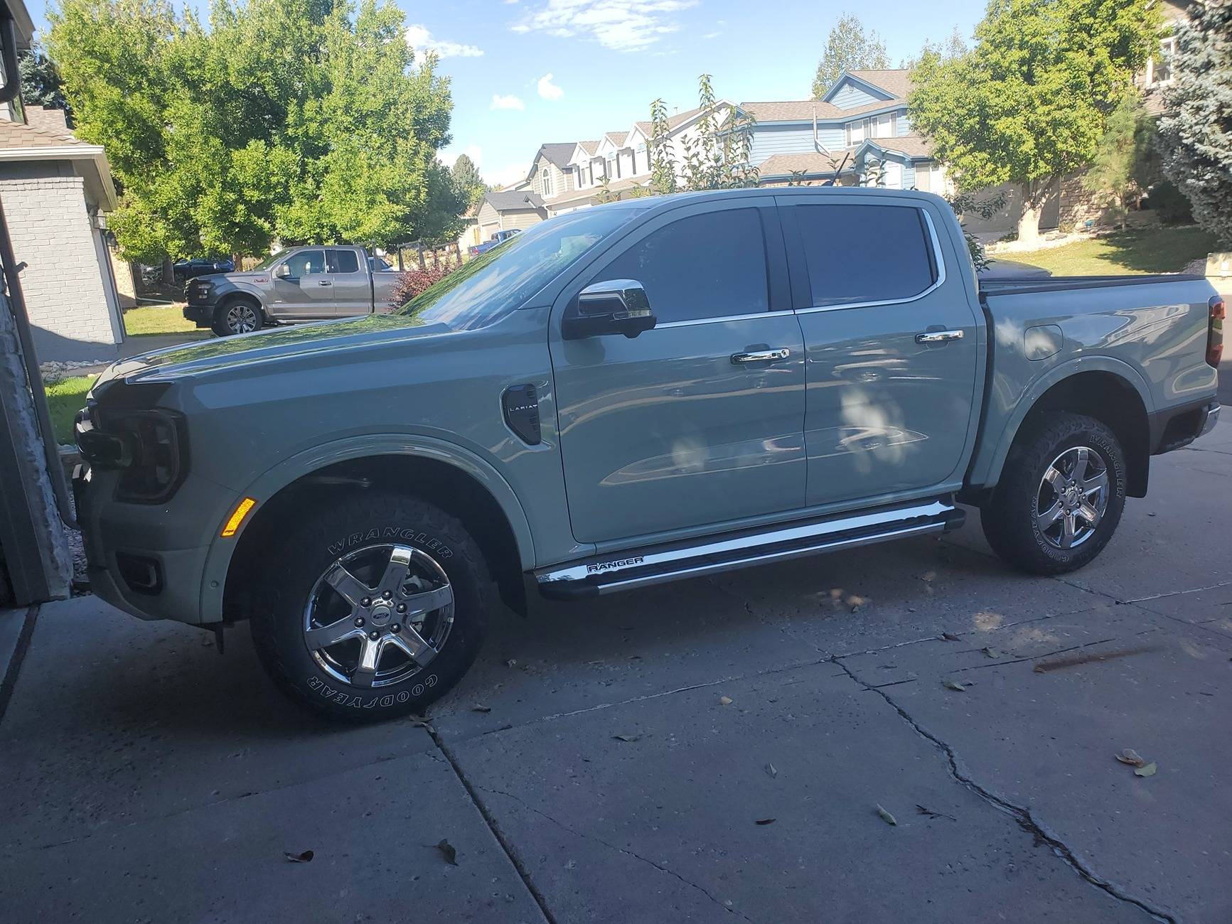

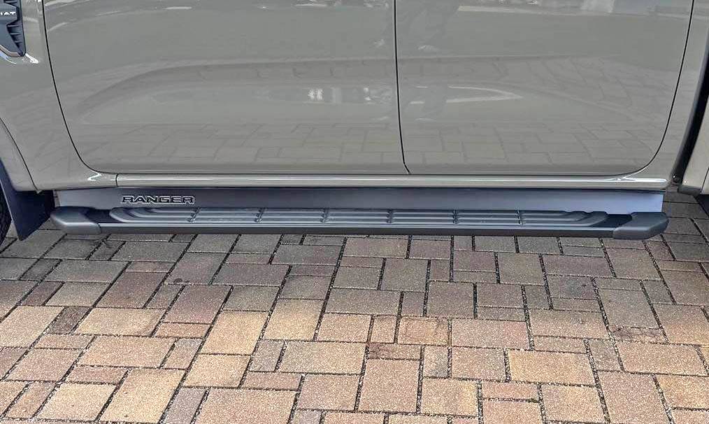

I was surprised that the filler kit came with a really nice gasket to help seal up the space. It will be interesting to see how they preform over time. Works well with the black out package theme, but not so much with my wallet! All good!
Ford Ranger Filled the factory step bars gap IMG_2360
Ford Ranger Filled the factory step bars gap Untitled-2

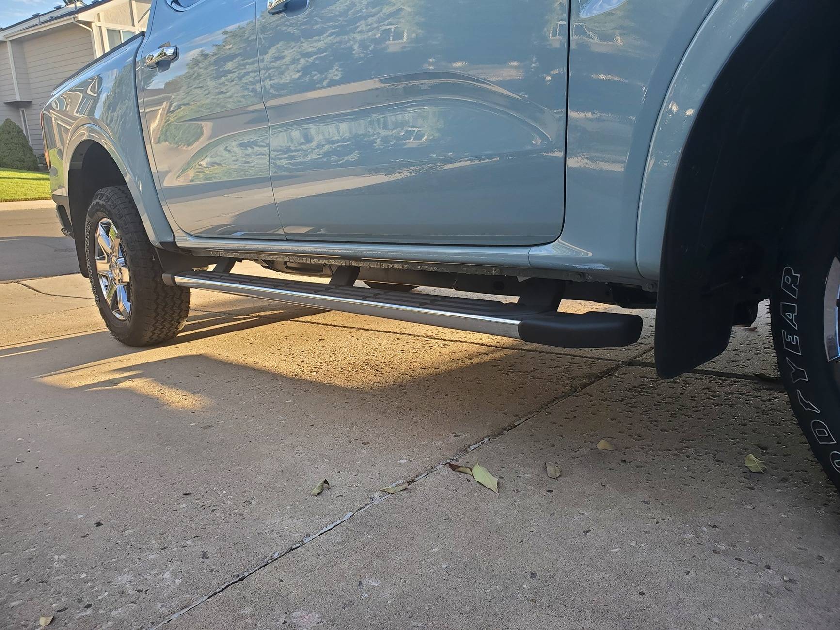

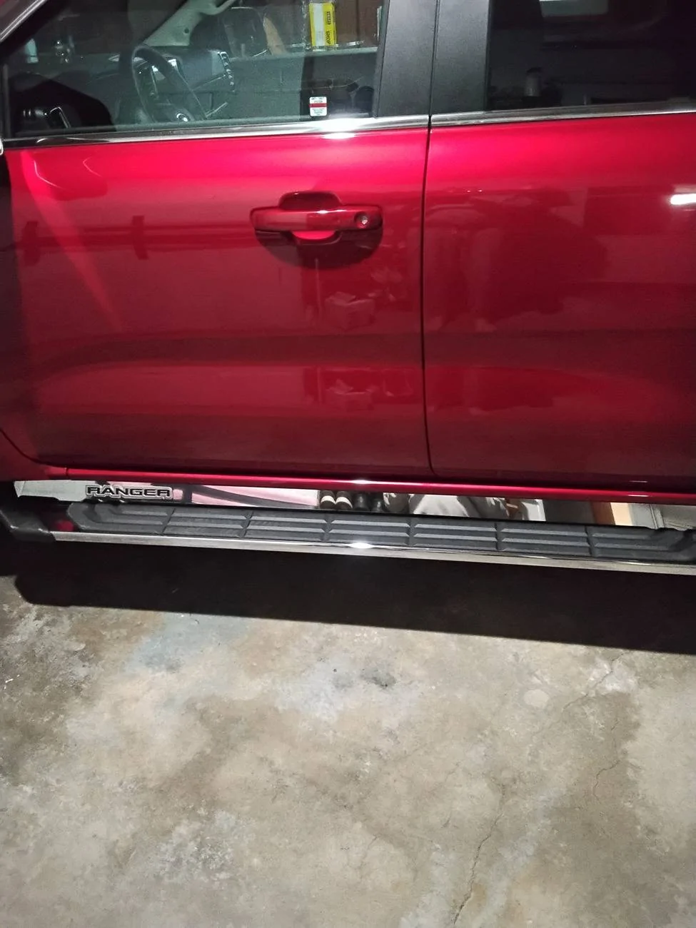

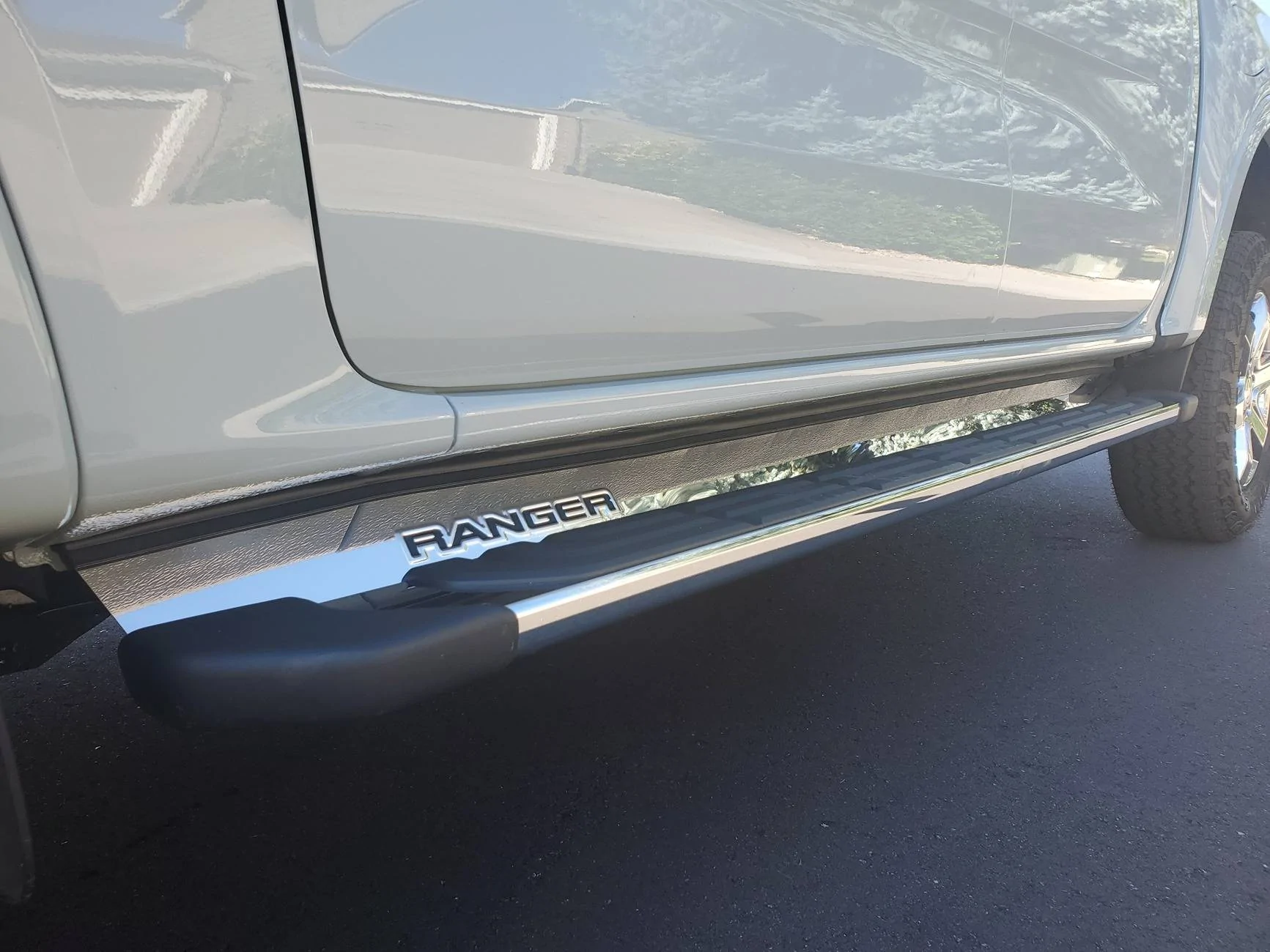

Did the stainless for the chrome package...between the mud flaps and the filler...mucho happy keeping the boards cleaner... Also like the "look" as it adds some bling!
Before/After
Ford Ranger Filled the factory step bars gap 1748126659721-lt
Ford Ranger Filled the factory step bars gap 1748126621329-8c
Ford Ranger Filled the factory step bars gap 1748126589508-s

Interesting. How hard were they to install. I am considering it as the snow buildup. This past winter was pretty bad.

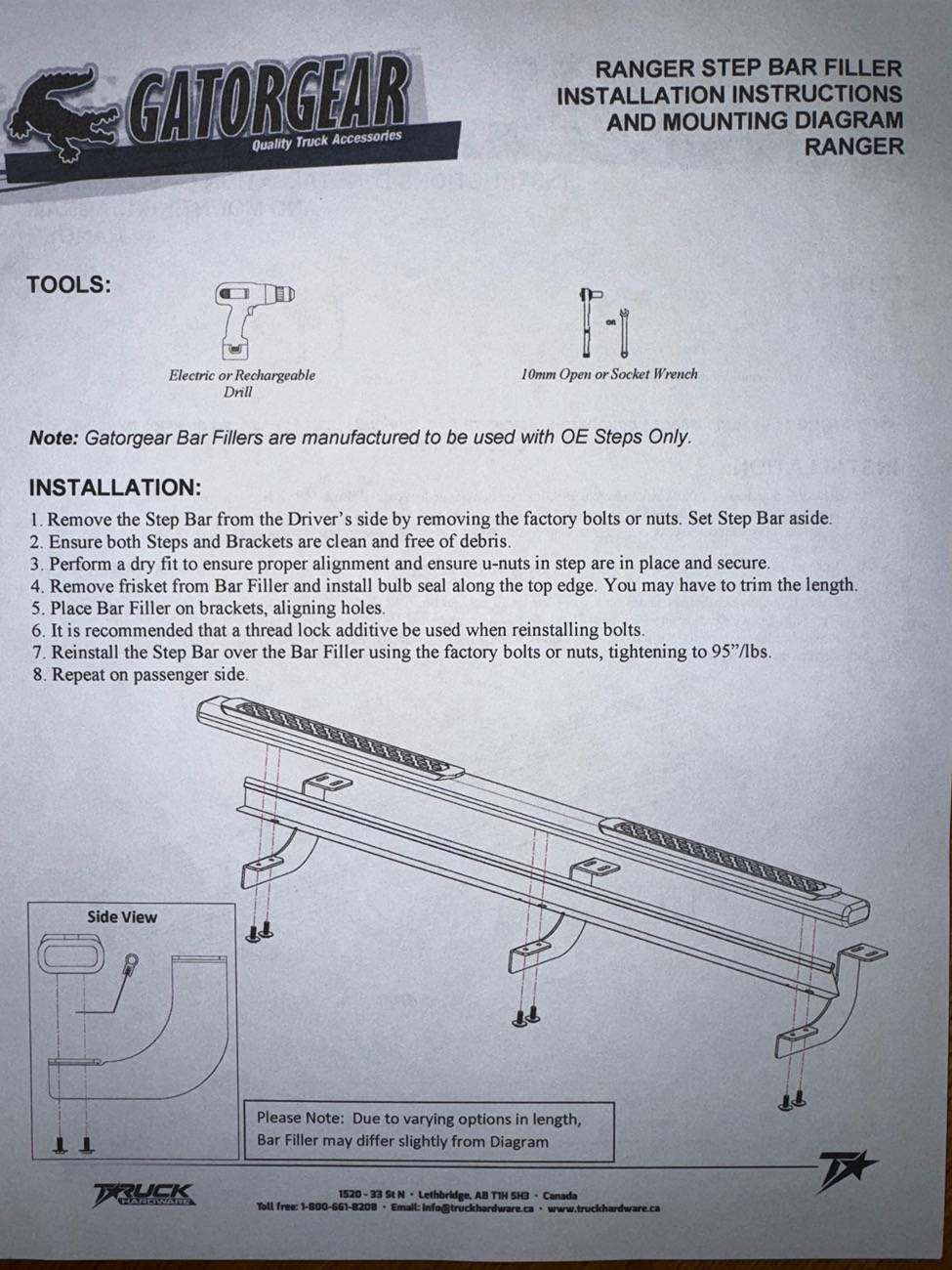

Not too hard, removal of six 10mm bolts then install the pinch gasket on the leading edge of the cover. Press it into the gap (slightly compressing it) and getting the bolts back into their nut cups.
The ford line or sub contractor that put the running board on my had most of the nut cups cross threaded, so mine came off hard. But overall it was fairly easy to do. Here are the instructions that a QR code points you to
Good luck!

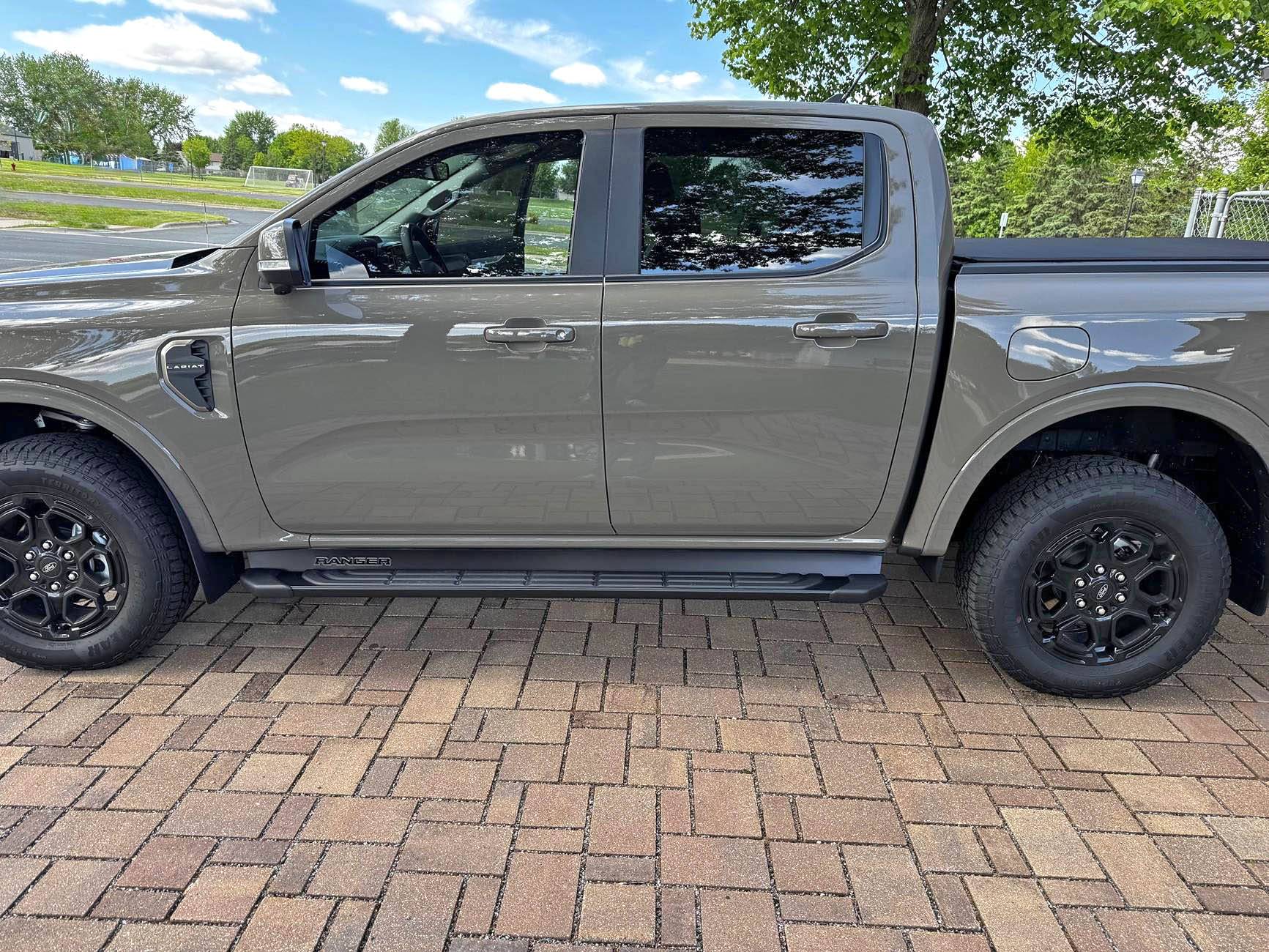

Joe
Ford Ranger Filled the factory step bars gap IMG_2374
