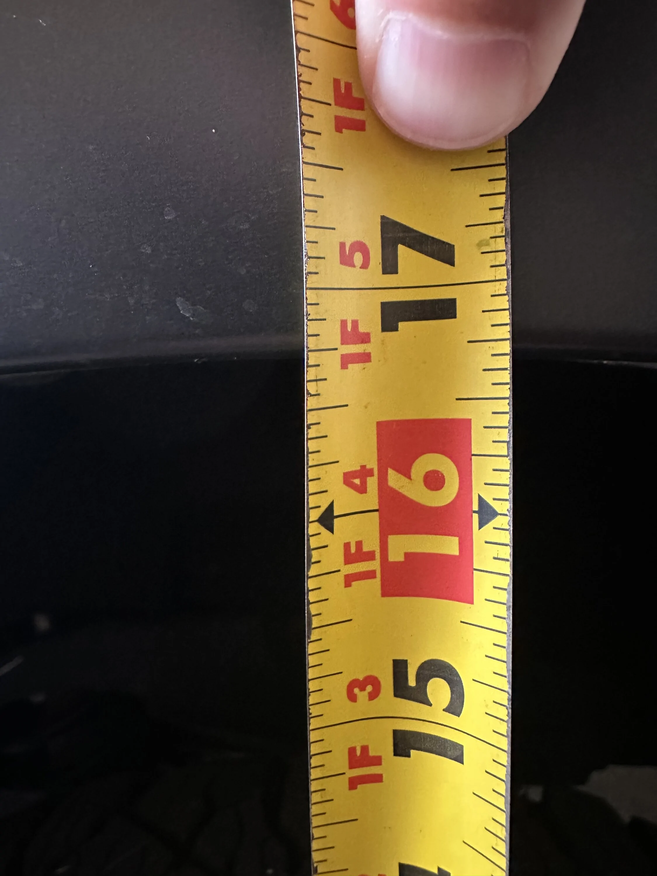

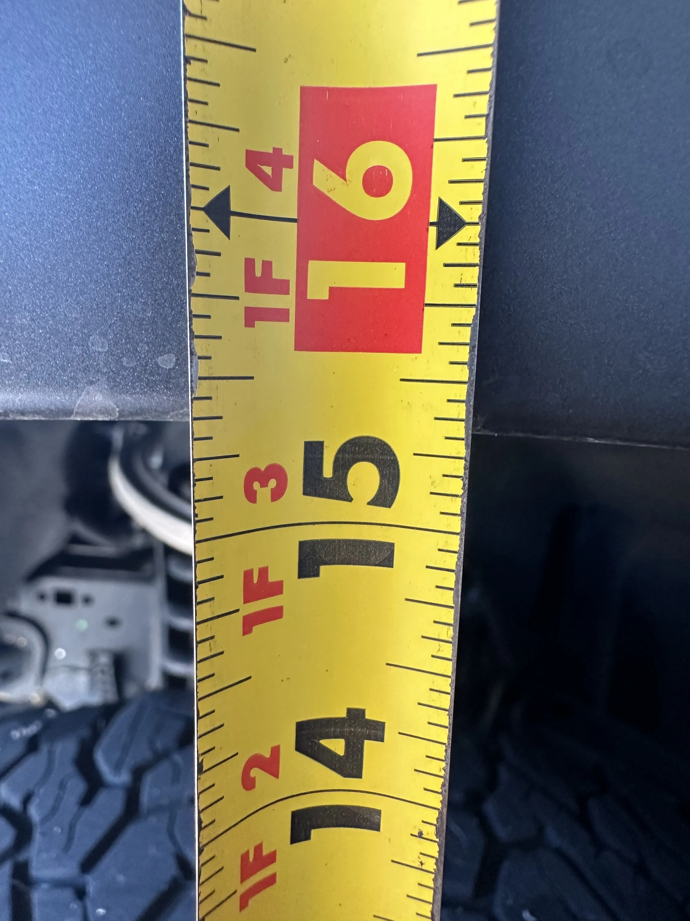

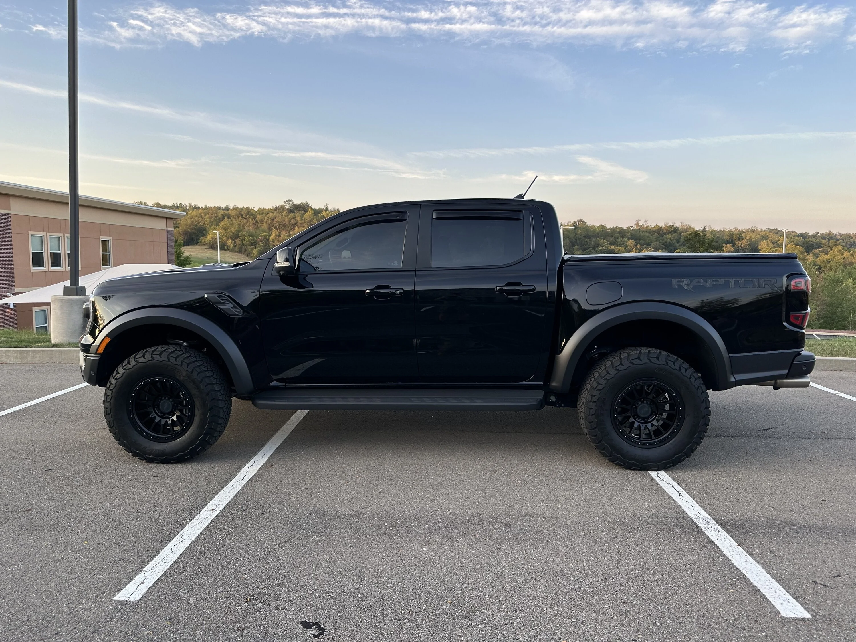

I installed the Foutz 2.5” level. The truck still has a noticible rake to it. Which you might like. I’ve attached photos with measurements taken from the same spot front and rear. Still has 1.43” of rake. Wish it was a bit less, preferably less than 1” difference between front and rear.

Thats a 2.5 level? My 2.5 leveling spacers made the truck sit so close to level most people think the nose is high

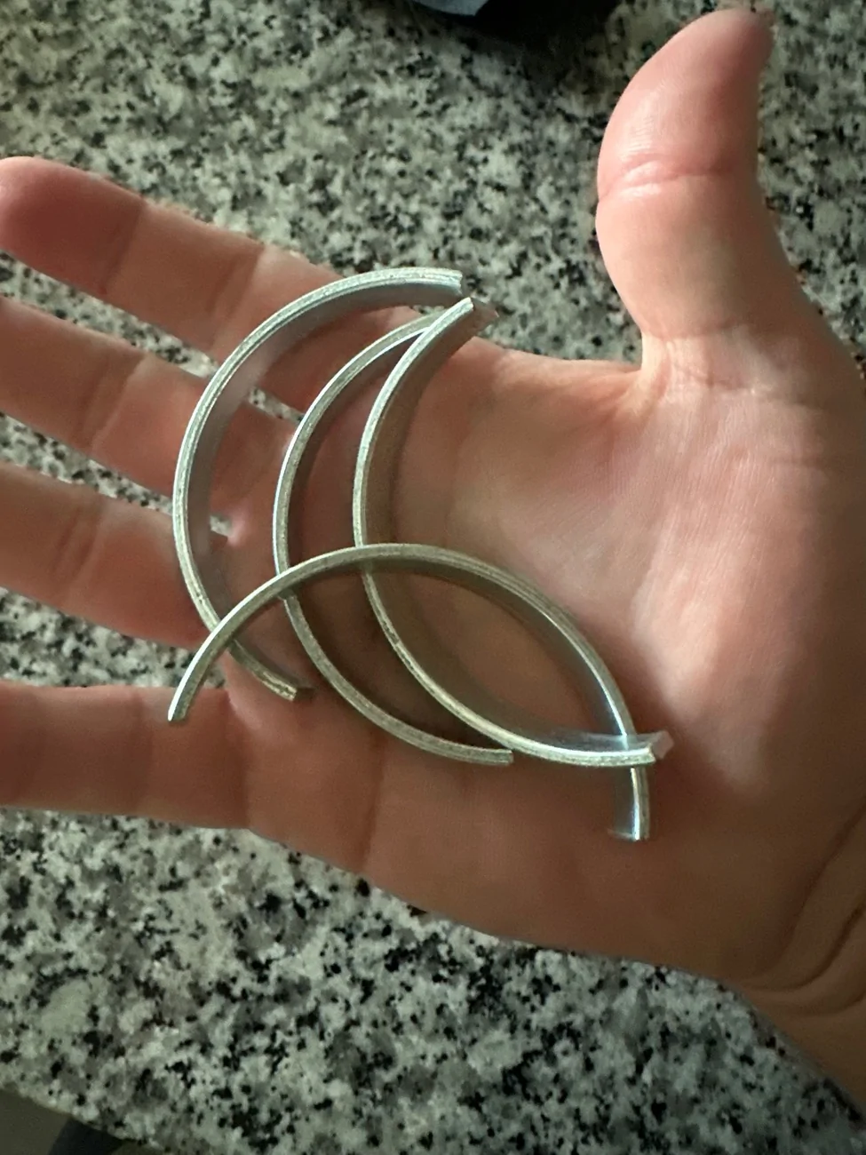

Did some digging I found the issue. Going back to the shop to have it fixed.

I was wondering why a '2.5 in lift' would result in only 1 3/8" lift.
I see you caught it.

RPG lift requires removal of those rings FOUTZ does not. Very similar lift. The installer has installed numerous RPG lifts and “assumed” they were the same. 🤷🏼‍♂️
