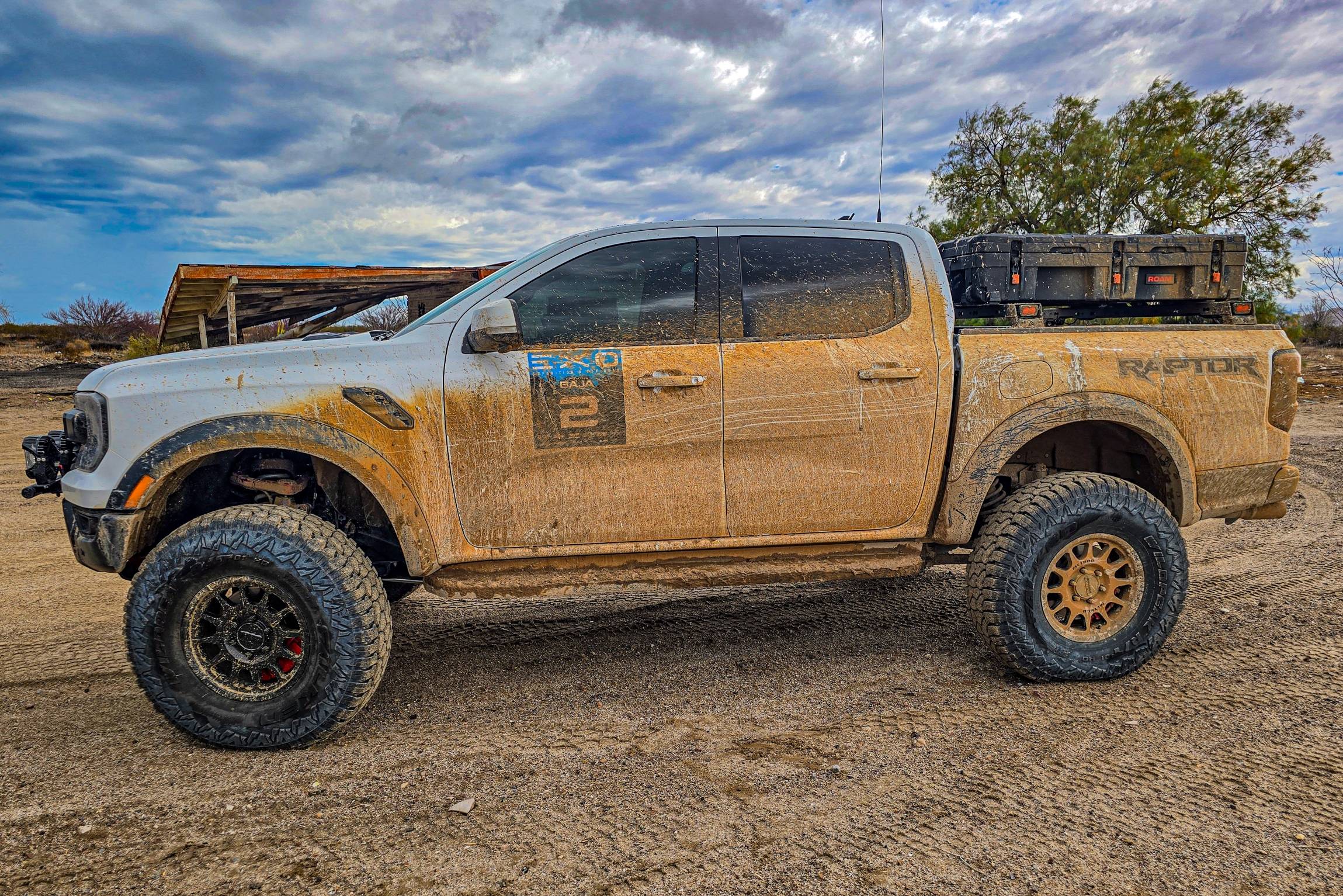

- Portals w/ Foutz Bump-stops: a match made in heaven. I seriously urge caution running 37" without these.

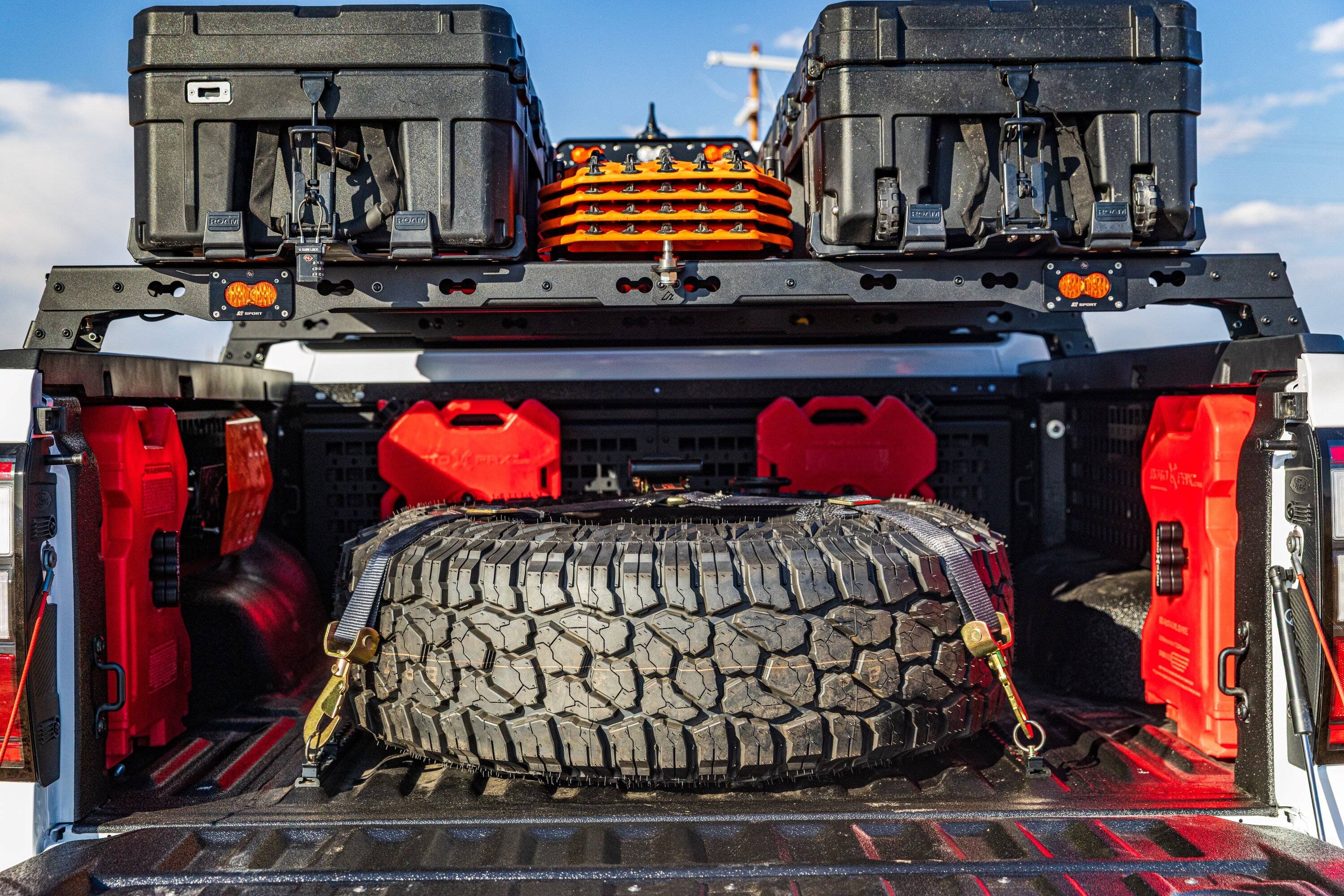

- AAL rack w/ 128l Roam cases. Not only did everything stay intact, but the AAL rack adds lateral support. Expect tailgate gaps if off-roading hard, however, the AAL rack helps mitigate. I'm indebted to Brit at AAL for making this happen.

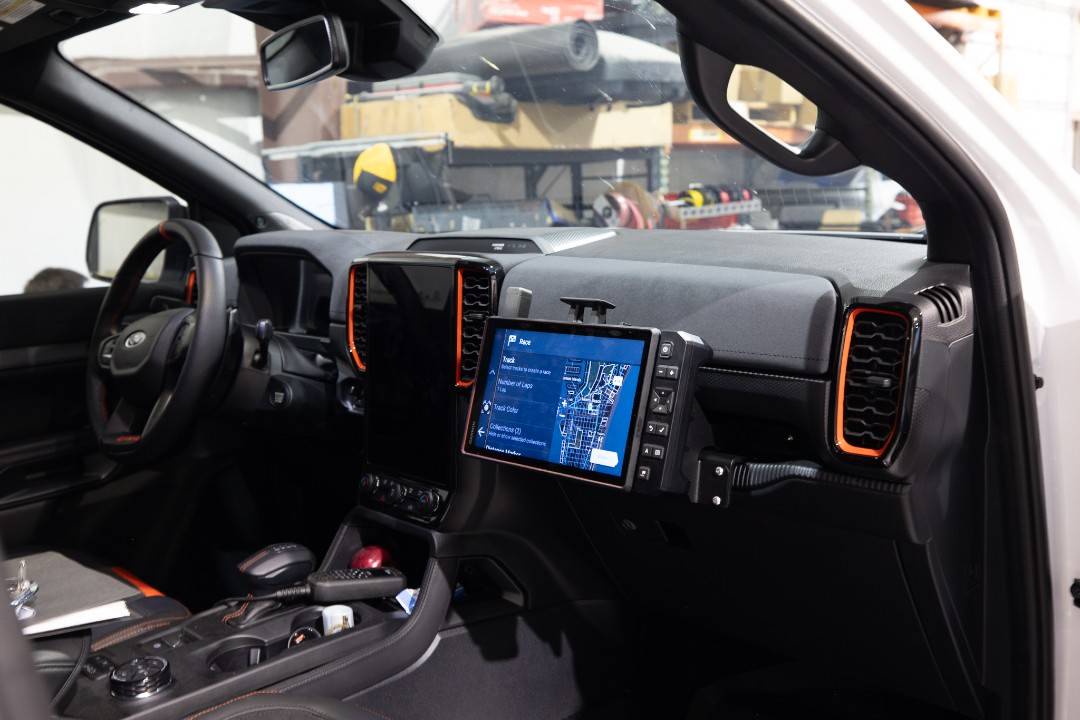

- AAL "Sidekick" GPS mount: insane. The Garmin Tread XL never flexed while we were going airborne, etc.

- Range is a serious issue when off-roading with the small RR gas tank. #1 priority is to add additional capacity.

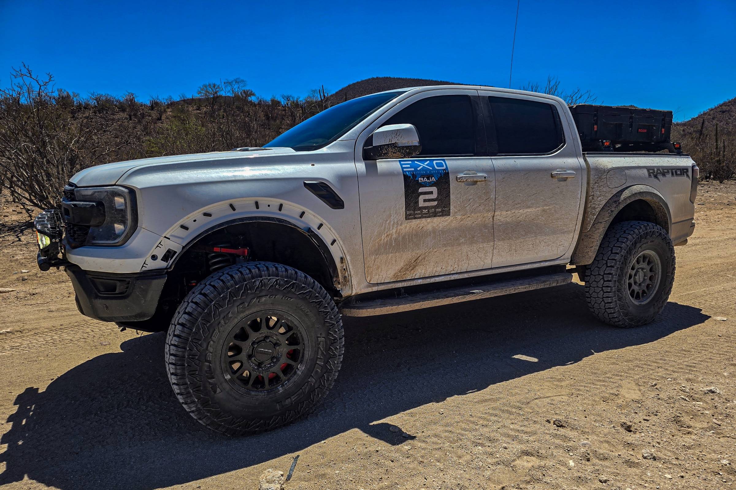

- Despite front bump-stops, some rubbing upfront under extreme loads. We did some minor trimming and removed one fender but really need to enlarge the wheel wells.
- Slightly dented the front bumper and really scratched front tow-hook having a little too much fun. Looking at after-market front bumpers with more clearance.
- The Fox suspension needs further tuning for 37" tires. Next stop is @accutuneoffroad and probable upgrade to 3" Live Valve.

- @Americanadventurelab "RAIL" bed rack, "SIDEKICK" GPS mount and truck bed MOLLE panels.

- @roamadventures 2 x 128l cases w/ Roam mounts.

Ford Ranger Ultimate 37" Ranger Raptor Build & Baja Shake-Out Report GPS

Curious your wheel offset with the portals. If that could have played a part in fender damage.

+35 so pretty much doing everything possible. It's just the shape of the hole and "everyone" in the hardcore 37" community has said the same (e.g. Exodus 4x4, 74weld, FMI, etc.).
Ford Australia designed the vehicle and they don't do 37" over there.

I have a couple things, with the arches, have you looked at RollingStock Widebody Flares? https://rollingstock.myshopify.com/...tor-flares-widebody-wheel-arch-guard-flares-r
Also, we do run 37' here, but it's illegal without an eng. cert. so you don't see many, unless they have portals or a 3-4' lift... 😅had to lob that in there sorry...
Final thing, how'd the Falken's go for you?
$3K for fender flares, WTF, they carbon?
Also, it's too bad you have those weird rules down there regarding poke and eng certs needed. Gotta love the government trying to "protect: you.
