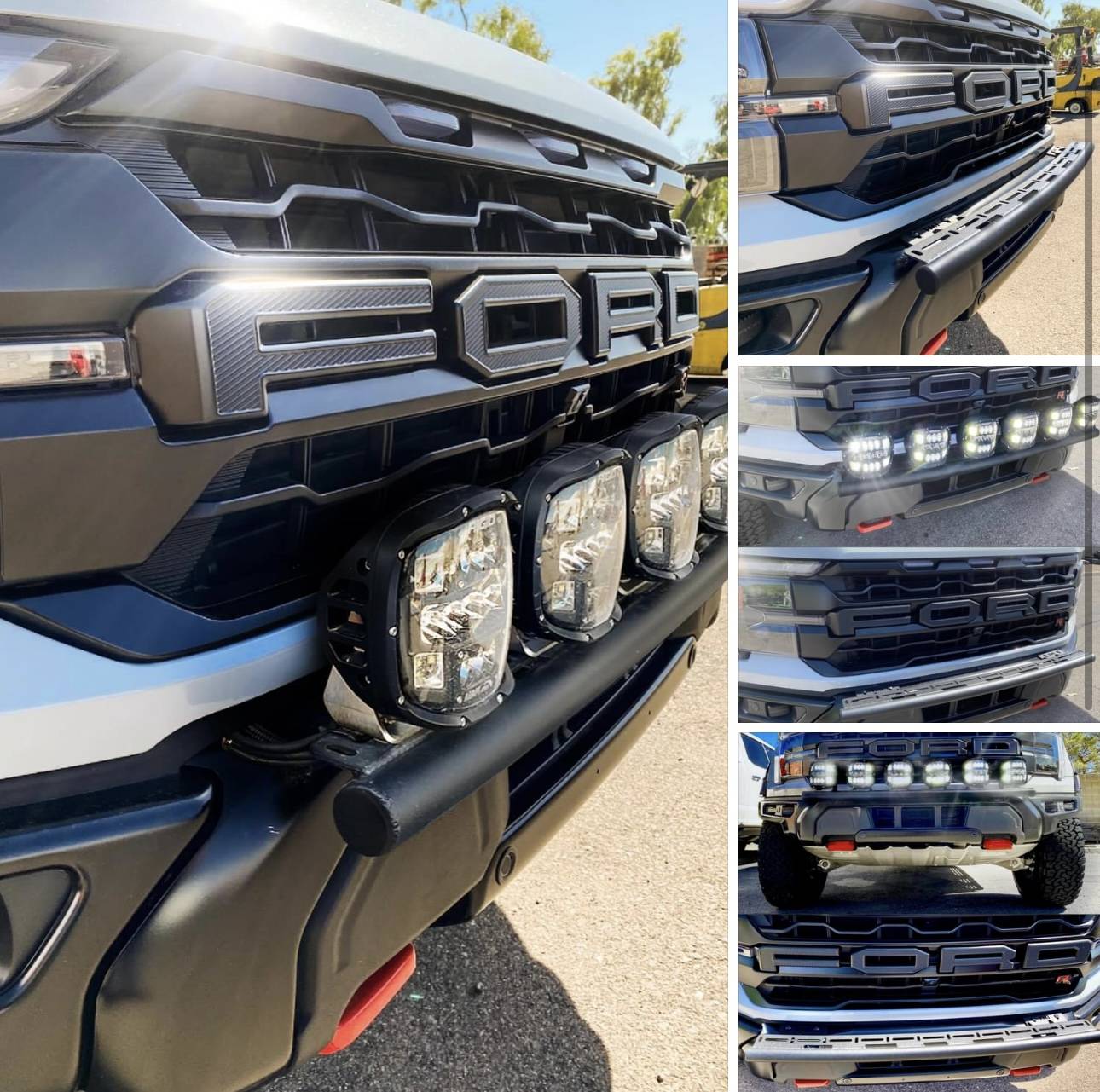

Put together a light bar like this for the Ranger and I’d definitely buy one when I get my truck.
Im already working on that for the Ranger Raptor now. just need a little more time on that one

I have a bar similar to that on a previous truck. I still got it, not sure if I will put it on my Ranger. It was made by Smittybilt Street Light Bar.

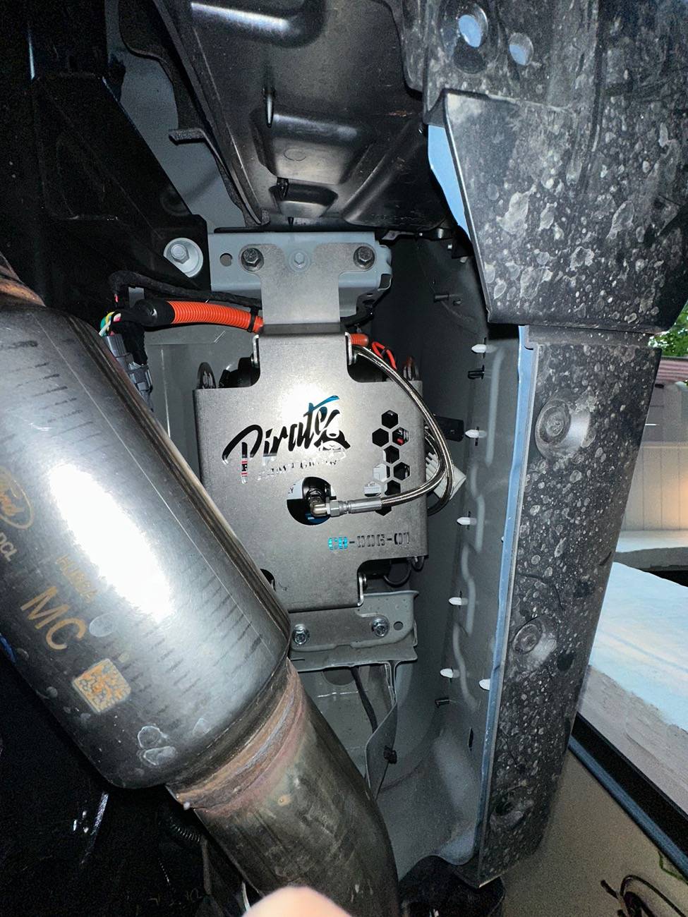

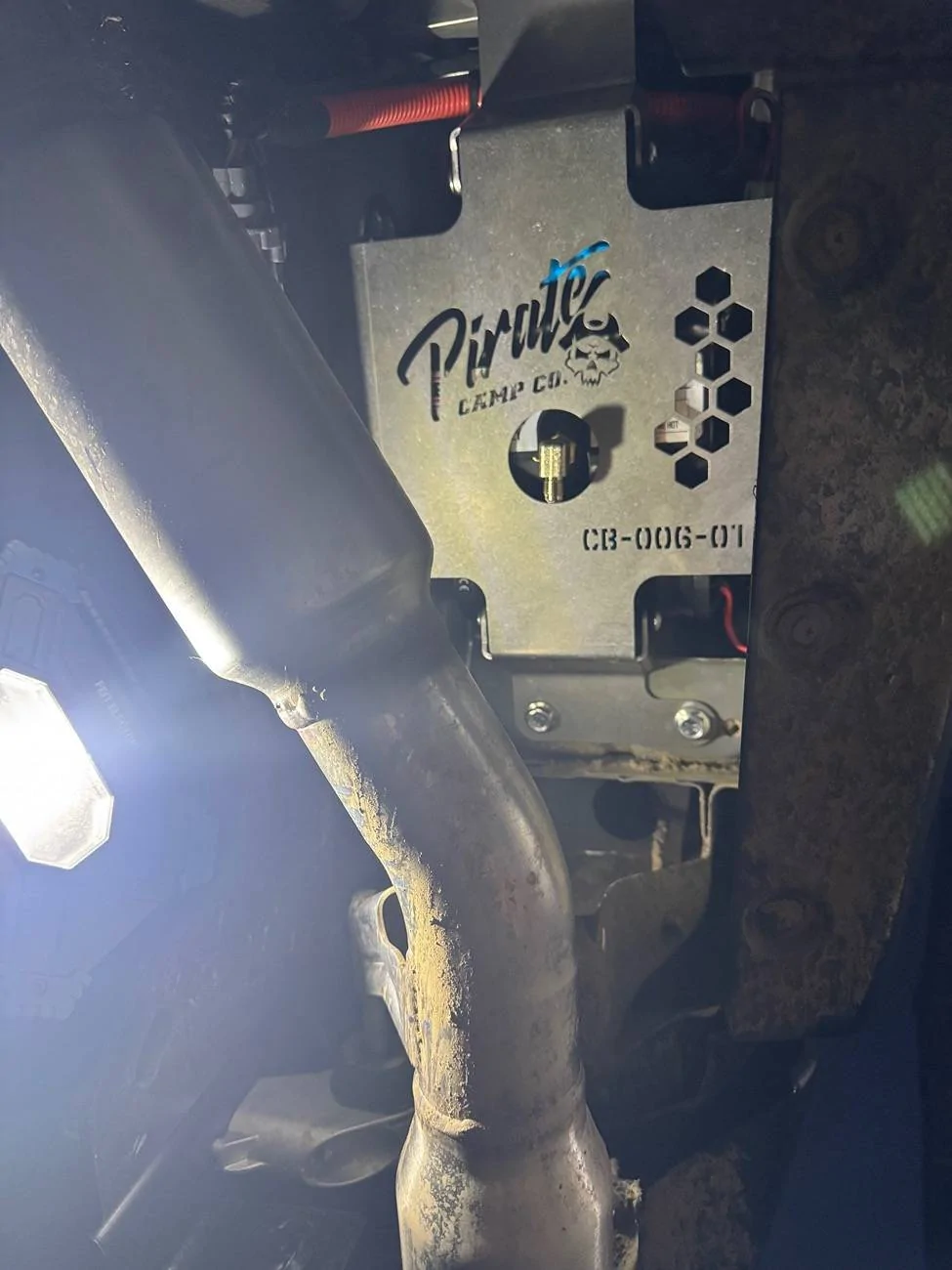

Any chance you are developing a rear trailing arm ride height sensor cover solution? Don’t really want to buy from Australia, and current domestic option in Florida is not something I will purchase due to materials used and marketing that rubbed me the wrong way.

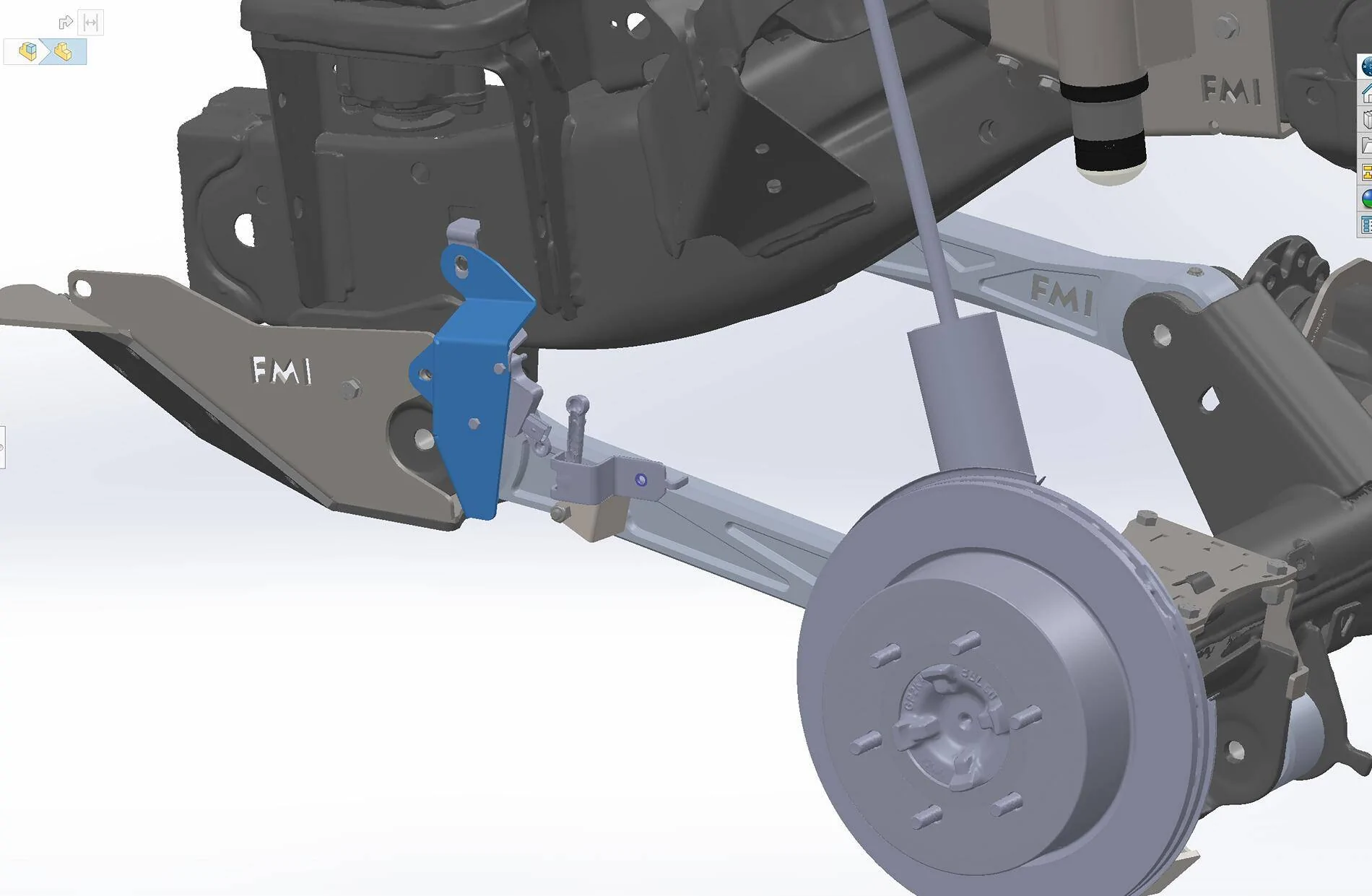

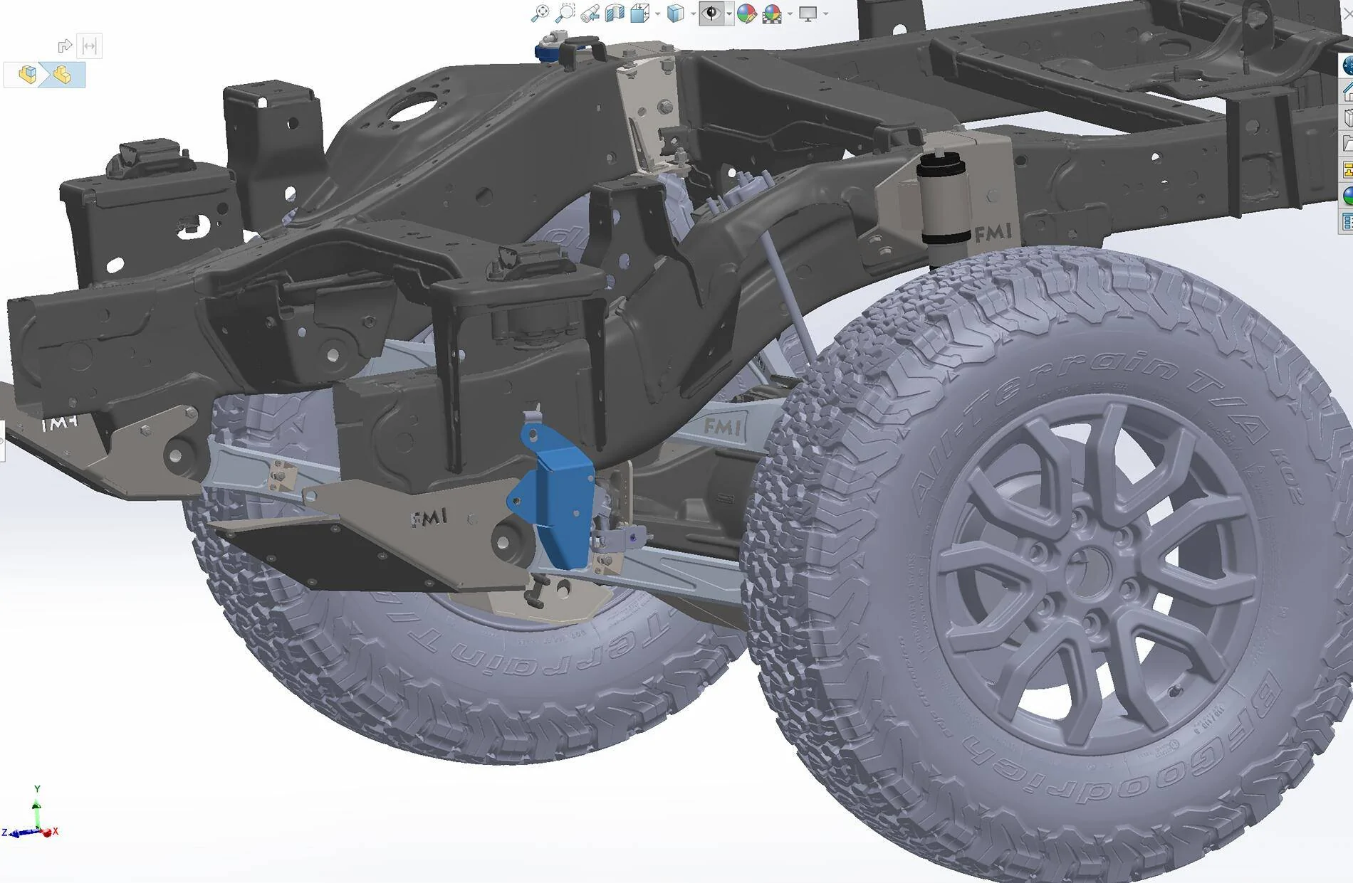

yes we have one done and just final test fit it on Friday. We did about 4 different versions before I was happy with it. I think the one we came up with has the best overall protection of anything I have seen. It actually replaces the stock mount bracket with a new mount that the sensor bolts into and then protects the rod and sensor all the way through the cycle of travel so even at full droop everything is protected from flying rocks from the front wheels etc.
here is a screen shot of it from my design work. Now that we confirmed fit I will get costing figured out and we can be shipping them within a couple of weeks.
Let me know what you think.

Looking good and happy to hear your solution is close to completion. I’ll be watching for availability.
Any concerns the sensor harness connection point isn’t covered? With that coverage profile in your design the gravel etc. being flung towards the sensor should be protected so probably isn’t an issue.

the wire connector is protected in this version. we added a small hole at the top for the wire to pass through thats not in the screen shots.

Definitely will buy a set when they are ready! Thanks for all you provide for enthusiasts that own these trucks!
