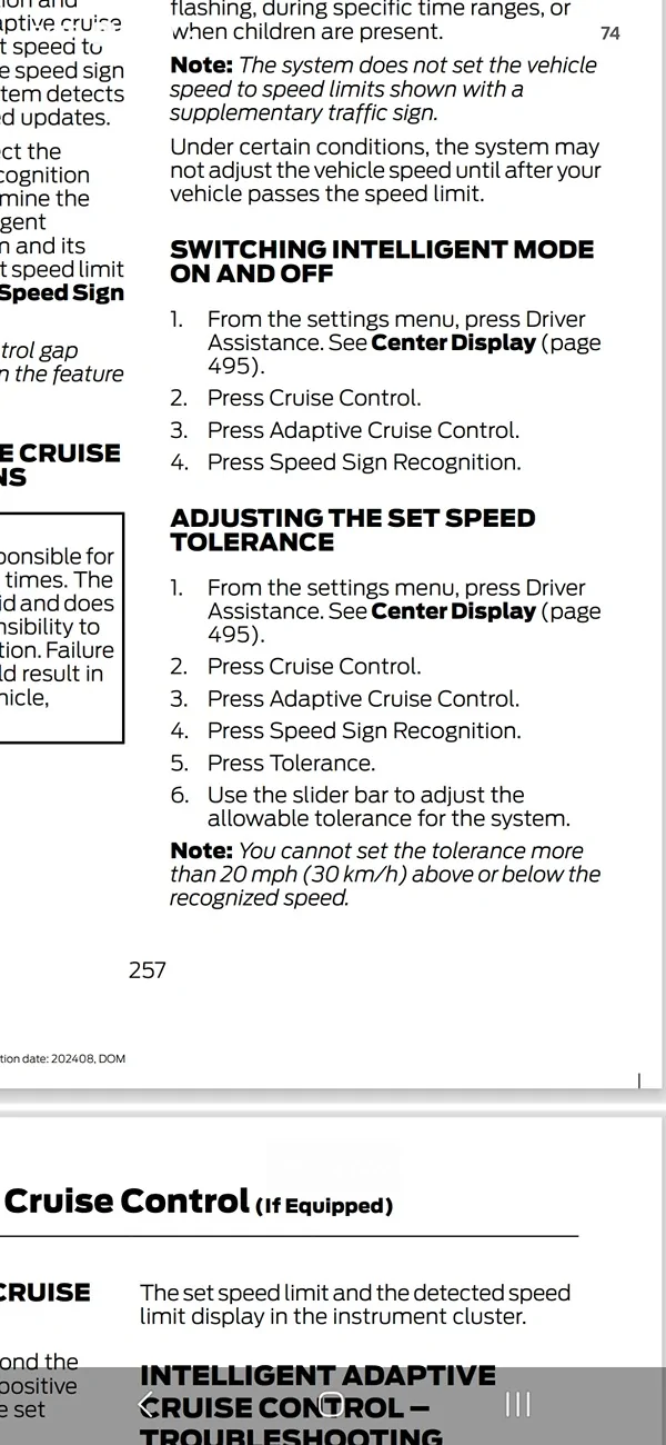

Ford Ranger 2024 RR - Can I PERMANENTLY disable the Speed Limiter (LIM) button on the steering wheel? 7001
Try the adjusting set speed tolerance. That way if you accidently push the button you have more flexibility.
