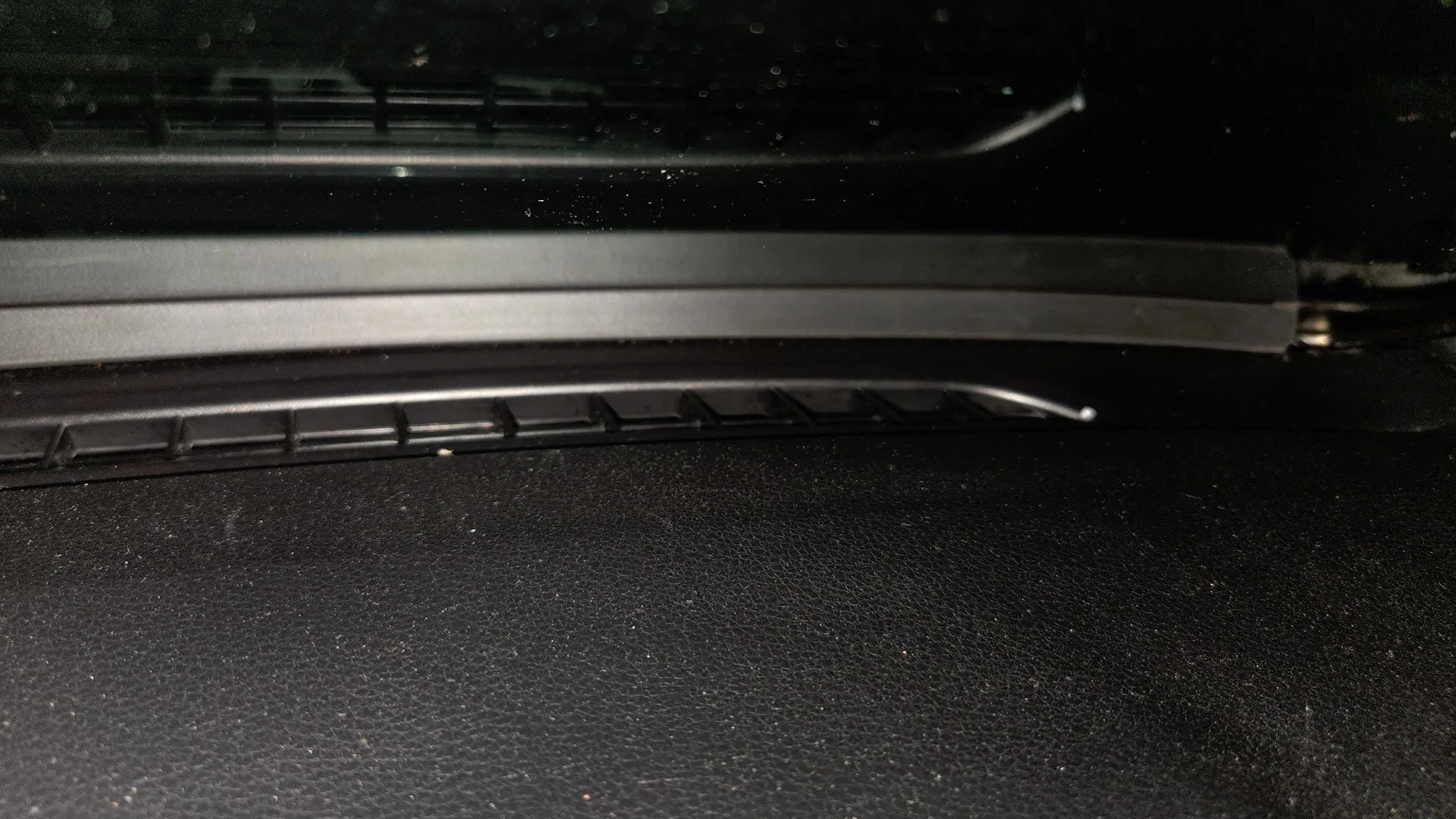

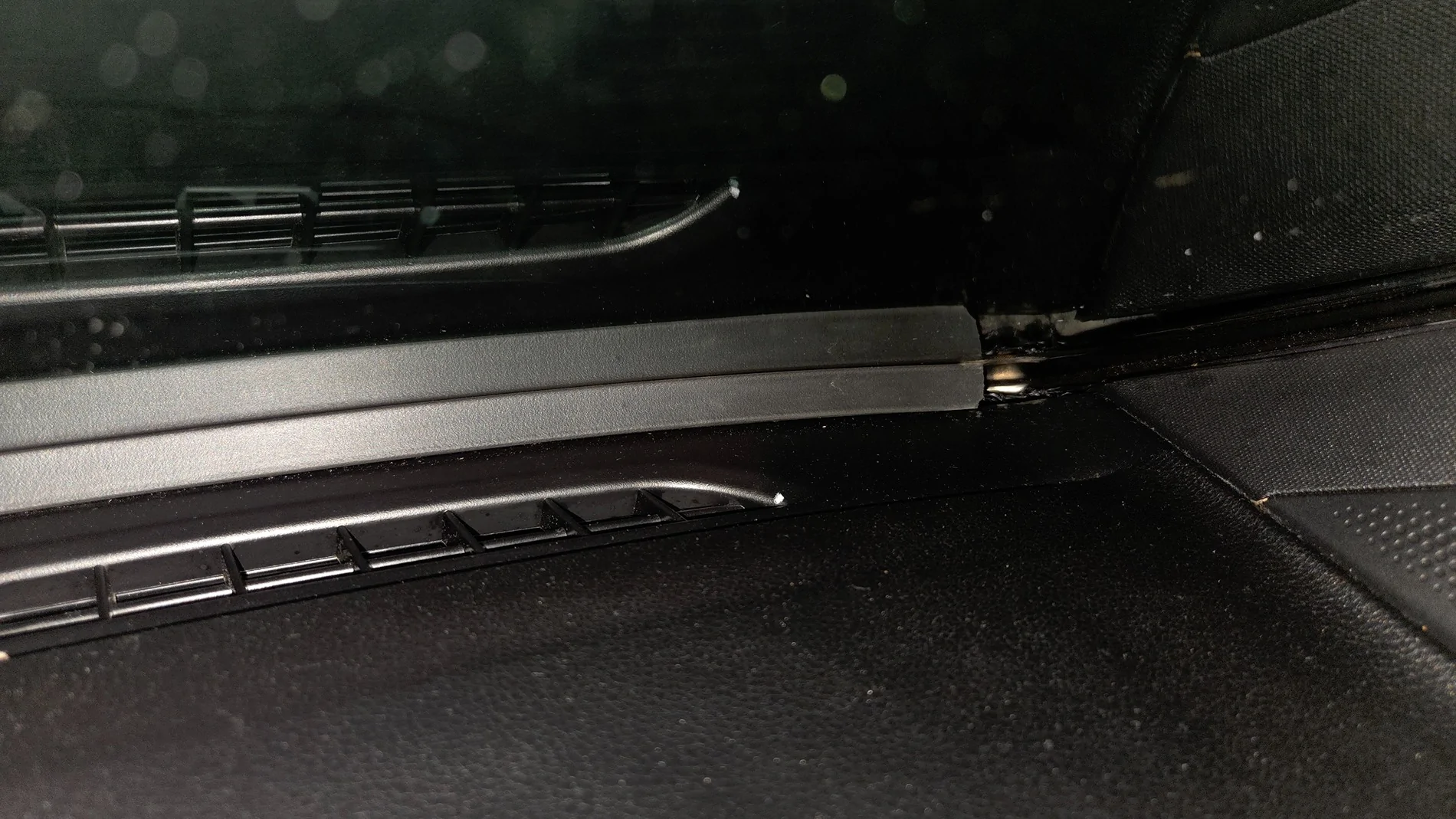

Journal, I've had a very similar noise and it turned out to be a seal on the dash squeaking on the windshield. I used to jamb my wallet down there to stop it then I found this rubber seal from our main hardware store which fits really neat - I've run it the whole width of the dash. Might be worth checking if that's all yours needs
