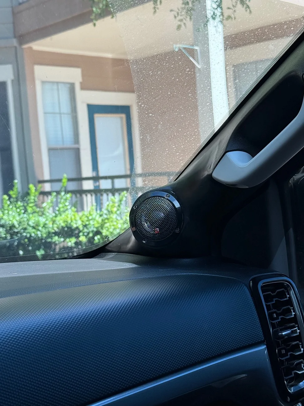

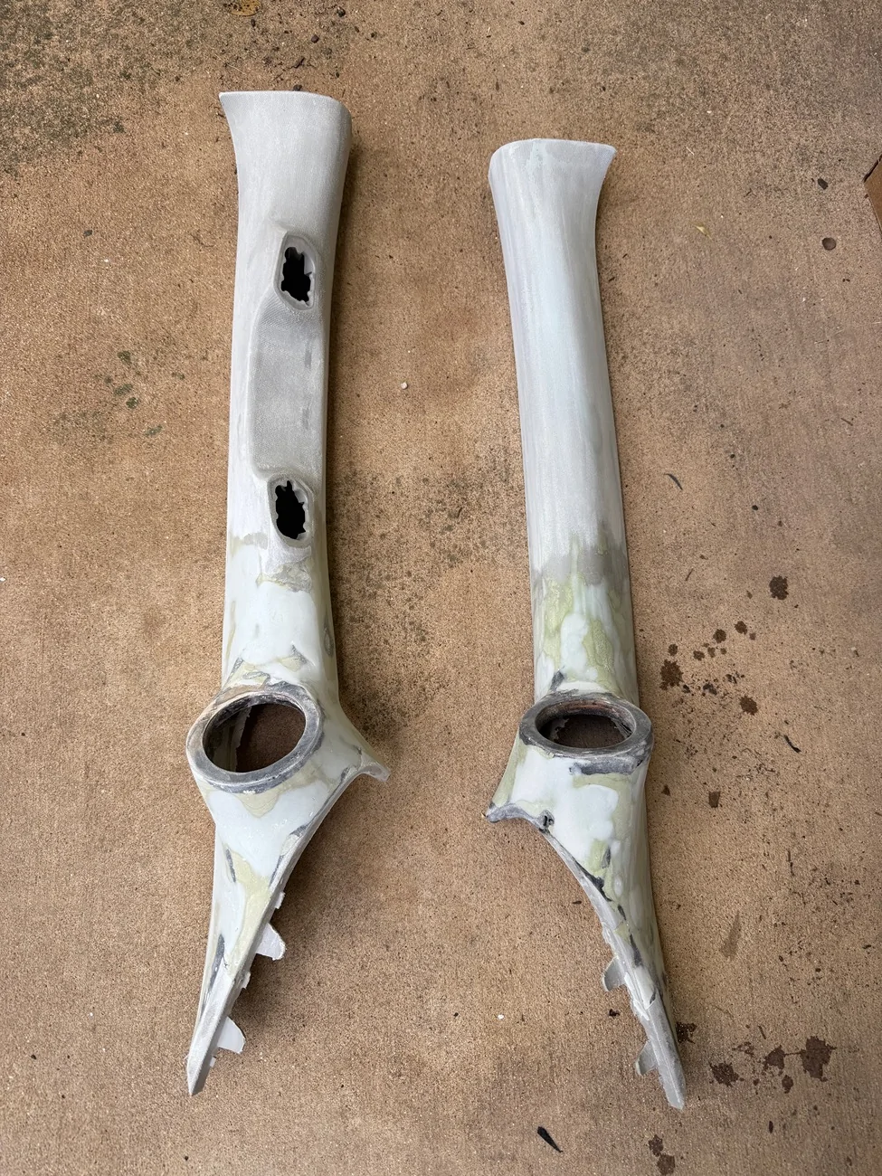

thanks! its a learning experience for sure.
getting them primed and painted tomorrow to buy some time before i wrap them to match the headliner.

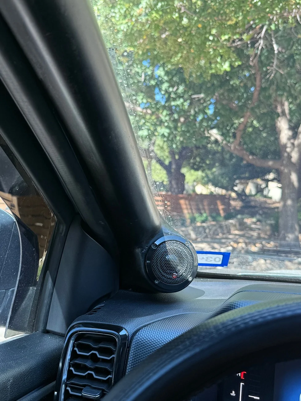

got the a pillars reinstalled. a learning curve indeed! not bad for a first attempt but ill be buying new pillars and trying a new idea. i "think" the '19-'23 ranger pillars without the tweeter mount should fit the same and allow for a smoother transition of body work. the symmetry of these pillars is off just enough to bother me.
they are wired up the the factory wiring with a 300hz cap on them. sound stage is soo nice now.
getting ready to finish the whole stereo upgrade and install the amps and subwoofer once i decide on which one. due to airspace of the aussie underseat box (.37cuft) and stuffing with .6lbs of polyfil to get it to a simulated .47cuft my options are limited but will probably go with a kicker shallow mount 10" at 1ohm.
kicker keys bi amp crossovers will be 80-640hz for the 6x9 and 320hz hpf for the wideband.

the airbags dont go down the a pillar on either side but maybe 4" at the top portions.
sound wise its great! i have the full system wrapped up now. so the pillar speakers are crossed over at a 320hz hpf and will reach 20k hz
the stock tweeter has a capacitor on it to act as a high pass filter at around 5.6k hz. swapping in a new tweeter than can be crossed over lower will do wonders as well.
putting a coax speaker in the door and leaving or removing the stock tweeter is a step backwards imo as far as setting a proper sound stage. it puts the full range of audio at your knees.
just do a 6x9 component and sound deadening.
for the average user doing any work like this is not worth the effort, i just like to tinker with things.
