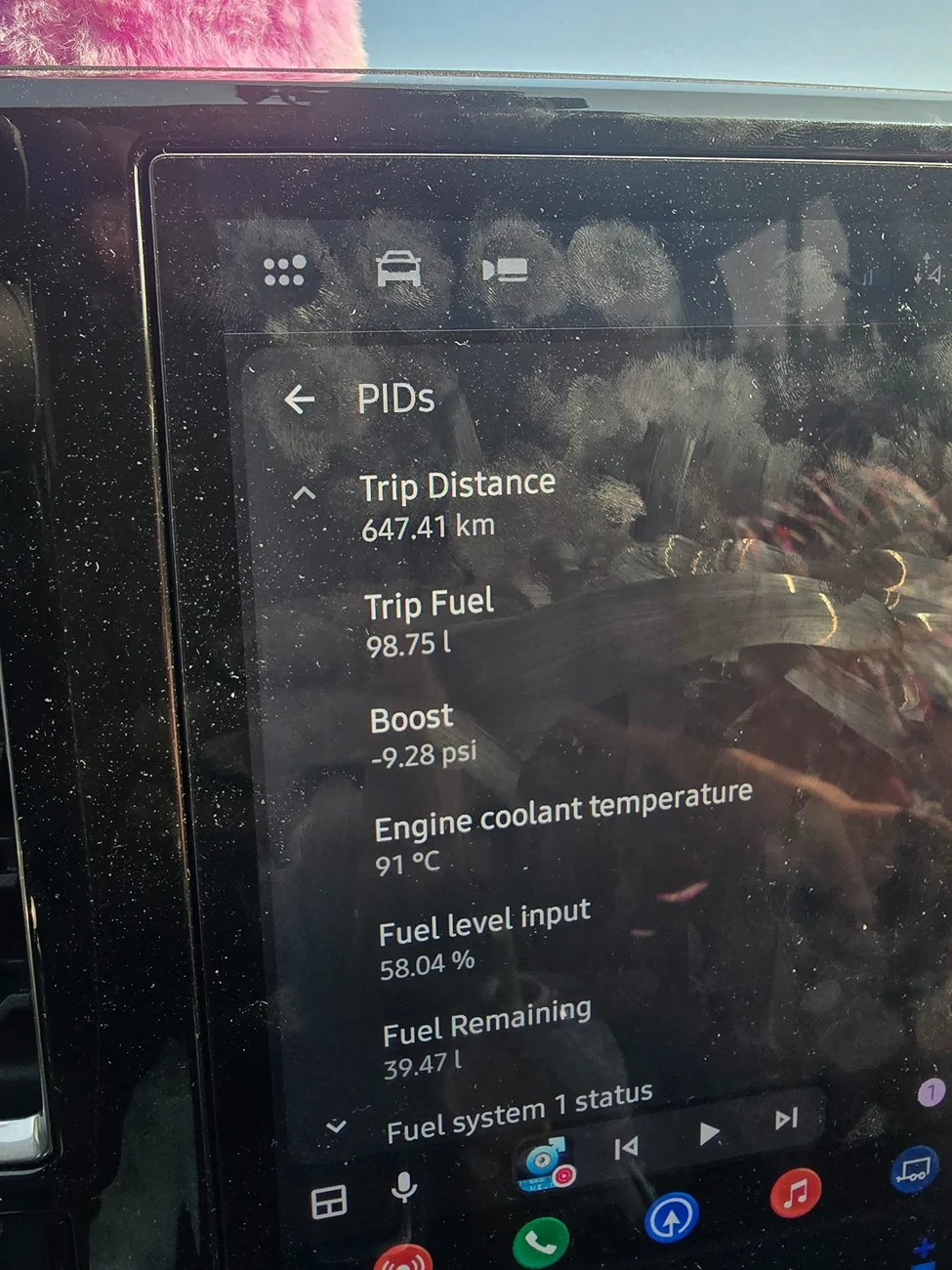

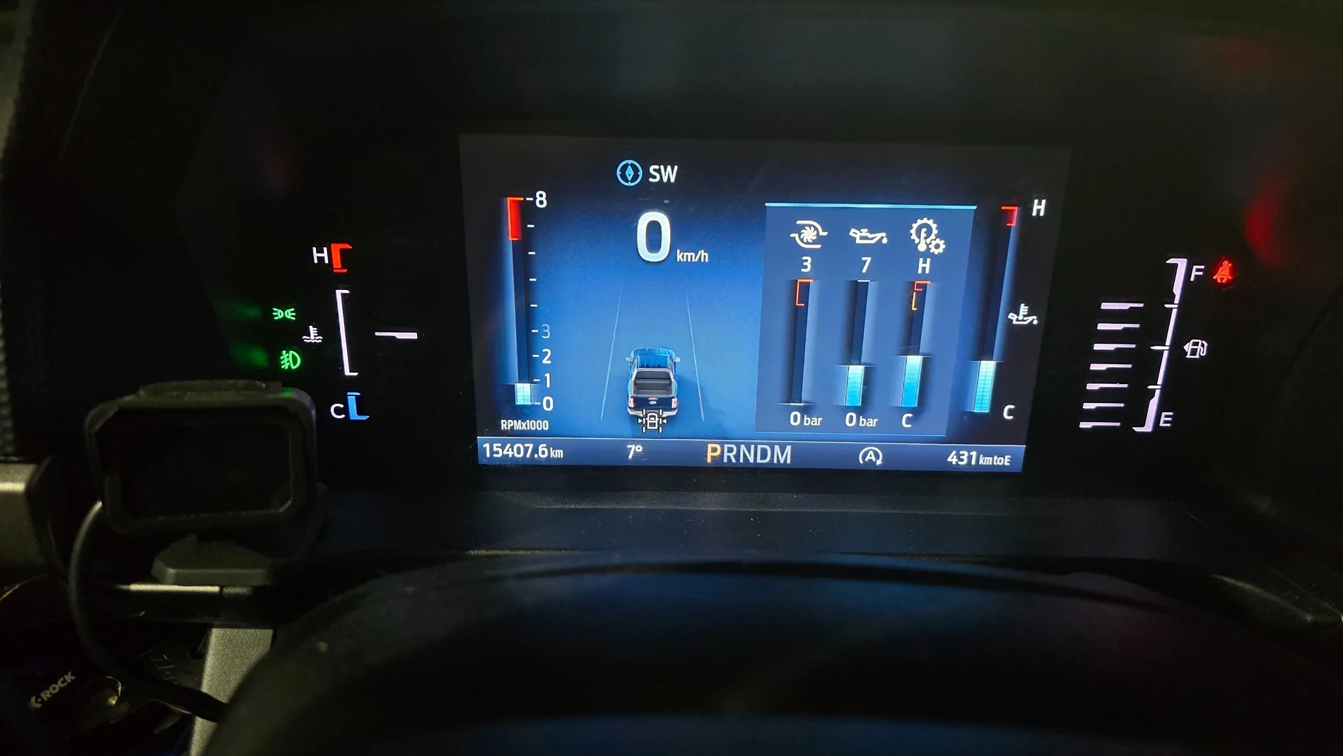

You can view trans temp on the same screen your turbo psi and engine oil pressure is on the offroad menu-engine info(or similar name) on the dash. engine oil temp is on the dash as an extra guage. But I am running OBD Link(only compatible with the obd link mx/mx+ bluetooth reader) and the app is AA compatible.
Only displays 4 pids at a time when in drive, park will dispaly them all, but you can set up extra screens for it. Im running Trip fuel liters used, coolant temp in celsius, fuel remaining in liters, and boost psi when I run the extended display. I think the mx+ enhanced diagnostics update for obd link lets you see the trans temp. I just use the one on the dash to keep track the trans temp.
dash display left is coolant temp, rpm, speed/lane keep assist, boost, oil psi, trans temp, oil temp, fuel.
