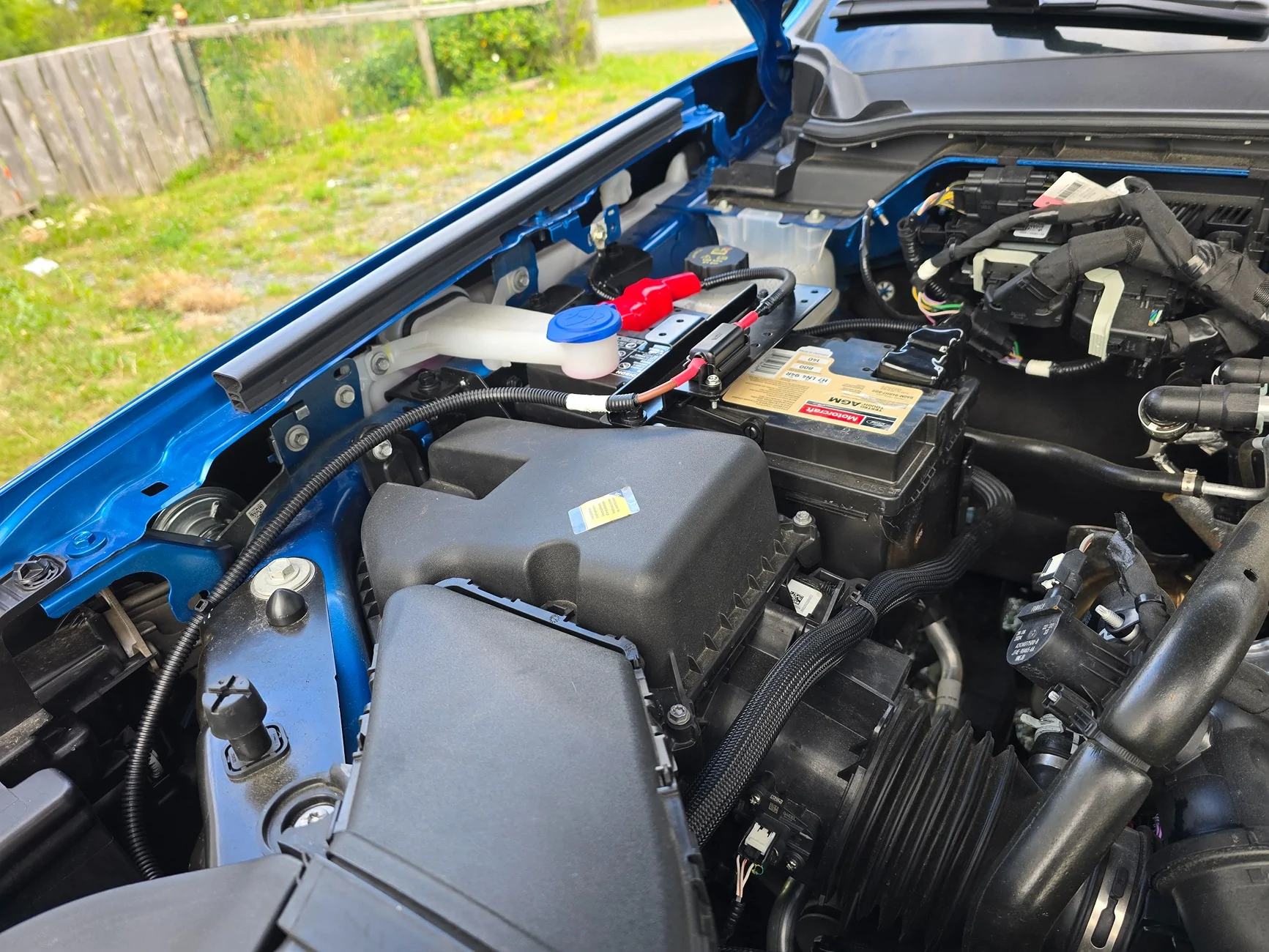

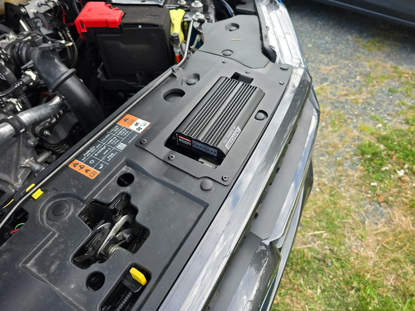

State of charge is what your looking for. I put mine to 90% and changed my battery to dual battery single sensor, because I added the arb dual battery kit from Australia to my canadian ranger.. the rangers in the bcm have options for the battery
• single battery, single sensor
• dual battery, single sensor
• dual battery, dual sensor
