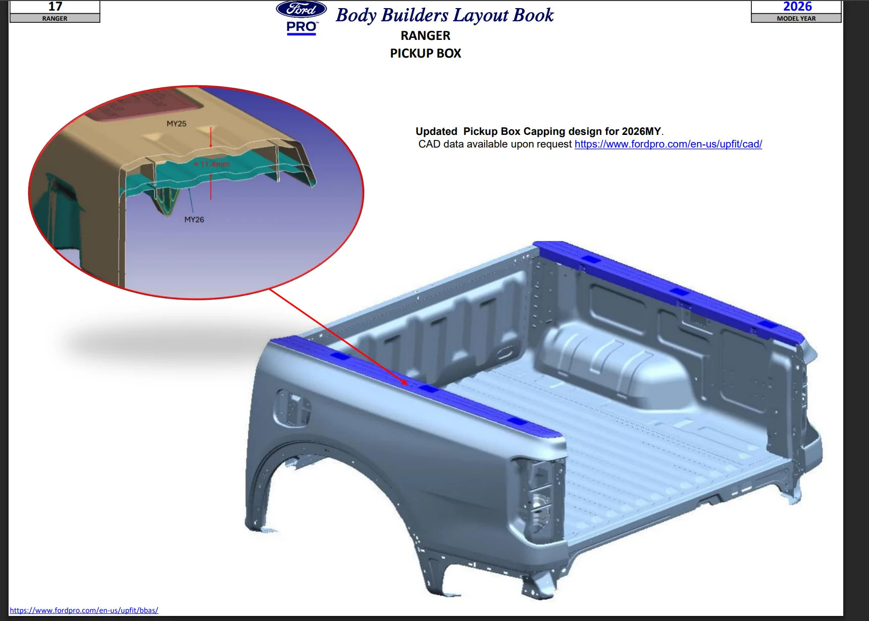

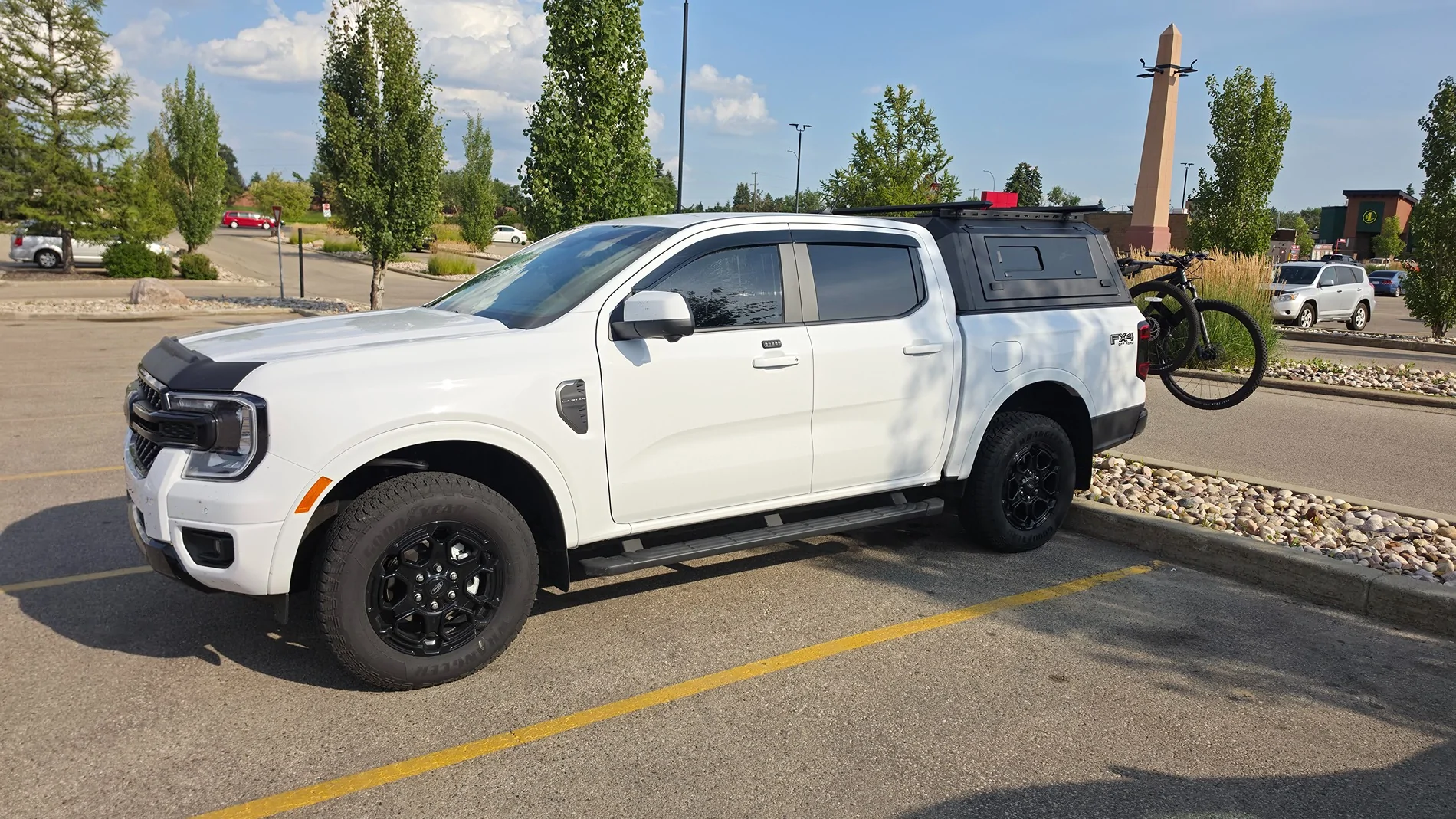

I recently purchased an aluminum bed cap and it seems that starting in 2026, the bed cap has been lowered by approx. 11mm. So if you purchase a cap for 2024-2025 ranger, might have to add extra thick weather stripping to make up the difference.
my 2026 with the 2025 cap installed, isn't really that noticeable TBH

24-25 are generally the same fitment and then 26 is a separate fitment on most covers.

If I understand your question properly the difference between the covers is how it clamps to the bed as the bed caps changed between 24-25 and the 26. The weather protection will be the same but the mounting is slightly different.
