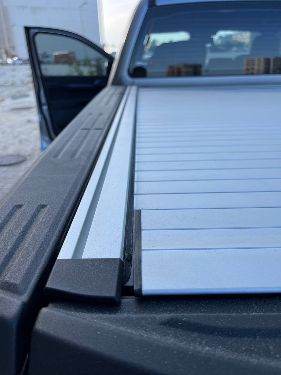

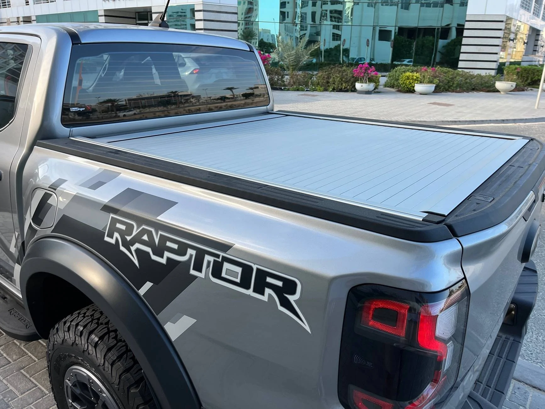

I just came across these pictures of a Ranger Raptor that has rail caps WITHOUT stake pockets. I believe the truck is from Bahrain.
Anyone know how to source these??

Anyone? I'm looking for the same thing. In fact, I could have sworn I've seen a ranger with rail caps without the stake hole covers in them.
