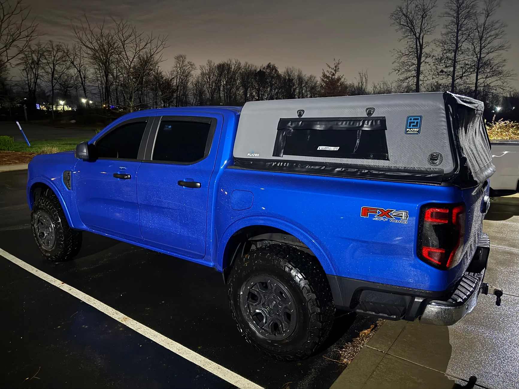

I went with Flated, I got their topper but not the tall one and I’ve had it on my truck for 4 days so far so good and hardly any water intrusion and it looks good on the truck and it’s super easy to get on and off and it’s sturdy enough for me to stand on top and put tools on
Flated is an interesting concept, but I'm not sure that it's the right fit for me. Thanks!

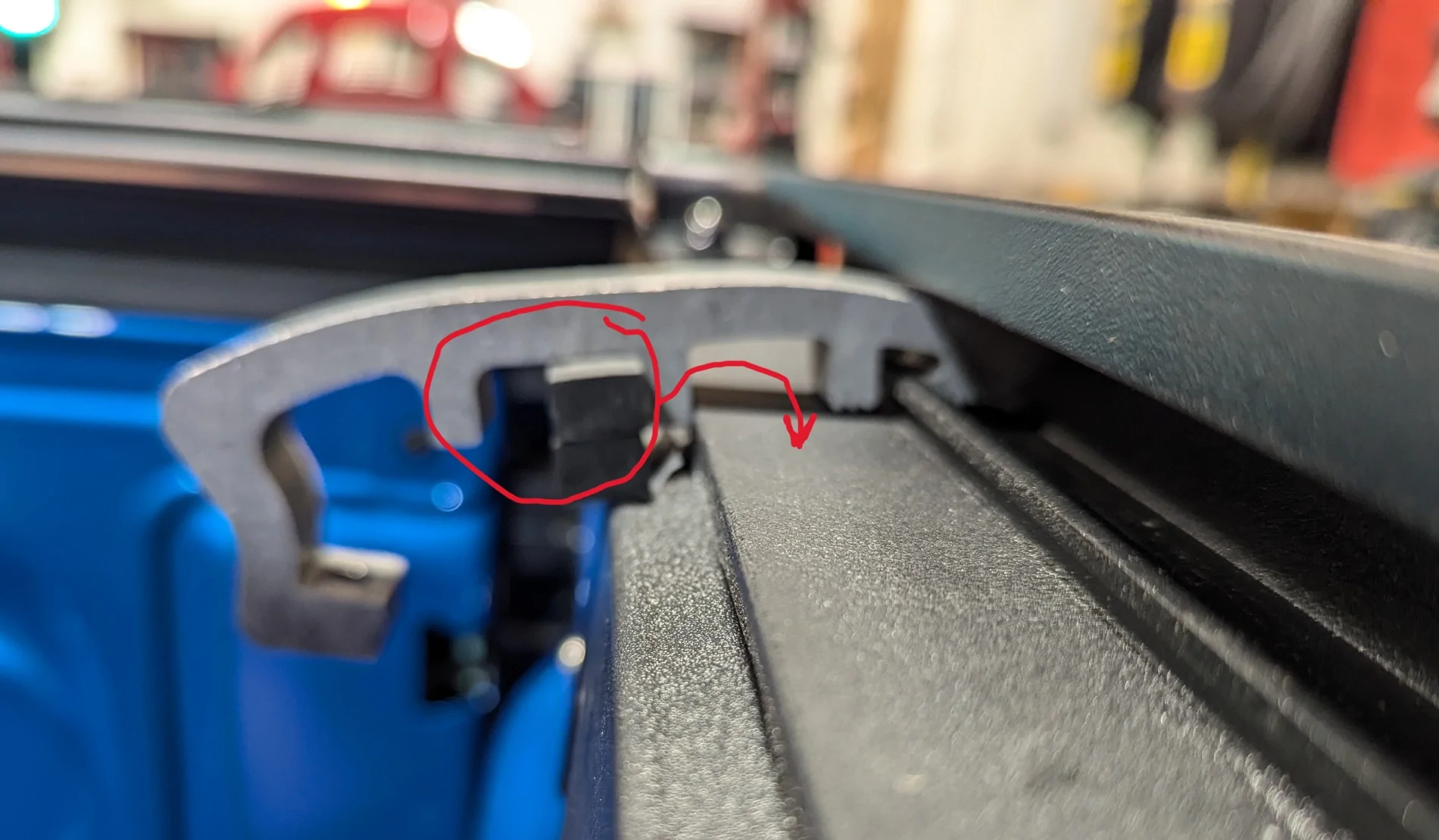

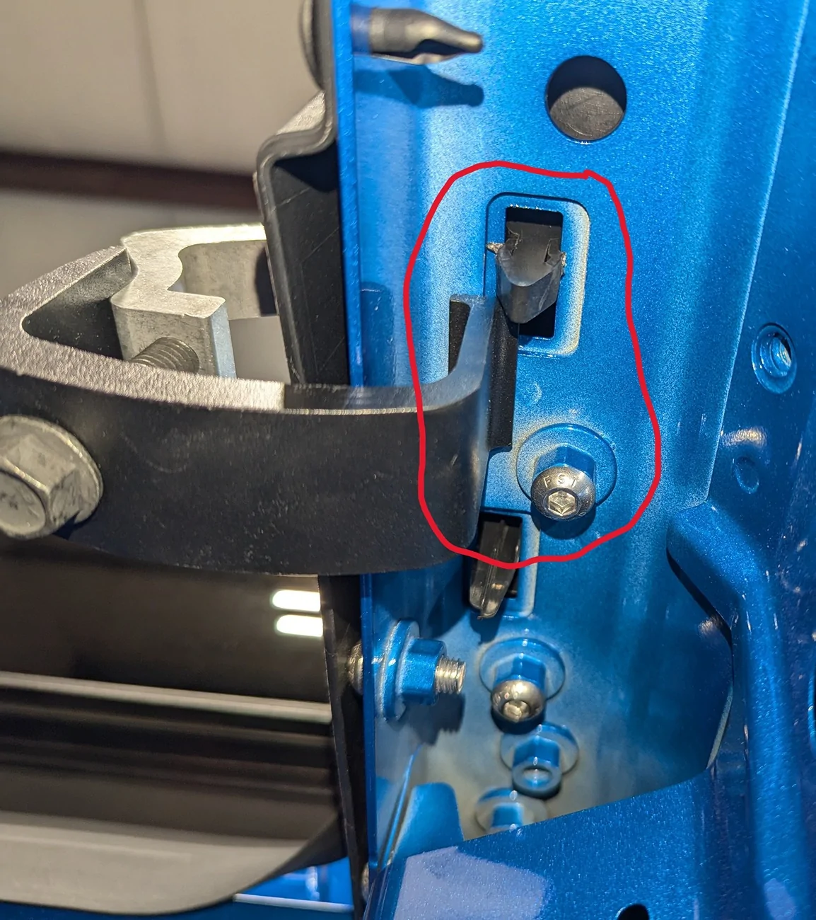

I have a Bestop SuperTop for Truck 2 (the version with interchangeable soft top and tonneau) from a 5G truck on my '24 XLT and I did a post on it here. I was able to make it fit, but the internal bed rail width is wider on our trucks than the 5G was which caused some clamping issues (also a weld nut was in the way of the "center" clamp).
Clamp area challenges
Circled area should be over the rail cap
So short answer, the 5G version is definitely not designed to fit our trucks but can. I've had my topper/tonneau on for over a year now without any issues (aside from water/dust ingress which is a problem in general on these trucks regardless of topper/tonneau).
Seems like this answers the question! Thank you...
